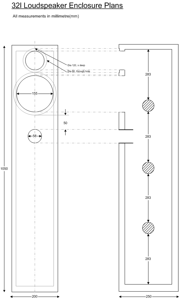

Thanks for the woofer reccomendations guys!!! With such good response on the 850467, I cant think of any other woofer but to take this 6.5".
diypole,
You're right, my room measures 3m x 3.8m or so and results in resonance around 90 to 110hz. These walls are plaster and wood which i think might affect the resonance even more.
I've tried very hard to model a bookshelf enclosure that can fit my desk without looking out of place or taking up too much space but in the end I gave up and designed floorstanders instead.
Here's my preliminary drawing. I spent quite some time fiddling with Visio to draw this out i might as well share it. The 3 round items in the side of the enclosure are 2" dowels meant to brace the enclosure. I'm not sure whether to flush the drivers against the baffle, it'd certainly look nice but I'm trying to keep costs low.
Currently the enclosure dimensions and port tuning are chosen with the help of WinISD. Its currently tuned to port 45hz. Resultant plot from WinISD shows these values:
110hz +0.1db
100hz +0.2db
90hz +0.3db
85hz +0.4db
80hz +0.5db and then a steeper curve all the way up to
50hz +2.4db and then steeply dropping
Cross referencing this against the woofer's frequency response would result in a gentler dip. I don't know much about speaker design but this looks to me like a winner!

Is this floorstanding design recommended? Its not flat but I really want a floorstanding speaker.
Does anybody knoes if four CSX 5.25" mid/bass ( 2 per box) would "do the job" for the bass section.
