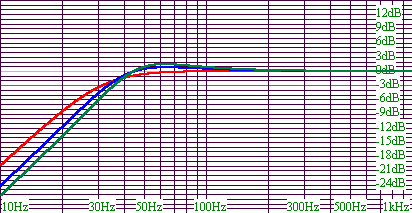

Below are the curves for 3 sealed boxes. These are shown without room gain, which is certain to be present and improve the bass output.
Red is 4 cu ft, Qtc = 0.7
Bue is 2 cu ft, Qtc = 0.9
Green is 1.5 cu ft, Qtc = 1.05
Although these days people are drifting toward Qtc = 0.5, the fact is that ever since the closed box was fully understood, engineers have aimed toward a Qtc that is between 0.7 and 1.0 cu ft. That was considered the high fidelity range,and most commercial loudspeakers are between those numbers.
Qtc = 1.05 can for all intents and purposes be considered Qtc = 1.0.
As you can see, the red line, (2 cu ft) and the green line (1.5 cu ft) give pretty good sub performance. As far as box size goes, I can only point this out: rmemeber the old AR's and Advents that most people had during the seventies? Well, those were 2 cu ft, and most people did not consider them obtrusive. So a box of 2 cu ft and below should fit into most people's listening space without too much trouble.
Of course, since the box is sealed and there is no supplementation from a port, the 5.5 mm linear travel might cut down on super high SPL in the very low ranges, but many might not notice that. And remember-there is considerable extra travel above the linear limit, but with increasing distortion. Your ability to hear distortion goes down in the bass range, however.
I would check to see the sensitivity of your KEF. If the sensitivity is within 2 dB or so, I would recommend picking these up if the price isn't so high. Then I would stick them in a 2 cu ft or 1.5 cu ft box. Unless you are looking for super high SPLs real low, I think they will make a nice subwoofer.
The smallest box will only be 6 dB down from midpoint at 30 dB,and remember, that will be without counting room gain.

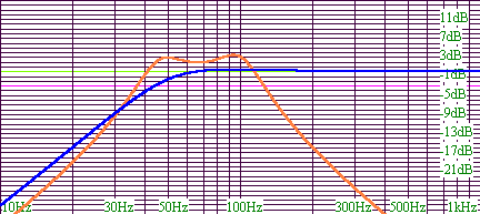

Bandpass?
Well, here is a 4 th order bandpass, (sealed on one side, ported on the other).Also, a sealed woofer. both are 2 cu ft, total.
The orange is the 4 th order bandpass. Back chamber is 1 cu ft, sealed. Front chamber is 1 cu ft, ported to 69 Hz.
The blue is 2 cu ft, sealed. Qtc = .9
As you can see, the output of the bandpass is higher, although down around 30 Hz the two tend to meet. However, the group delay-normally allied with distortion, will tell another story.

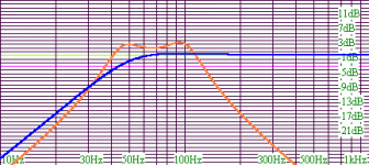

Here is the frequency response fo rthe bandpass and sealed:

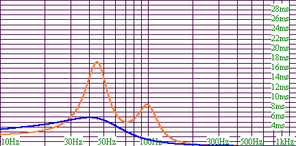

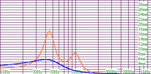

And here is the group delay for the two bandpass and sealed, again orange for bandpass and blue for 2 cu ft sealed. the bandpass is considerably higher throughout the range, getting quite high in places.
Group delay is associated with transient response and distortion. The lower the better.
However, if you are going to use this for Home Theater or movies, the group delay might not matter much. The sub will only be there for sound effects, after all, unless you are watching something where the music is important.
Low group delay is important for music.
Both boxes will have the same internal volume, 2 cu ft. for each.
