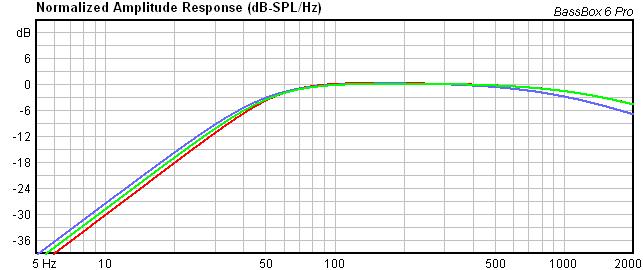

Here are the response plots.
Red plot 830668 in a 37 lit box with a Q of 0.764 and with no damping in the box.
Green is 830668 in a 48 liter box with Q of 0.709 and no damping.
Blue is the 850146 in a 37 liter box with a Q of 0.69 and no damping.
I think you can go ahead with the 830668 driver. It should be just as good with some minor changes in the box dimensions or the same 37 lit box filled with damping material.

I measured the Q of the 850149 in my 37 liter box. No absorbent . The box has a small hole for the speaker cable at the moment. So it isn't ideally sealed.
Fb = 50 Hz ( simulated 48 Hz)
Qc = 0.76 ( simulated 0.69 ). This should change a bit when the box is properly sealed .
I can also use an absorbent to reduce Q a bit.

Hi Terry,
Just saw your post. I'm in a rush and will check the results with some other programs also.
Note that the 850149 I have has been reasonably close to my simulation in Bass Box. We can also compare my measured t/s parameters with the published one .
Cheers.
Ashok.
I checked out the calculations again. You needn't worry.
It's just a matter of different parameters being used in the different software.
For example my calculations showed box losses Ql as 6.9 . How that figure appeared I do not know. However when changed to Ql=30 ( as you have ) the box size goes up to 66.3 liters.
Additionally if you include some absorption ( Qa=120 ?) the box size will come down. In my case I only have a choice of none, minimal , typical , heavy for absorbent. I can't input any numerical values.
So it appears you just need to get a box made and test the unit. You have my box size as a guide. 37 liters calculated and Q of 0.76 .
If I change Ql to 30 then the predicted Qc=0.743 in a 37 liter box!
I measured 0.76 in the box.
Yours is 66 liters ( for Qc=0.707) calculated in BB with Ql=30. So both programs are not far off.
Bass Box also predicts with Ql=30 and a box filled with absorbent you can get a Qc of around 0.7 in a 37 liter box.
So I guess you can pick any box size between 37 and 66 liters and tune it with absorbent to get 0.707 .
Try simulating with Ql=30 and plenty of absorption and check the box size in your program.
