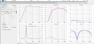

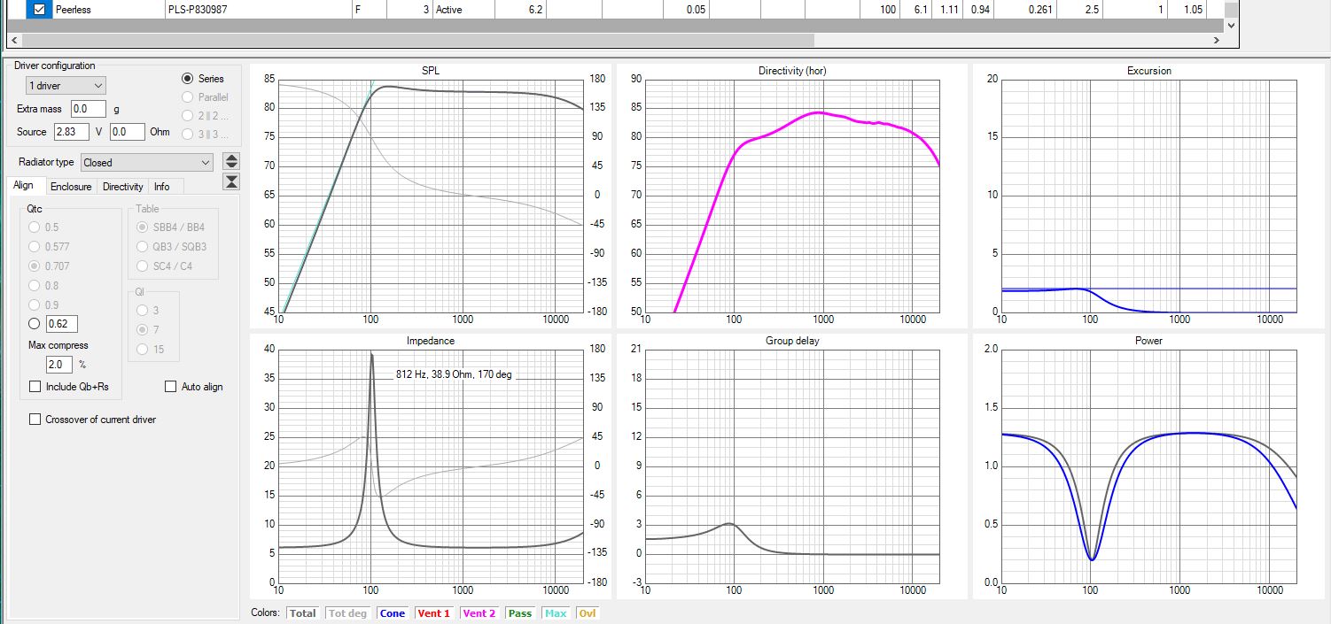

So looking at WinISD below, the blue trace is sealed, the red is tuned to 60Hz, and the green to 75Hz.
Ive chosen 22mm for port diameter, which should fit in the box ok for both examples.
Unibox gives me a similar shape:
would i notice this lumpy response? is it worth it to have a lower bass extension?
These will be used either side of a PC monitor at TV volume largely... perhaps a bit more when i'm in the office on my own.
Considering it's a pretty small driver, I'd probably be happy with sealed f3<100Hz, which is achieved here.
Such a high-Qt driver in a vented box will always be somewhat lumpy in low-frequency transfer function. In your case, the 150Hz hump is a sign that the enclosure is simply too small. The lower kneepoint is the vent's contribution, which can be smoothed out to a certain extent if you play with the various damping and leakage parameters (Ql, Qa, Qp), but it's then often a trial and error process to reproduce the exact effect in a real enclosure.

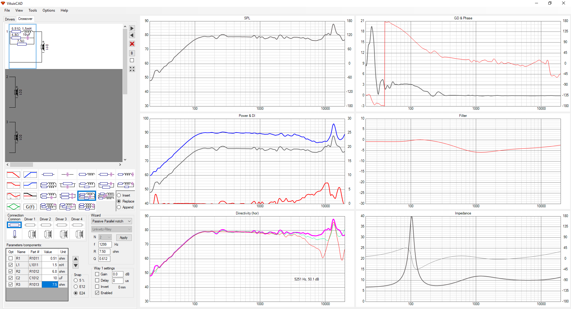

I did a simulation of the speaker in a 0.1Cft (2.8L) box with baffle step and diffraction. If you are close to a wall then it will fill the bass back in a bit. The baffles step more than compensates for the peak in the response in a 2.8L box. but it means the mid will be elevated reference the bass by approx. 5dB.
I will see if I can work out a simple correction filter.

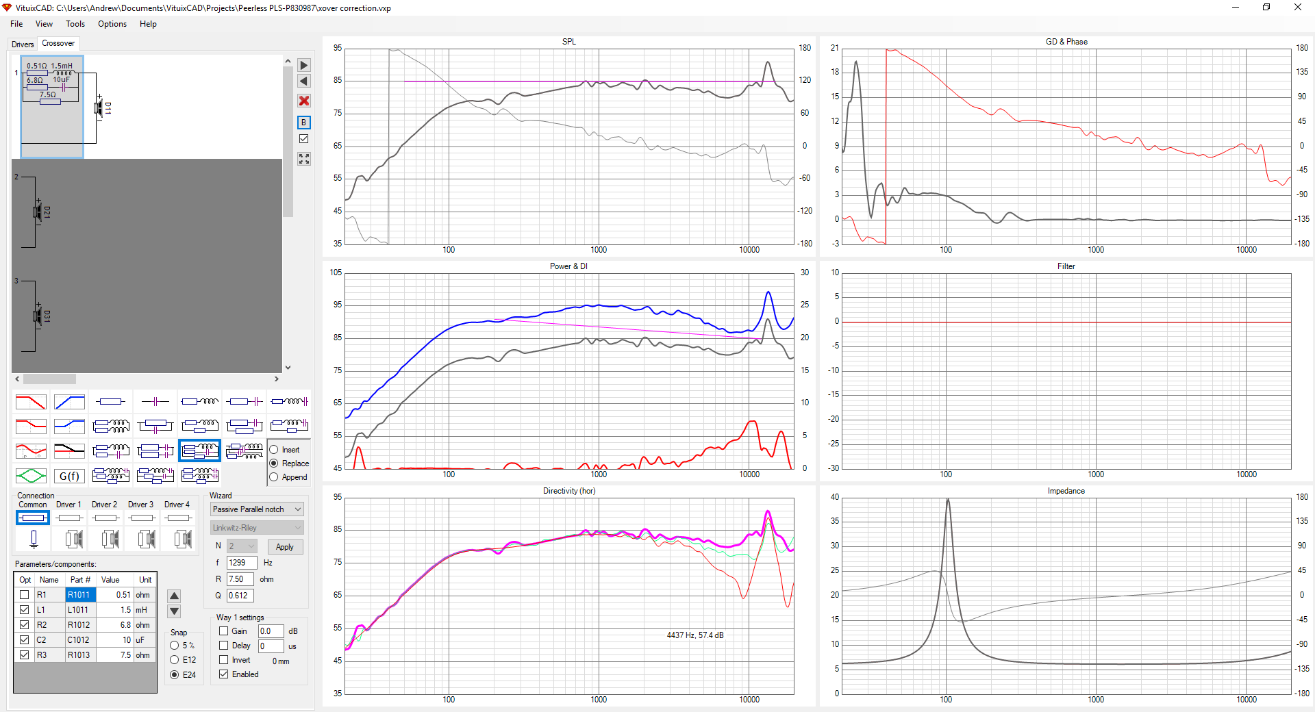

This is a fully compensated design if place close to a wall the bass might be a bit much.
I have taken the box and baffle simulation merged them with the responses from the data sheet to provide simulated in box measurements and then applied a correction network made up of a bass shelf with a resistive component to level if out followed by a capacitive resistive element to lift the response back up after the baffle diffraction hump.
Below are the uncorrected merged data, the filtered corrected response and the filter components.
