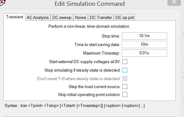

the thd for this circuit has been measured at 10KHz 10W as 0.002%, however my in my sims i get 0.03% 😕

Hi ctrlx,i tried b.c. and i.h. models but still get around 0.03%
Attached v4 sim with IH laterals giving 0.03% at 10W 10kHz.
And it gives 0.003% at 10W with 1kHz.
I think these THD sim figures are in the right ball-park for this topology.
Differences in models don't appear to make more than a factor of 2 difference in the 10kHz 10W THD. But there is a factor of 10 difference between measured and sim.
So, has anyone else (other than shaan) measured the v4 THD at 10kHz 10W 8R?
One thing to watch is the THD bandwidth. To get the first 10 harmonics with 10kHz (like our sims) you would need a sample rate of 196kHz or more.
