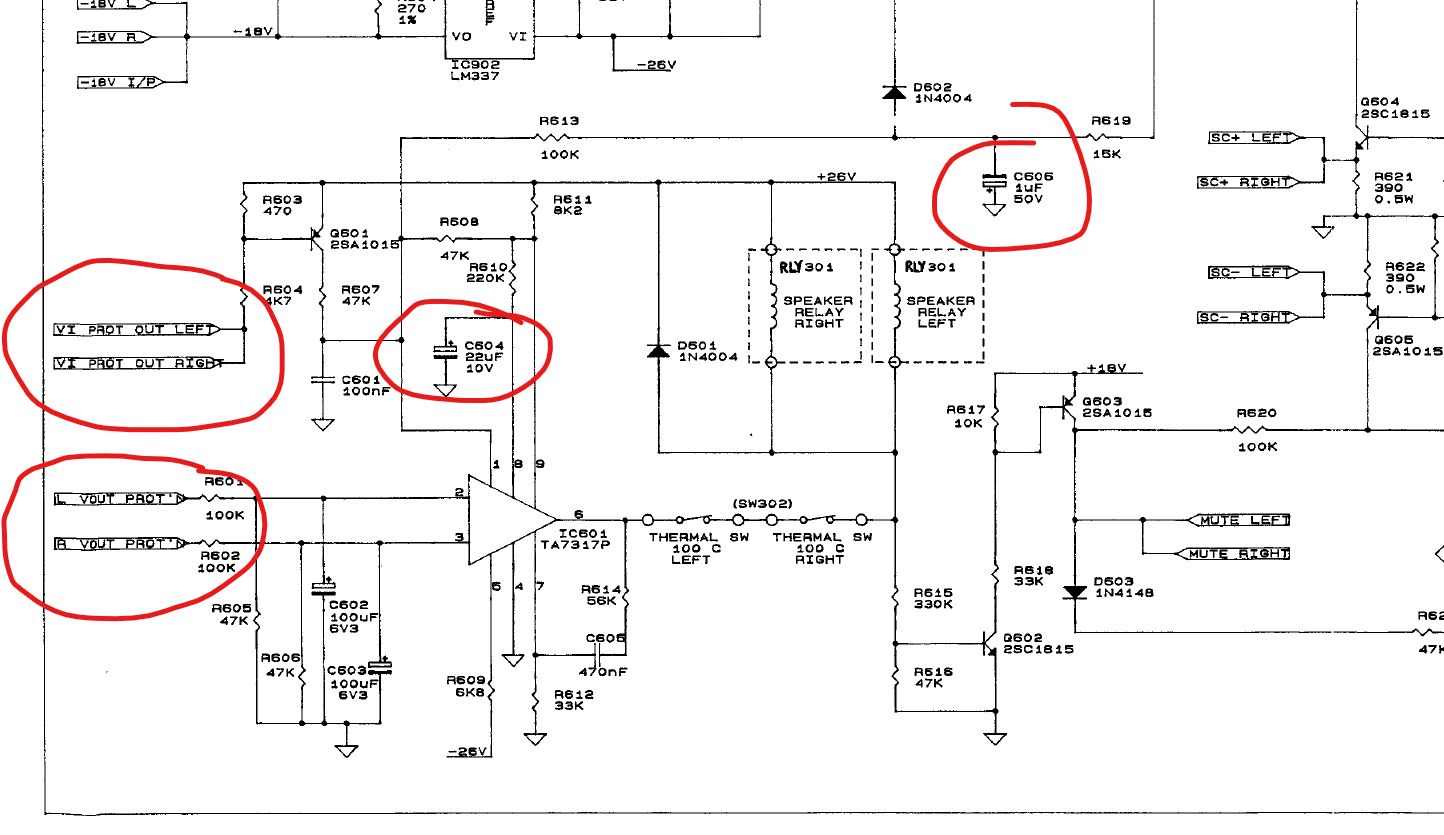

In the first post you mentioned 'distortion' but now you say it all works fine when the relay is engaged. I would concentrate just on the relay not engaging and what I would do is measure (during the time the relay is not engaged) the actual triggers to the protection circuit to see if anything is tripping it. There are numerous interwoven trips and triggers within the whole circuit but ultimately the relay is driven from IC601 and so that is where I would look, at all the inputs to the chip.
The four at the left are DC offset inputs and over current inputs. The two lower ones on the 100k resistor should be at close to zero volts. I think the other two will be 'floating' and so appear 'high' and if there is a trip condition they will go 'low' to zero volts but I recommend checking the status of these when it is working OK as that will be the normal status of them.
Also the two caps circled (particularly the small 1uF) could be favourite. C606 (which provides AC power detection)has a hard time and is exactly the type and location of a part that could fail/deteriorate. That is well worth just swapping before you do anything more complex. A 1uF 63v or 100v electrolytic would be fine and observe the polarity as + of the cap goes to ground.
The 220uF is the time delay setting component and might be worth swapping but its not the prime suspect here.

Hello Mooly, thanks for your earlier response. Apologies for the delay in my response. I wanted to get some things sorted out and gather as much info as possible before writing you a reply here. This way, you will have a clearer picture of what I am dealing with and how far we have progressed with this amp. At this moment, the amp is sent in for service. Kindly allow me to clear a few things below.
Referring to the 'distortion' that I mentioned in my original post, I should have been clear. I was trying to say that the amp working as it should after the relay clicked. In other words, when the amp's status lights go from red/amber to green, the amp works normally. It did not go into protection mode whilst in use at any time as well. What I did was plug the speakers into the integrated amp without the NAD power amp to see if this produced the same distortion. It did. So, it is clear that the distortion issue is being caused by damaged speaker cones and not from either of the amps.

Hey Mooly, glad to hear that the problem is within this particular circuit. I got an update from the tech who followed your guidance. The 1uf cap(C606) was desoldered and measured and seems to be within specs. The relay contacts are good as well. He suspects the IC601(TA7317P) to be causing the problem. More inspection is to follow this week. I have been searching for this part and it seems to be discontinued. Also, there seem to be counterfeits floating around online; some of the reputable part stockists don't seem to have them as well.
Caps fail in many ways and its normal for a failed cap to still read as correct in terms of its value.
A scope check would confirm if there is excess ripple on that cap but normally you would just replace anything like that to eliminate it once and for all tbh.

Hello Mooly. I got an update from the techs earlier today. The cap C604 220uf 10v cap gave a reading over specs—something like 290uf. The tech went on to check the values around the chip IC601, and they came out within specs.
So, is this indicative that this cap C604 has gone bad, or is it still within what most would call 'within tolerance'? I will process with your advice.

Tolerance on electrolytic caps is very wide, historically even +50% and -20% was acceptable. If these techs are knowledgeable then they should know all this 🙂 and also know that measuring capacitance values doesn't tell us much in a lot of cases.

If all the values around the chip really are correct then the output pin of the chip (which will be an 'open collector' output should go low and energise the relays. So this is where absolute accuracy in interpreting results comes in. If... IF all the conditions around the chip really are correct then the output pin should be at zero volts and the relays should close.
If that is not happening then you have to suspect the chip but that in reality is the last part to suspect normally... but if measurements have been to prove otherwise then you have to replace it.

@Mooly Sir, I got the unit back after weeks of testing. The only part replaced was the 220uf time delay cap, which you highlighted as the possible cause of this problem. The other cap measured within specs and was not changed. After replacement, it ran daily for 2 weeks(a couple of hours a day), and the OFF/ON procedure was simulated(a few times throughout the day) to establish consistency. Also, the amp was left over the weekend and switched ON on Monday to see if this non-usage for a couple of days caused the relay delay. This test showed no delay as well. I took possession of the unit earlier today, and it ran for a few hours. The relay 'clicks' within a second or two now. So far, so good. I will be monitoring how this goes.

That is good that it is fixed 🙂
The cap has no impact on the audio at all and it is used purely to set the relay delay times. Nichicon is a top brand (as is Rubycon)
No need to adjust anything, the only time you might adjust is when semiconductors have been replaced in the power amp section.
