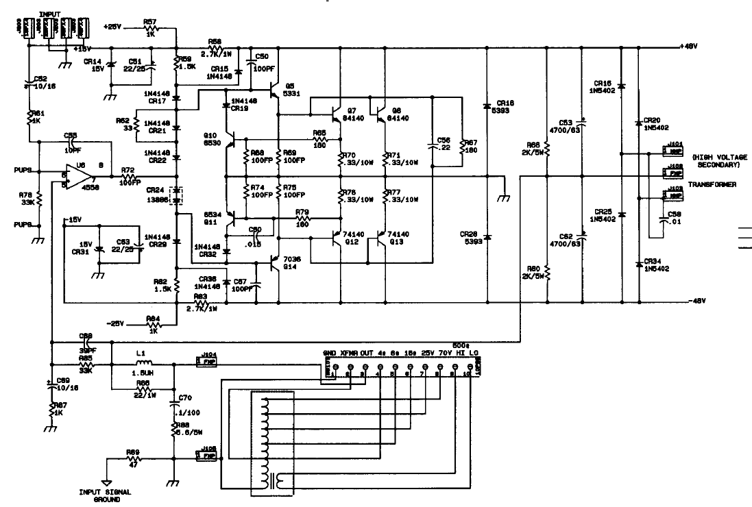

I don't have the schematic of the MMA-875T but I think the power amp is the same one used in the Peavey UMA75T. Both are 75W.
If so, the center of the psu caps is not 0V but the amp output. The output is similar to the QSC collector ground but in this case, it's emitter ground.
Take the 0V at the center of the two 0.33 ohm emitter resistors or simply the chassis. The opamp rails should then read about +- 18V.

Thanks, that does look similar. So the final op amp drives the TO-126 drivers through 100 ohms. the OT emitters drive the case ground and one side of the output transformer. The back side of the output transformer is connected to power transformer CT through a 1.8 mH coil. And in my unit through the contacts of the power up silence relay.
The two TO92 transistors are VI limiter.

..... and one side of the output transformer. The back side of the output transformer is connected to power transformer CT through a 1.8 mH coil.
If I am not mistaken, there should be two transformers inside. The Mains transformer is wired to the bridge rectifier, followed by the filter caps with the center between the two caps for the amp output.
This output goes through a 1.8uH//22 ohm 1W followed by a zobel network (0.1uF+5.6 ohms 5W).
After that, it goes into the output transformer, which is an autoformer.
For direct out (ie bypassing the autoformer), connect speaker red wire to PIN 3 and black wire to PIN 1 (MAINS GROUND).
To use the output transformer, jump wire from PIN 3 to PIN 2. This will activate the output transformer.
Once this is done, you can connect the speaker red wire to any one of the terminals of your choice (4 ohms, 8 ohms, 16 ohms, 25V or 75V line distributed system).

Mine has a "gnd" connected permantly to the case, and to the OT emitters through a connector & the thermal switch. On the same side is a "4 ohm" screw which goes to the CT of the power transformer and the center of the rail caps when the silence relay closes. I think you can run speakers from 4 ohm screw to GND screw.
the other terminal strip is "COM" , 8 ohm, 25 v , 70 v. COM screw doesn't connect to "GND" screw. From COM screw to 8 ohm screw is 1 ohm on my DVM, which I find suspicious. I'm going to put a 5 A fuse between 4 ohm screw and the output transformer. Pulling the fuse will allow me to see if music comes out that way, without the transformer shorting the output. The output transistors don't seem damaged, though.
I found the 74 ohms between OT base & emitter. R67 100 ohms ties the two OT bases together, and merges current into a network of 100 ohm resistors on the VI limiter circuit. Why would they do that? Bleed off half their base drive current? They only have 1/2 watt driver transistors; the amps I've worked on before have trouble getting enough base drive into the OT's to make them put out serious wattage.
This one has two tech initials on the mainboard, but the OT's are dated 95. Wonder what they replaced? Rail caps are IC (Illinois Cap) and 3 ohms ESR, so they are probably original (and doomed to the trash can this time). The unit is strangely clean, I would suspect it to be a first year warrenty failure except for the tech initials. Cleanliness is one reason I'm suspicious of the output transformer, steam cleaning might have killed it.

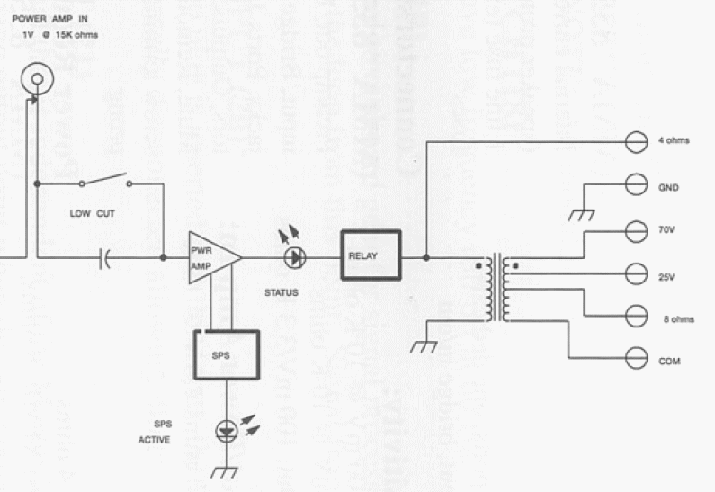

Sorry for the confusion. Apparently the output transformer in the MMA 875T is different from the UMA75.
With the MMA 875T, the amp output goes through a relay and to a 4 ohm direct out. For this, the connection is 4 ohms and GND.
The amp output is also connected to the primary side of a line matching transformer.
On the secondary side, you have COM, 8 OHMS, 25V and 70V. This side is FLOATING, that's why COM is not connected to GND.
A word of caution. If you use direct 4 ohm OUT, do not connect any speakers to the transformer out. It will blow the outputs. It's either direct 4 ohms out or transformer out but not both at once.
The conventional driver connection is the emitter resistors R69, R75 (100 ohms) both tied to the output.
R67 (180 ohms) ties the two driver emitters together. So, there are actually two biasing schemes at work.
These two biasing networks do not affect the VI limiting circuit. Over current is sense by 180 ohms (R65, R79) taken from the emitters of the output transistors.

Okay, thanks. Diagram post # 6 describes the situation I see on the table. I'll use one speaker, (3 element with crossover network) impedance 8 ohm, either on the 8 ohm tap to common, else on the 4 ohm to gnd screws. 17 vac will be loud enough in my music room. (half 35 v rails).

If you are using the amp "locally", not feeding faraway speakers, I suggest you disconnect output transformer, and use the direct output instead.
Not strictly necessary of course, but you remove one variable out of the equation and simplify your life.
That´s why manufacturers almost always provide for a jumper which can be installed or removed.

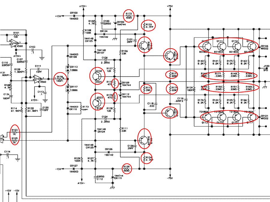

I'm not in town right now. It'll be easier for me to help you troubleshoot this amp after I fly back on Apr 13.
Meanwhile, I've attached a schematic of the PV-1200 that suffered a catastrophic failure. It took out all the parts circled in red.
It will give you an indication of the parts to look at.
Ouch!!! 😱Meanwhile, I've attached a schematic of the PV-1200 that suffered a catastrophic failure. It took out all the parts circled in red.
