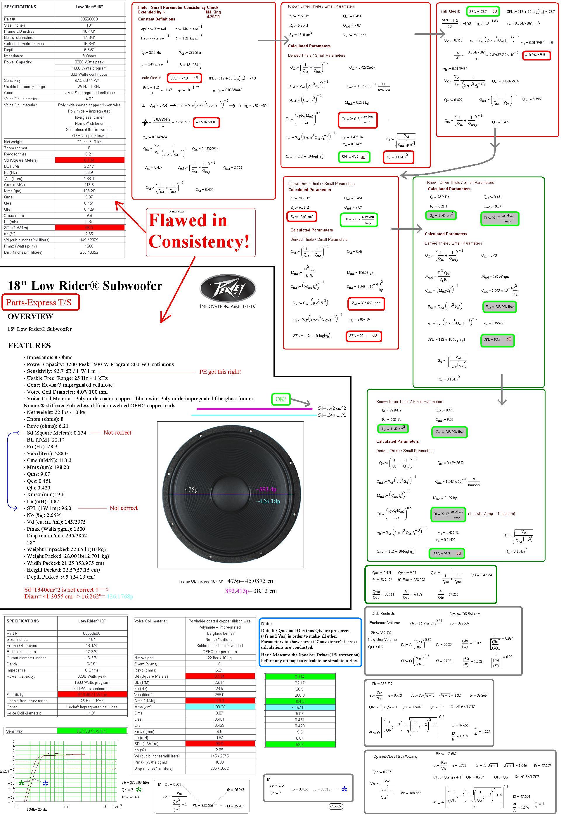

I had come across this some info about a few different versions of this Peavey, so I was very careful to use the parameters from Peavey and not Parts Express. However I still note that there are still some errors with the info on Peavey website. It looks like WinISD worked out Sd and SPL to be more like the corrected green numbers from your attachment, so that's good.
Thanks for the horn model too.

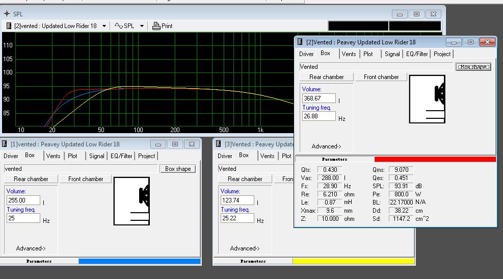

Any comments about these plots attached?
The Red line is a C4 alignment from WinISD, the Blue is what Peavey recommends, except that I changed the port frequency down just a little, and the yellow is what I find when I try the pi alignment (although now I need to double check that I used the correct specs when I worked that out)

Optimum enclosure size IMO is a box that will allow the driver to take it's full rated power, and my modeling suggests that is a 7cuft box tuned to about 35hz IIRC. Tuning lower with a larger enclosure reduces power handling significantly but there's nothing wrong with that if you don't need maximum SPL.
