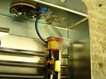

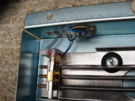

sometimes, reverb pans become mechanically sensitive and start to do what you describe. A replacement pan might fix that, assuming it's not a design issue. You could try silicone on the pan as well:
Often, the transducers get loose on the core at each end. These are like small transformer coils, which induce or detect magnetic waves through a laminated metal core. This causes the springs to vibrate and produce reverb.
Adding some RTV Silicone to the transducer and cores (to minimize vibration and stop the coils from moving around), can sometimes fix this. Make sure you DO NOT get silicone on the springs !! You only want to deal with the transducer coils themselves. I also like to add a dab of silicone to the wires at the shell too, which minimizes failures during transport.
Have fun.
Have fun.
Alright...thanks for the pics, those helped alot to understand your post...and that does appear like something I can try w/o getting in too much trouble...
