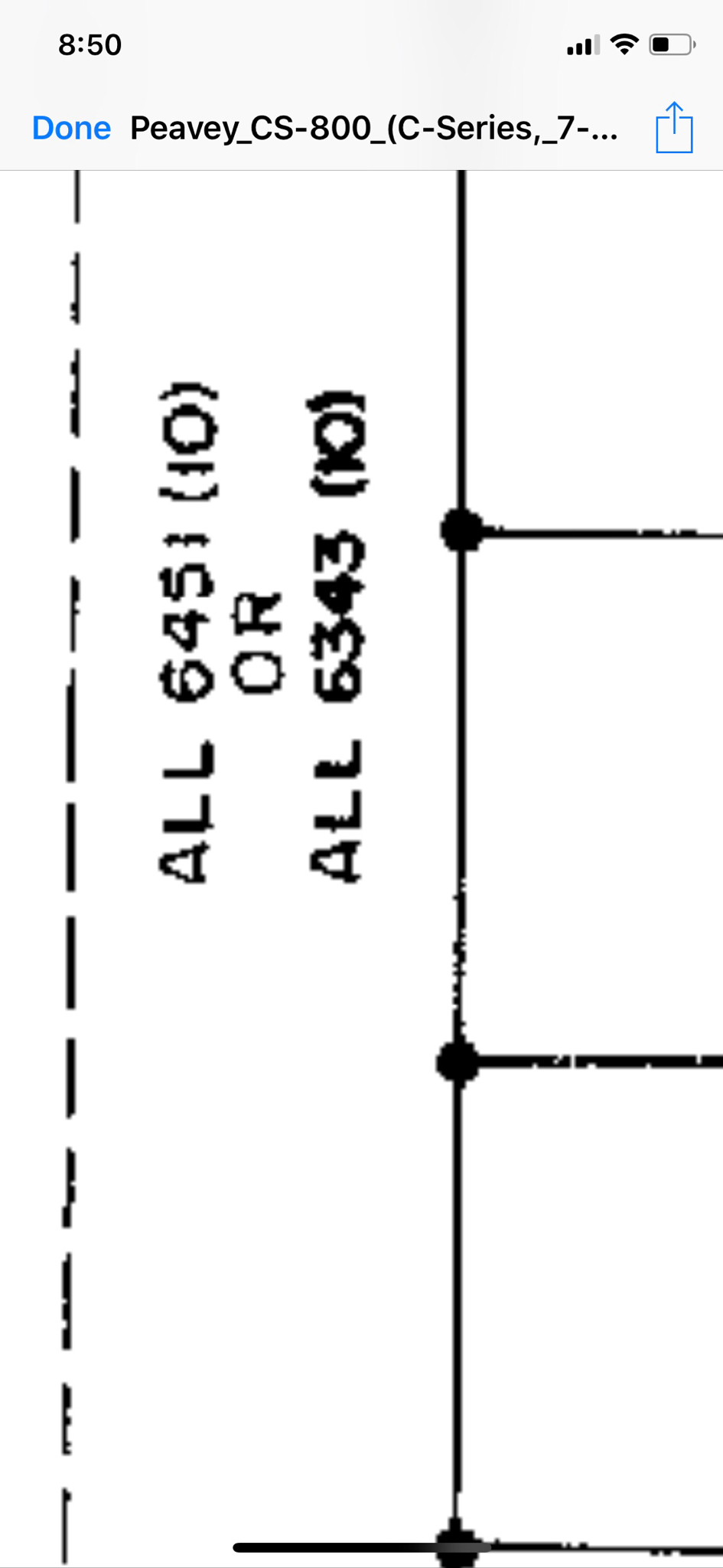

Please refer to attached schematic. Refer to Q5 (7205, pos pre-driver) and Q6 (7204, neg pre-driver). I would like to know what is the actual part number for this transistor, is it 2N, 2SC,2SD etc. Is there a replacement. Please assist.

I believe these are the TO-220 package. Peavey is subbing MJE15032 MJE15033 which are the toughest out there. I think in the nineties they were buying 2sa968b 2sc2238b but with the prevalence of fakes from ***** you are better off buying ON semi parts from farnell or RS (in the UK). Peavey had an incoming inspection department that could check for SOA and Ft of the ****ese parts, you don't.
With your incoming insp. department not sorting for gain or Vbe match, you may have to change R30 to eliminate cold crossover distortion. Look for vertical outputs on a scope at low wattage sine wave, decrease R30 with a pot until it disappears. Then replace pot with a fixed resistor.

Early BGW and others used TO5/TO39 with stud cup mounting as the need for thermal mounting on the VAS was needed. The TO202 still needed some extra heatsinking and it was not easy to mount to the heatsink directly. Later Motorola came out with MJE 340/350 and other devices that were easy to secure to the heatsink. We made the changes and better VAS reliability was greatly improved. I think that Jack did the same for Peavey.
