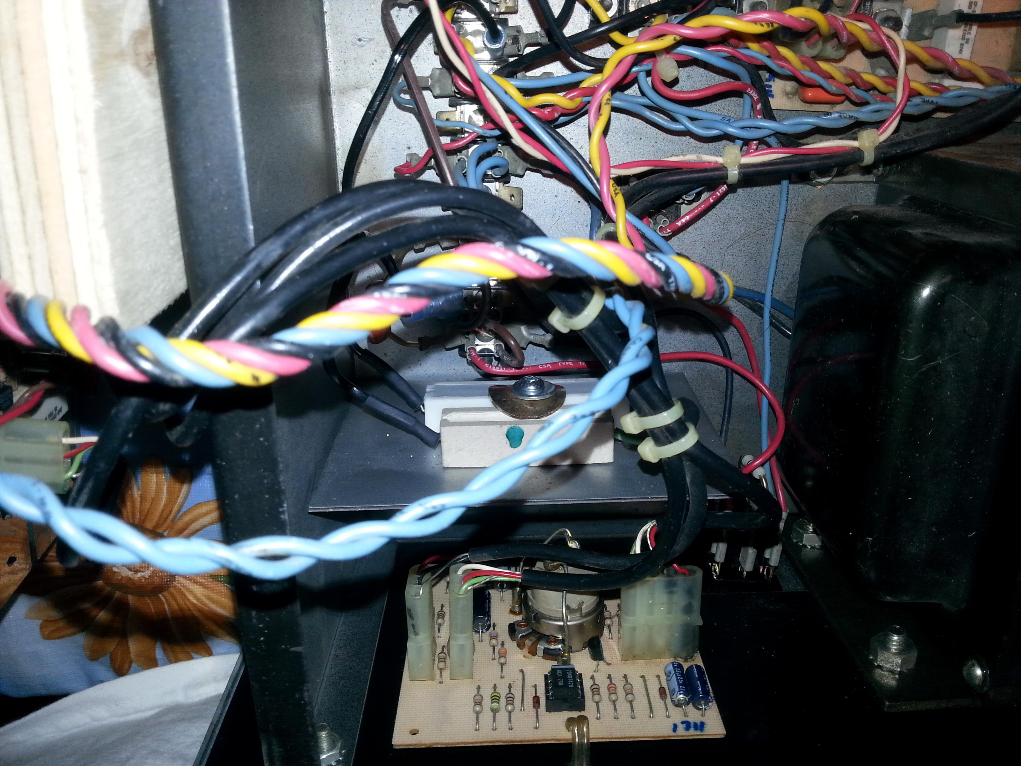

UPDATE
After some experimentation, an additional 500R/20W in series with the 250 ohm resistor already in there turned out to be just what was needed.
It dropped the RPMs and subsequently the noise level to barely a whisper and still managed to dissipate the heat while idling quite nicely.
I relocated both resistors to the metal plate behind the Channel A DDT circuit board. Not only are they mounted more securely but the plate serves a heat sink too.
I performed some final power tests into various loads (1khz into 6 ohms mono yielded 1003.62 watts 🙂 ) and the amp barely broke a sweat.
