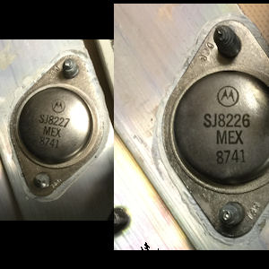

Need a couple of outputs for this Peavey amp. Any information or help would be appreciated.

Interesting, The schematic specifies 8306 and 8307, but I would have subbed them for the ones you showed anyway.
The 8226 is an NPN, and is a MJ15024 under the skin
The 8227 is a PNP, and is an MJ15025 under the skin.
Well to be honest, yours really cross to the less likely MJ15052 and MJ15053. The 8306 and 8307 are just a little larger specs, they will handle heavier currents.
You can order the house numbered parts right from Peavey at reasonable cost or order the generic MJ types from Mouser or whoever.
Peavey customer service will be happy to send you the schematic if you ask. I assume this is the power amp for some model, and if you ask for the schemos for that model, it should include the power amp.
If you ask them, they will also send you their semiconductor cross reference guide, which has the generic numbers for all the house numbers.
