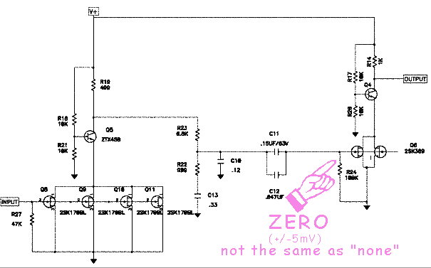

I am trying to diagnose a persistent but intermittent problem in the right channel that drops out. What should the voltage be between C11 and R24? I measure some voltage on the channel that works, but none whatsoever on the right channel. All the voltages on the test points in the Fig. 5 schematic are correct and moving upstream from C11 I also don't find any differences. The difference appears at C11 and R24. Thanks.

So according to your gif the point between C11 and R24 should be 0 +/- 5 mV, and that's what I have in both channels. The left channel that works fluctuates between .002 and .012 and the right channel is always .000. I thought that was a relevant difference, but I guess it isn't. I guess C11 might leak a little?
I wish I knew more about how to diagnose this. As I said, all the voltage points noted in figure 5 measure properly, and I also more or less randomly measure other points to see if I can find a difference. This is what puzzles me is that all the voltages seem fine in both channels from pad 1 to C9, and C9 is fine. There is continuity from input and output jacks to the board. Where or how else should I look?

You should do signal tracing with a scope when the problem happens.
Play an LP or test signal and follow the signal through the circuit from the input to the output.
The problem is located where the signal first goes away. The problem may or may not

My mV numbers are quesses. There is always some small gate current, which will make a small voltage in a large resistance.
If it is at DEAD Zero, you may have a Short. Solder-blob. Wire trimming. I once had a goofy PC, turned it over and beat it, metal swarf fell out of the card-clots.
Such a short will not noticeably affect other DC voltages but will short-out the signal.

Well, after poking around in it, I assembled it and now it works and it's been working for a while now.
