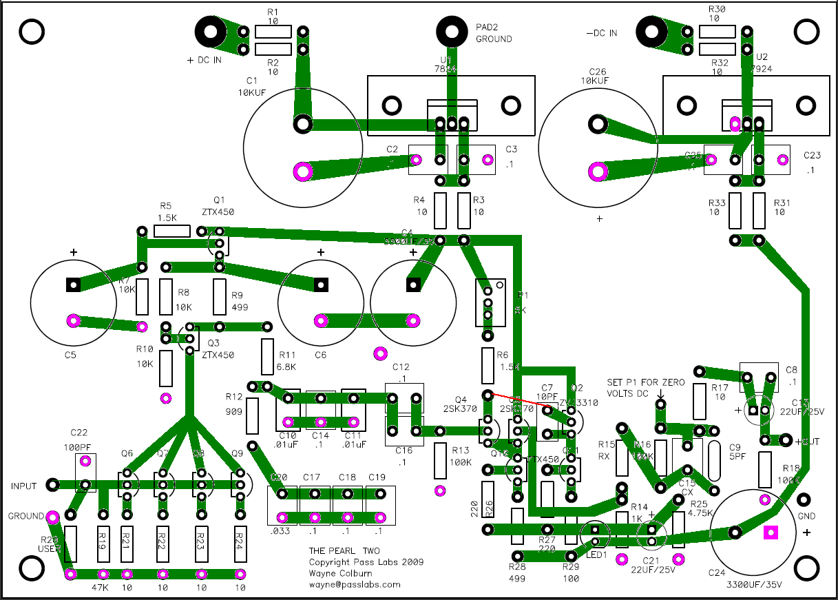

I have found no Linux program, that would be able to open the gerber files from passdiy.com. So, I would like to ask you to help me find image of Pearl phono PCB on net, or to give it here.

Yes Pearl2 works very fine.
Wayne sez: "The overall gain of the circuit as shown is 55 dB @ 1K Hz. Decreasing R14 from 1K to 300 Ohms gives 10 dB more gain when desired for lower output cartridges."
My version of PCB is one layer in general, but file "Pearl2_PCB_Przejscia_stron" shows exemption from that rule, bypasses on top layer. http://www.diyaudio.com/forums/atta...hono-pcb-image-pearl2_pcb_przejscia_stron.pdf

That's right.Thank, Pearl2_PCB.pdf and Pearl2_PCB_top.pdf are your version?
Do you have the actual Pearl 2 Gerber files, please?
