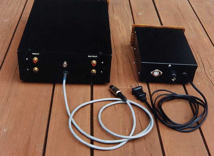

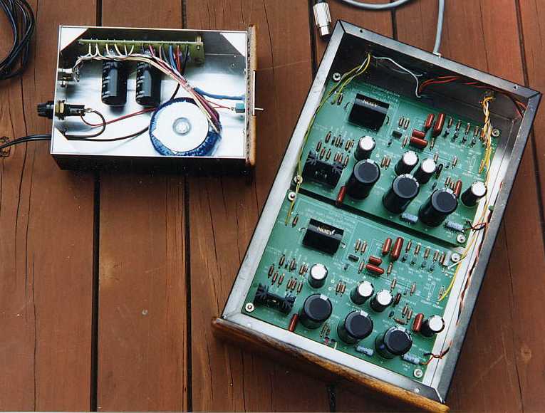

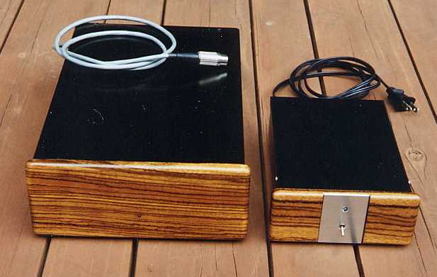

I used some "plain Potatoes" boxes as seen here, painted black and with a front panel added. I bought them from Mouser. The larger one is 8in.Wx12in.Dx3in.H. Fit is snug, but works. I didn't really like leading the connections from the one channel past the electronics for the other to the back, but it worked ok. Now that it's done, I'm pleased with how it turned out.
For the umbilical I used a DIN connector. I think I used 5 pin; one unused. They're very inexpensive. A couple of dollars for both parts. Looks professional (the connector, that is) and works fine.
Kimber 4TC speaker cable (8 wires) makes a nice umbilical cord. I tested it in my gainclone and it sounds very good with extended and detailed top end without coloration added by some lesser wires (like silver plated copper in teflon jacket that I also tried). Some may doubt it, but umbilical cord from reg PS has an influence on the sound of your preamp.

Nice looking work. Where did you get those decals for "input" and "output"? I think I've seen something like that at Radio Shack, but never pursued it. Did you just print them yourself onto adhesive backed transparencies?
