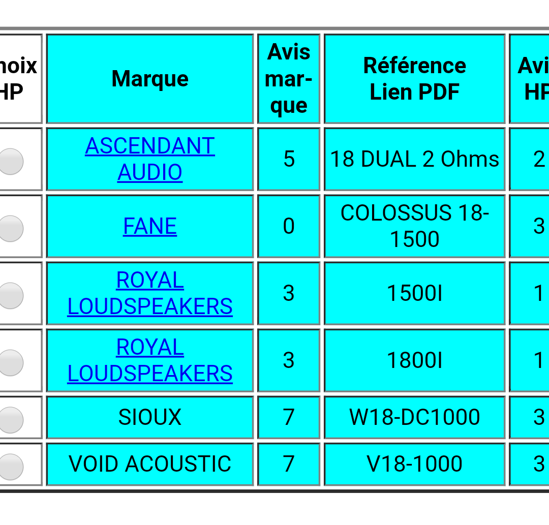

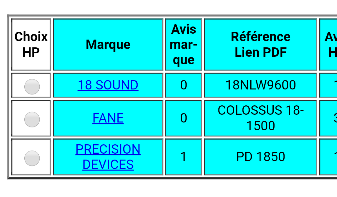

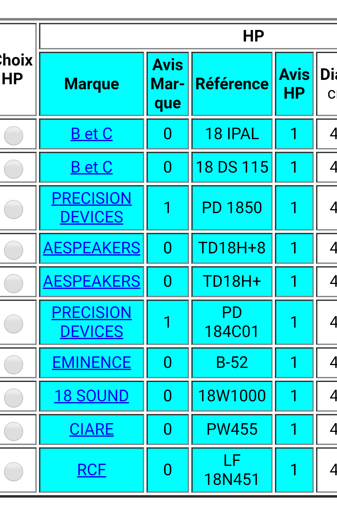

This is an "over the board" similar from a Database. Doesn't mean they work 4U. Each solution must be checked by someone that understands sims. This is a first approach and there might be others not in this Database or from recent years or new.
Agreed, best to sim but the top end B&C stuff is usually horn/scoop friendly. IE 18SW115. I am sure someone here would sim if you fetch the data/links to it.
Curious what database this is from
Based on T/S-parameter similarity I would look at these two:
B&C 18DS115 is a lightweight very high power 18" woofer for speaker subwoofer systems. B&C 18DS115 Speakers - B&C 18" 18DS115 extreme power speaker for speaker subwoofer systems. B&C 18DS115 extreme high power speakers available now. and B&C 18NBX100 is a lightweight very high power 18" woofer for speaker subwoofer systems. B&C 18NBX100 Speakers - B&C 18" 18NBX100 high power speaker for speaker subwoofer systems. B&C 18NBX100 high power speakers available now.

The T/S parameters are quite different but it has a powerful motor so this driver could work, try simulating it?

Petoin Dominique French Database.Curious what database this is from
