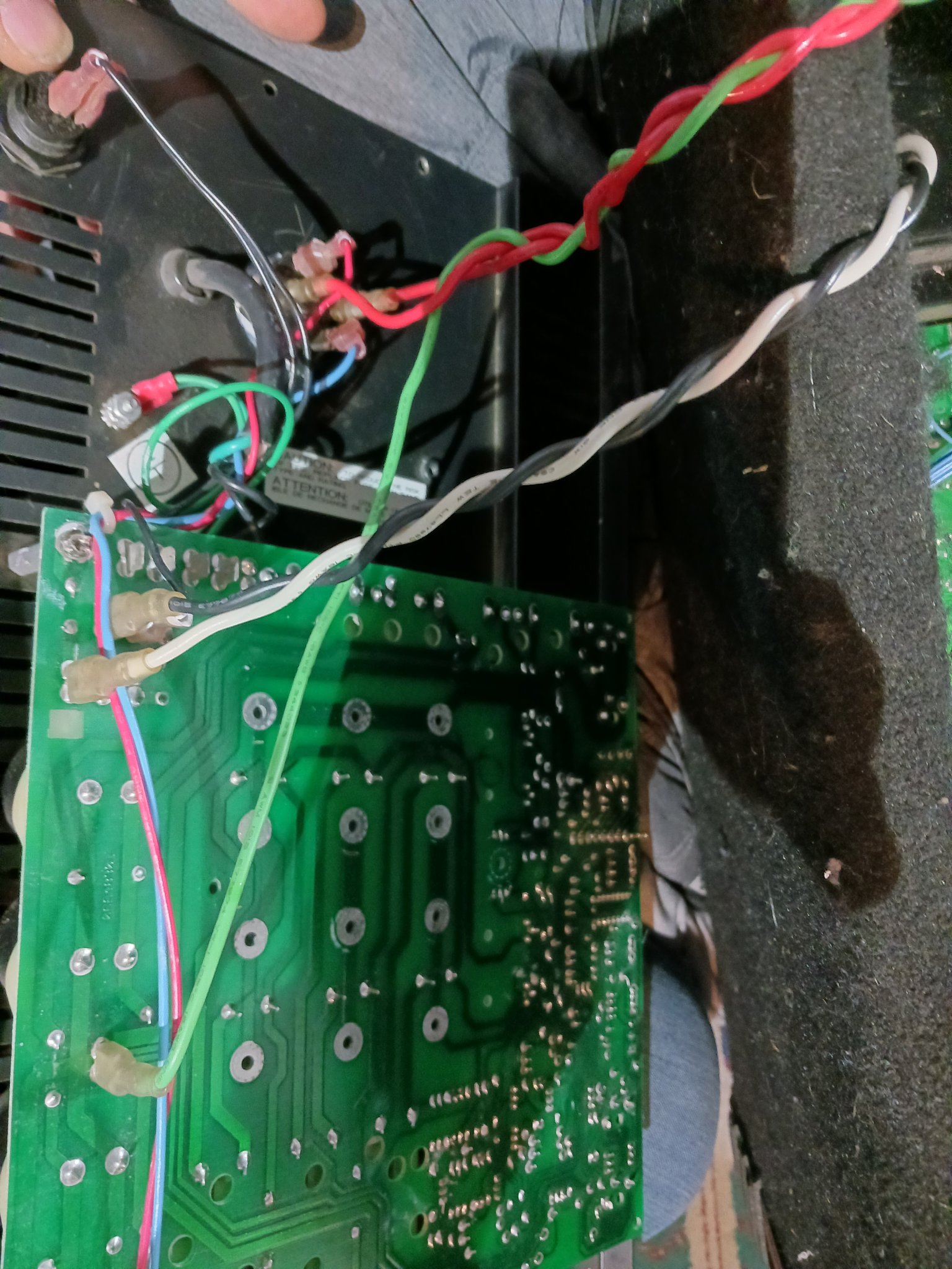

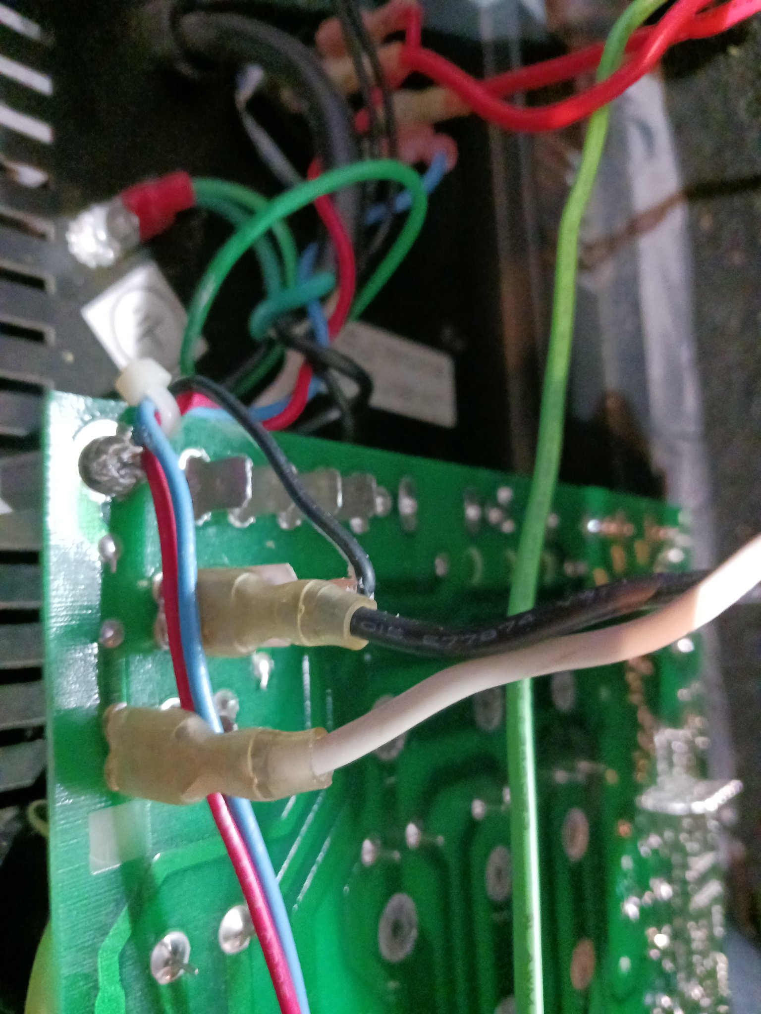

I'm in the same boat kinda I took apart my pcm8-d didn't take a picture like a mmm hmm I would had been ok but I didn't finish in the same day I had to take all the low 2s out they were bent beyond fixing I paid my friend to hook the power wire back up he didn't screw it back together so when I got it home out iy came and yeah unhooked it all over again lol got to lough I will post some picks if some can tell me we're to put things I can mange that's can't read the paper on here wish I could thanks
Tony
Tony
I know it's wrong I thought I had it but I put it back together and the green power light turned red oops i don't think fried anythingI'm in the same boat kinda I took apart my pcm8-d didn't take a picture like a mmm hmm I would had been ok but I didn't finish in the same day I had to take all the low 2s out they were bent beyond fixing I paid my friend to hook the power wire back up he didn't screw it back together so when I got it home out iy came and yeah unhooked it all over again lol got to lough I will post some picks if some can tell me we're to put things I can mange that's can't read the paper on here wish I could thanks

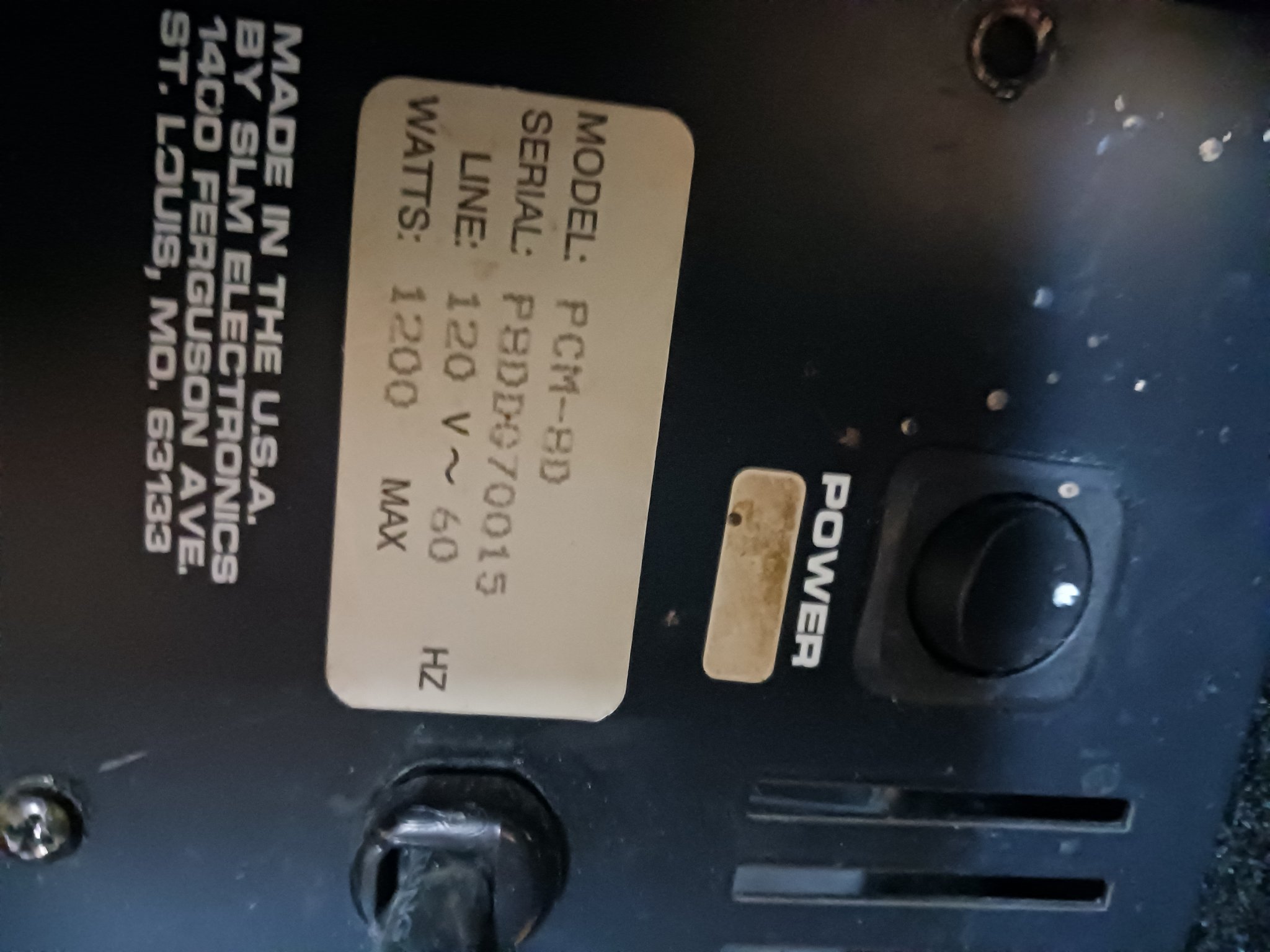

It should be 1200 watts 2 and 4 ohmDoes anyone have the answer to these questions...
I have the Crate Pro Audio PCM-8 DP+
It has 2 amps. What are the watts? Is it 300w per amp or is the 300w split between the two amps?
Will it be enough power to send to 4 speakers on 100 ft. cables?
Thanks in advance!
