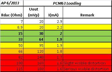

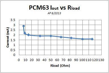

Well, with the LL1636 attached (no secundary load), I varied the Prim resistor values at the DAC side and measured the peak-voltage at the DAC-output with a scope.
It appears that the DAC current source has it's stable region with a load of 15...50 Ohms

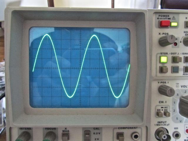

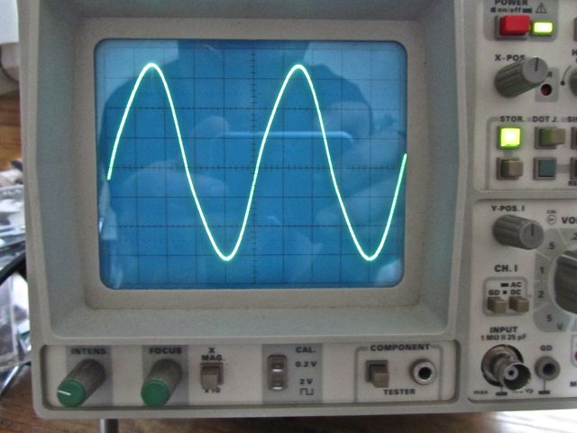

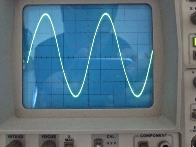

20Hz Different loads, signal behind the I/V transformer. Sine signal distorts at high Rdac (68 Ohm).
This is either caused by the current source of the DAC, not having enough internal voltage to provide sufficient current....or the higher voltage of the input I/V transformer when using the higher Rload causes the transformer to saturate (?No?). Could be verified with a CD having 20Hz signal at 0dB, -10dB, -20dB, -30dB etc...

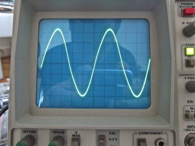

The 68 Ohm load causes a clear deformation of the signal:

Did that, even THD was the same..
Did you connect the primary between pin 6 and ground, or between 6 and 4? Or thorugh a capacitor?
If you don't take care of the DC-offset then that will saturate your transformer.

Measuring without the transformer...the signal will be too low.
I expect that what I see is the transformer as load and the DAC-output can not handle it with high Rdac....so not the actual transforming function causing this....
With a low Rdac it seems the DAC will "see" less induction in total
But still....when loading a DAC with a transformer and Rdac...this is likely the effect you will encounter

That's a VERY high value. Would be interested how the sine signal at 20Hz 0dB looks (or measures on THD)...got any data on this?
I would expect that the DAC output sees more of the inductive part as load (which is the case with a high value resistor) and if the current source in the DAC can not keep the current steady enough during the long stretch in a low F signal, there will be generated a voltage in the coil that "fights" the drive-current change of the DAC (V = - L (dI/dt), if dI/dt changes the fight begin...no? )....and That's what I think I saw in the deformed wave shapes.
