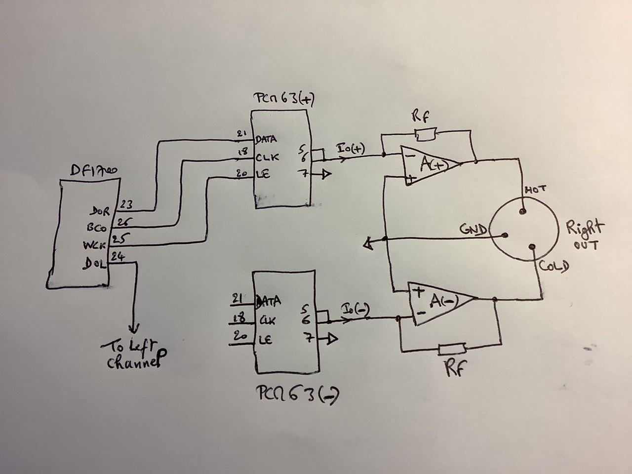

I have several units of PCM63 circuits from Burr-Brown and would like to use them to make a True-Balanced DAC, using 2 DAC chips per channel.
Can anyone advise how to connect the negative section DAC (Cold Signal) to the Digital Filter?
See attached simplified schematics.
