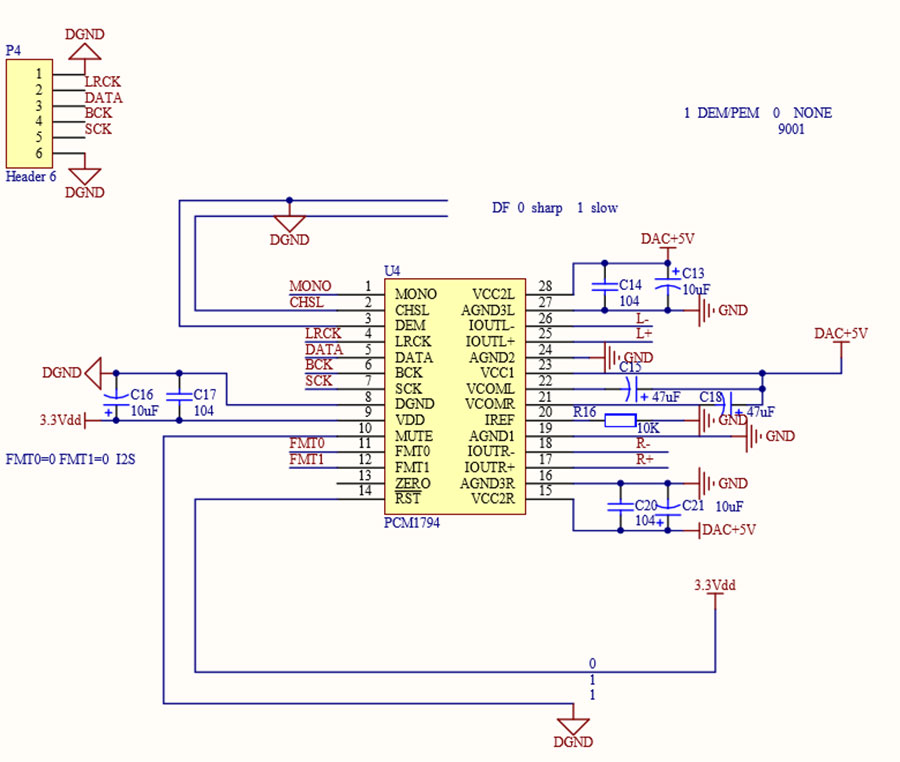

Tested one of the PCM1794 boards with the PCM2706 today with CHSL - 0, Mono - 0, FMT1 - 0, FMT0 -0.
So stereo I2S.

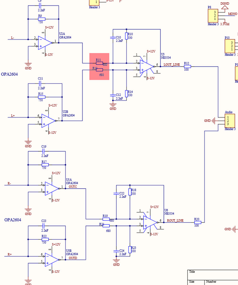

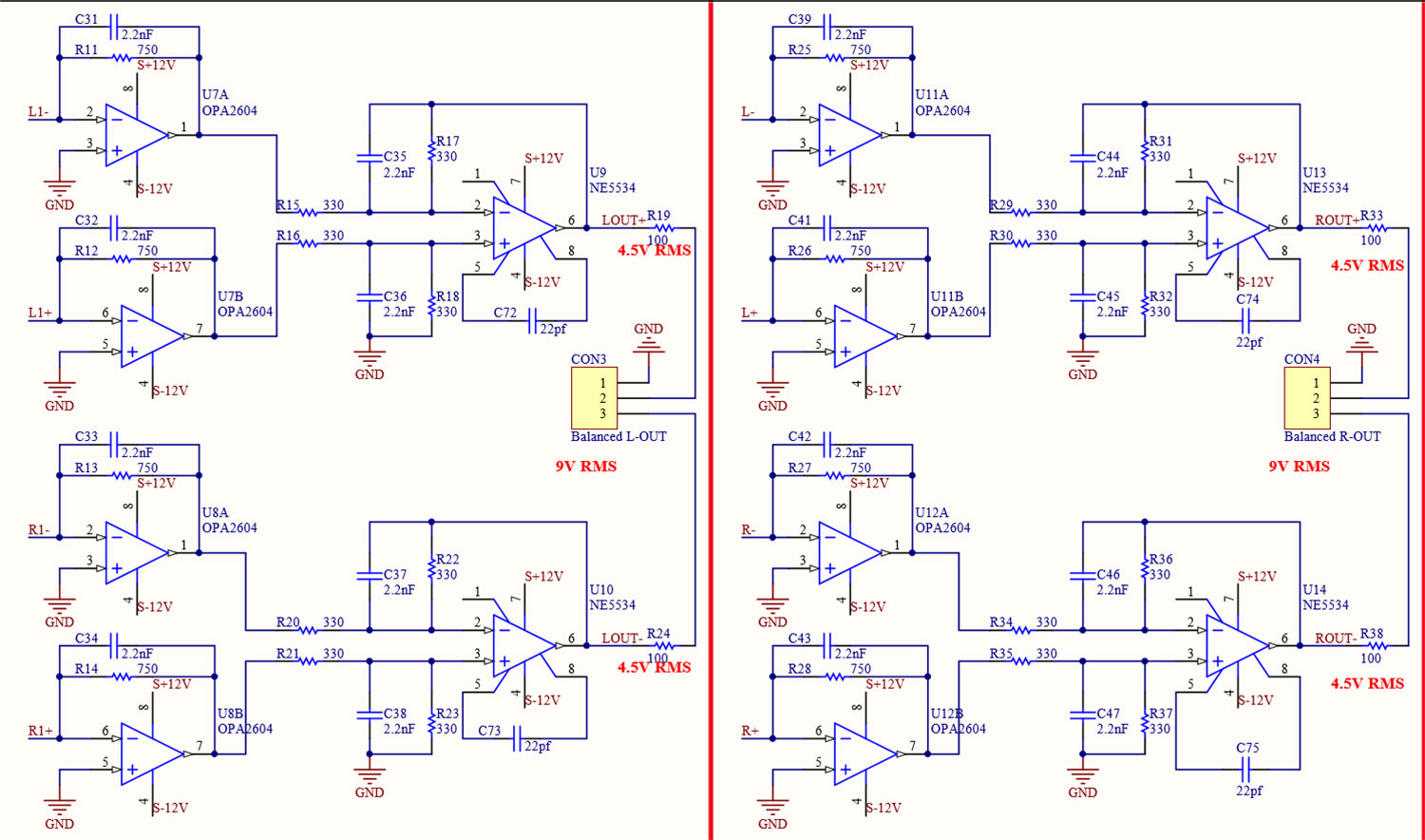

I have the stereo board (two of them), but found a schematic from the same designer for a dual board as well.
I had to take screenshoots of the schematic as it's a PDF.
I desoldered the 680R and replaced them with 330R as per the dual schem.
I also put 22pF on the single opamps according to the dual PCM1794 schem.

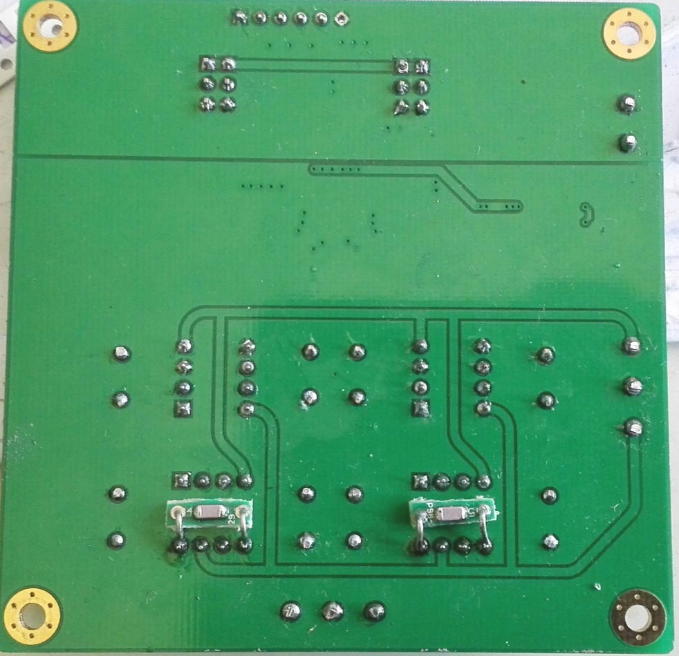

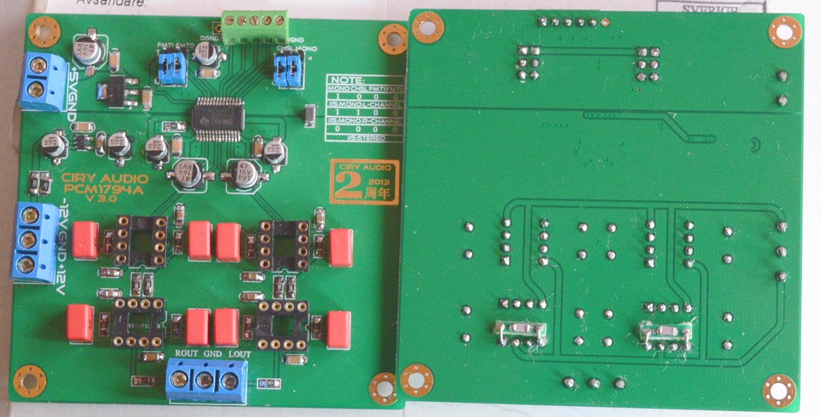

I tested with all jumpers set to 0 on the the PCM1794 board (I²S).
WM8804 board jumpered: sdout: 1 gpo0: 0.
Again, I²S (24bit).
Is a NOS PCM1794 capable of 24bit I²S?
