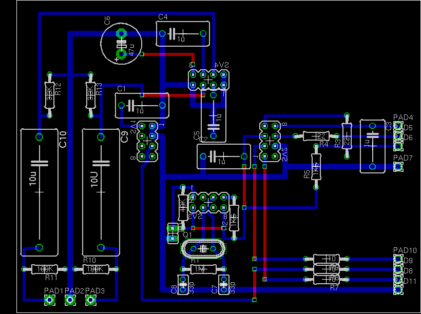

Schematics and layout.
For the pcm2707 i used an adapter from TQFP-32 to four 8-pin 0.1 spaced sockets as you can see from the image.
The layout has been only used as an aid to mount the components on a protoboard with blu wires soldered bottom an red ones top, and so is unusable to do a real pcb, for this purpose i am thinking to design a good layout and send it to olimex or others that make this kind of service. I appreciate any kind of suggestion for this.
