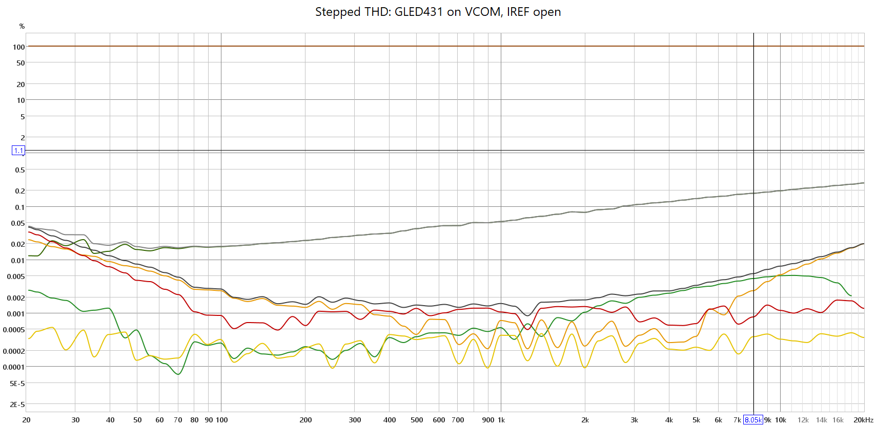

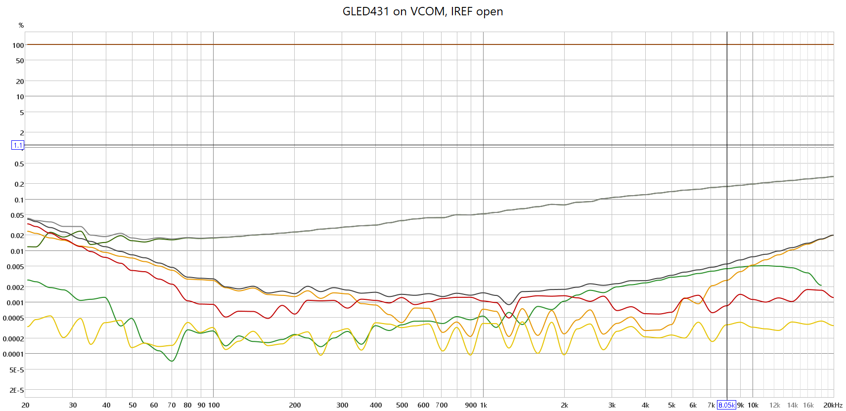

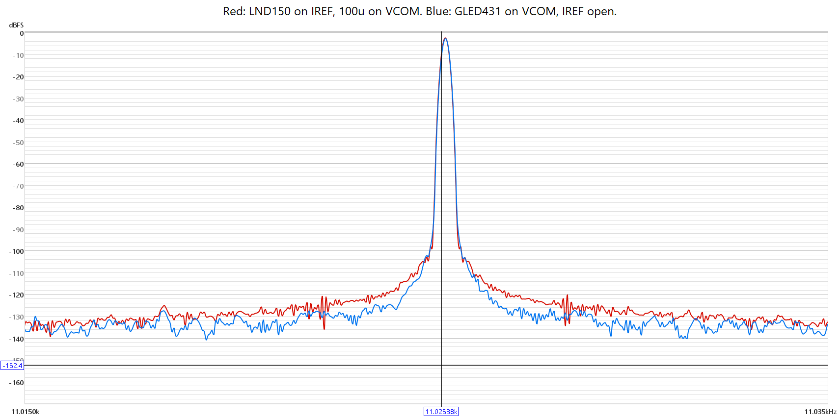

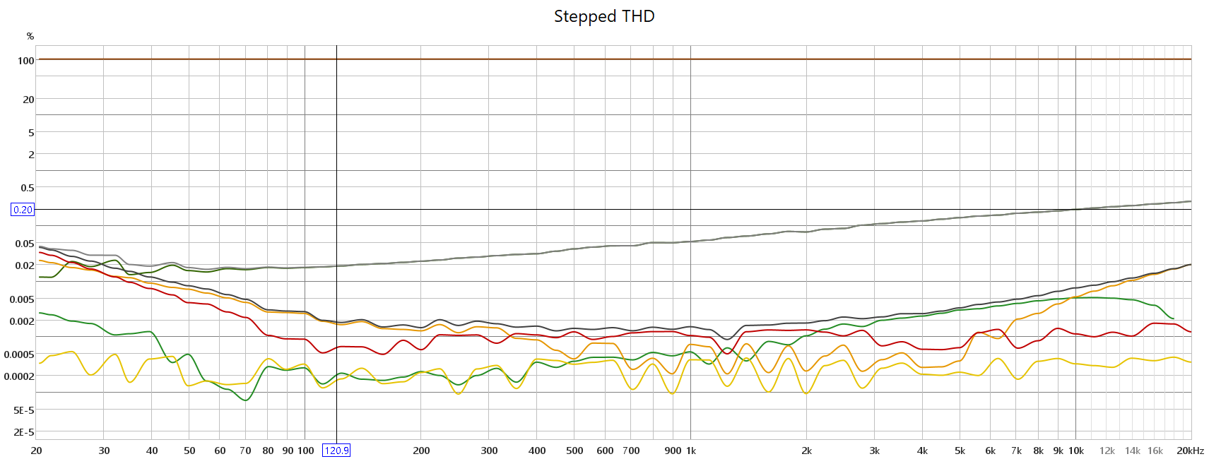

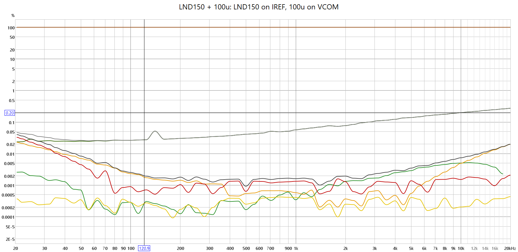

Well, I tried it.
I tried to replicate @bohrok2610's measurement methodology from the DS phase noise thread. My measurements look pretty awful by comparison, so please take with a good dose of salt. The red trace is a fairly standard CCS on IREF implementation with 100u from VCOM to VCC. Blue is with a GLED431 in lieu of the cap, and the IREF pin left open. The CCS current was adjusted with a trimpot such that the voltage from VCOM to VCC was constant between the two tests.
THD is also really quite close. There is a modest reduction in noise below 100Hz. The rise in THD below 100Hz is likely from the I/V stage, which is transformer-coupled.
