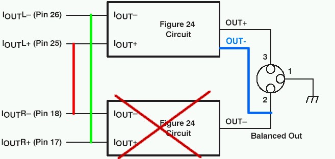

I need help on connection of PCM1798 in mono mode.
PCM1798
I would like to use one chip/channel, but there are four outputs in one chip (L-, L+, R-, R+)
How should I connect them to have only one - and + output?
Is it ok on this way?
L+ and R- -> +out
L- and R+ -> -out
It is like paralel the DAC stages.
Thanks for your help!

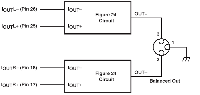

I saw it, but I want to use discrete I/V stage (D1), and not opamp stage.
D1 has only one - and + input.
Do I have to biuld 2 of them?
I am not sure.
I am not sure.
Think you will have to build two D1 stages including 16 pcs. of IRF610/IRF510, and use some kind of discrete-builded OP-amp to make the signals from each one "non-balanced", and then the sum on theese outputs will be balanced (again) ?!

mpopovics said:I was thinking in something like that.
Could it be work?
Because in mono mode L and R inverted:
L- and R+ same
L+ and R- same
Is it correct?
Is the output current is higher also?
I think this is a GREAT question.
You have come to the same conclusion as I have. Be ware though that such current output devices (I have not evaluated your device) will have a standing current into the device which will go away in the subsequent diff-amp.
You also need to change the values of the resistors for the output amp unless you want double output swing. If you do so, remember that the rollof frequency is also affected by such change of resistors.
Please let me know your results.
Petter
The solution
I have asked TI directly, to get information.
They forwarded the question into Japan, to development dept.
Finally, after 2 weeks I got this answer:
"Dear Mr. Popovics,
please find the answer from our Japanese experts below:
"For two I/V amp circuit ( DF bypass, mono )
Connect IoutL- and IoutR+ -> I/V
Connect IoutL+ and IoutR- -> I/V
For four I/V amp circuit ( DF bypass, mono )
Shown in Figure-25, data sheet"
Please let me know if you have any further questions."
