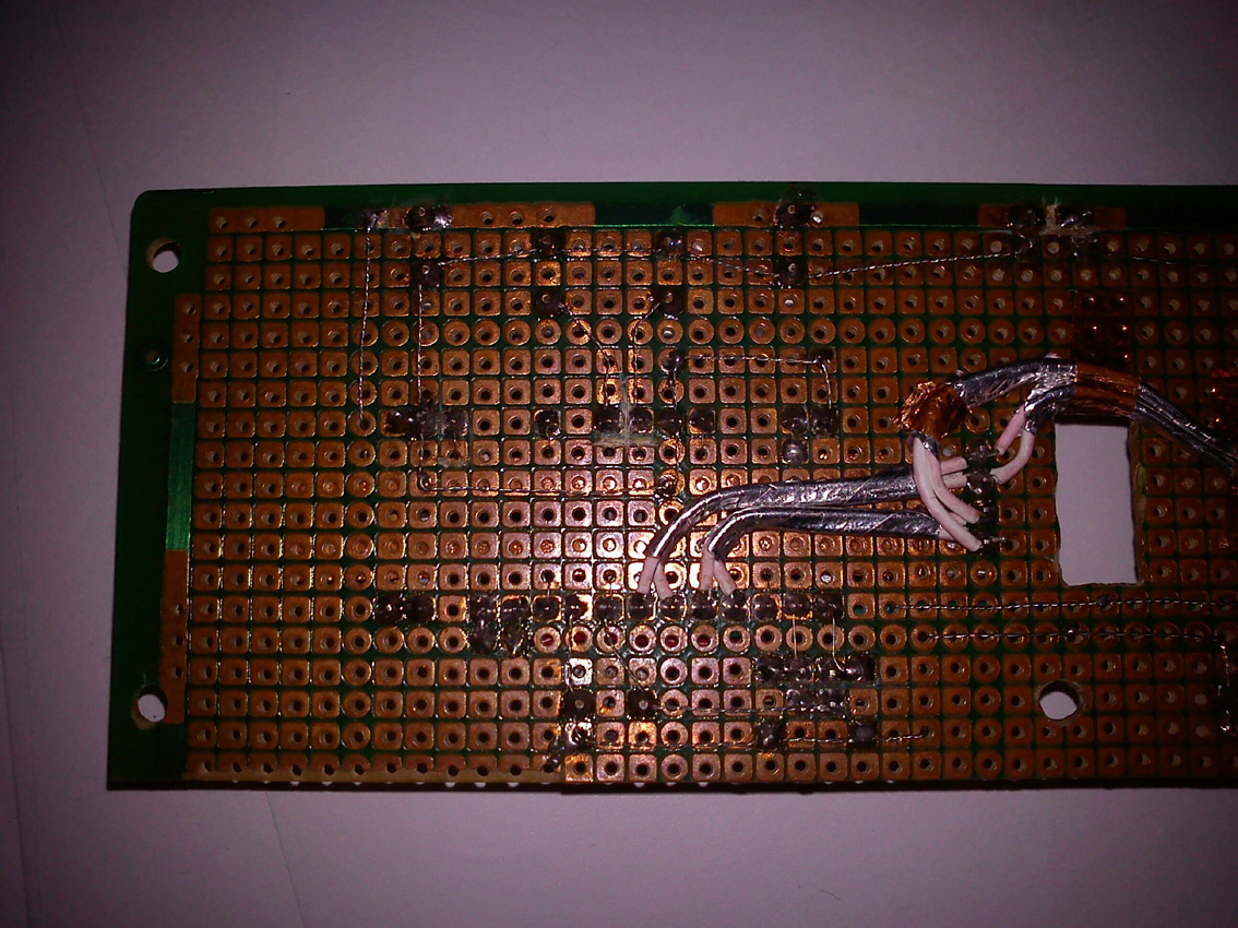

Recently I'm DIYing a PCM1794 based DAC, for me and for some friends of mine.
Well, the reason is very simple, just want to make an A/B test with the current DAC I'm listening to, TDA1541 NOS, and to share some fun with friends.
This project was started since last December and this couple of weeks I got some free time to focus on it. The schematic is nothing special just followed TI proposed designed confronting with Andrea Ciuffoli and Pavouk circuits.

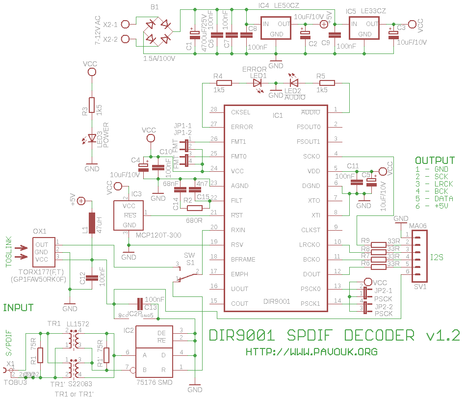

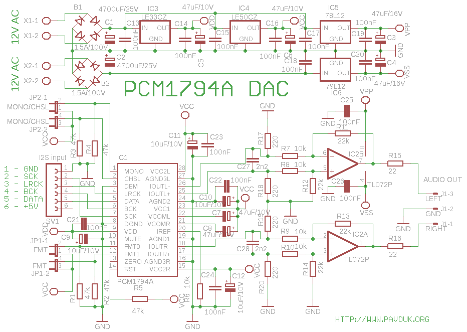

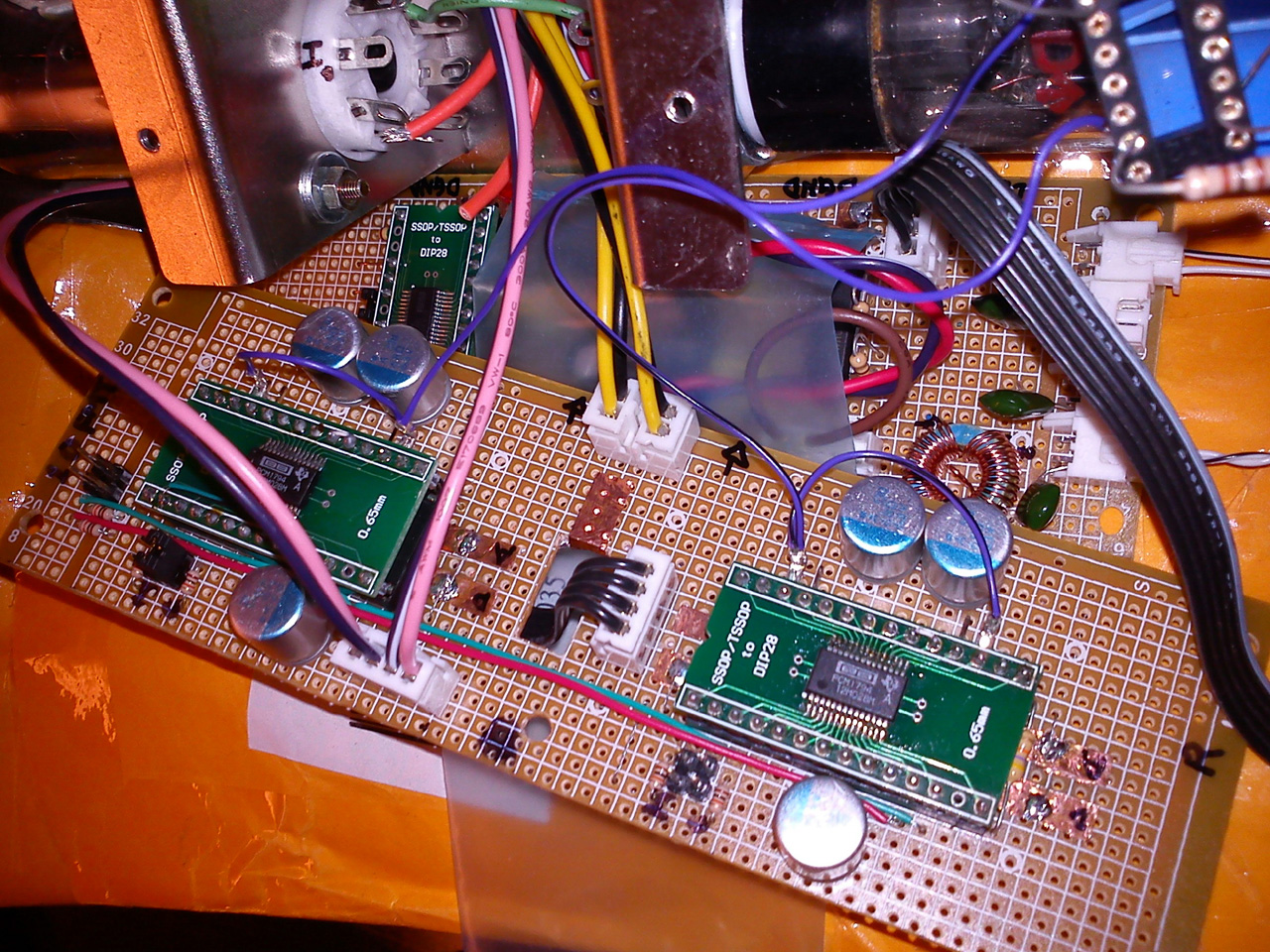

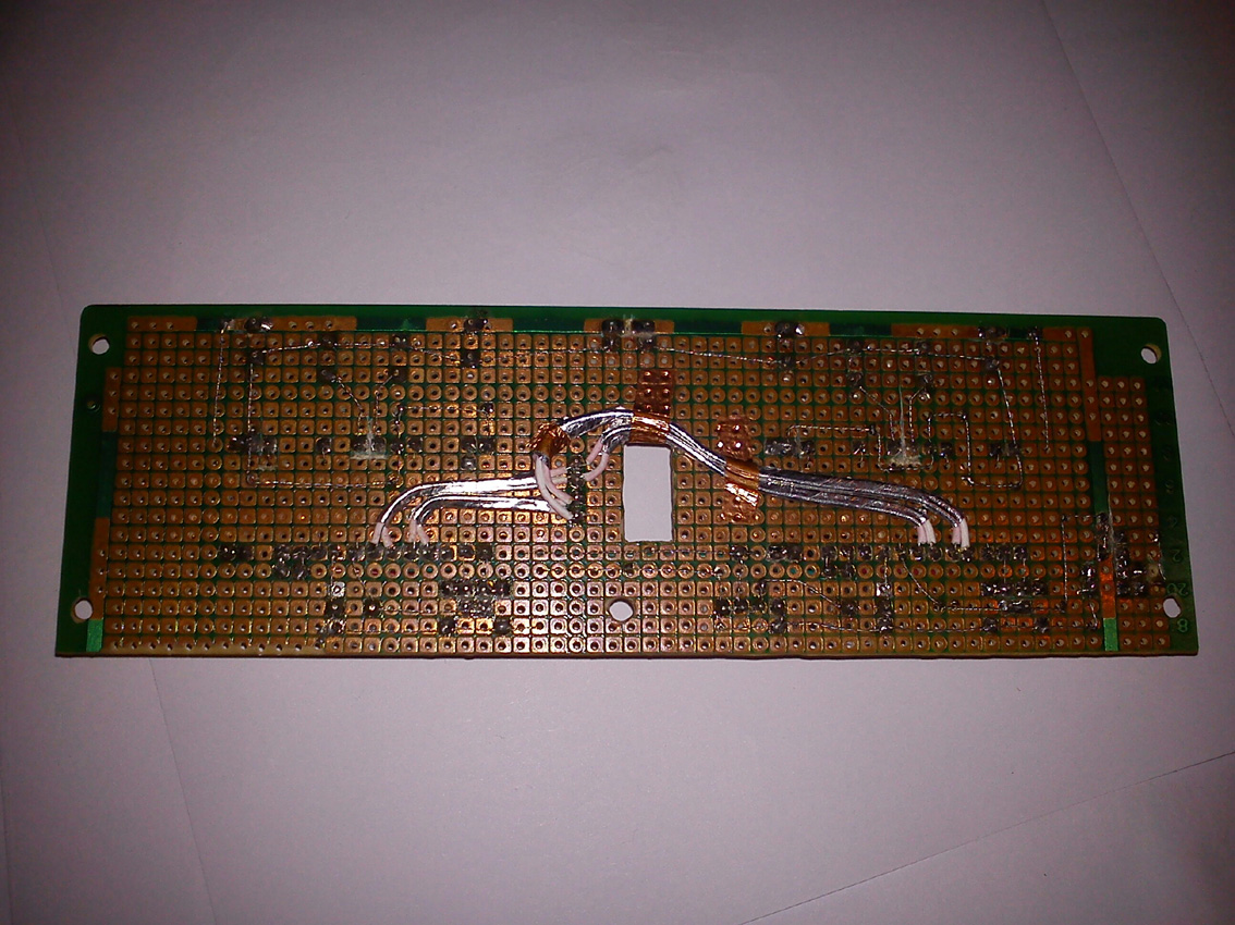

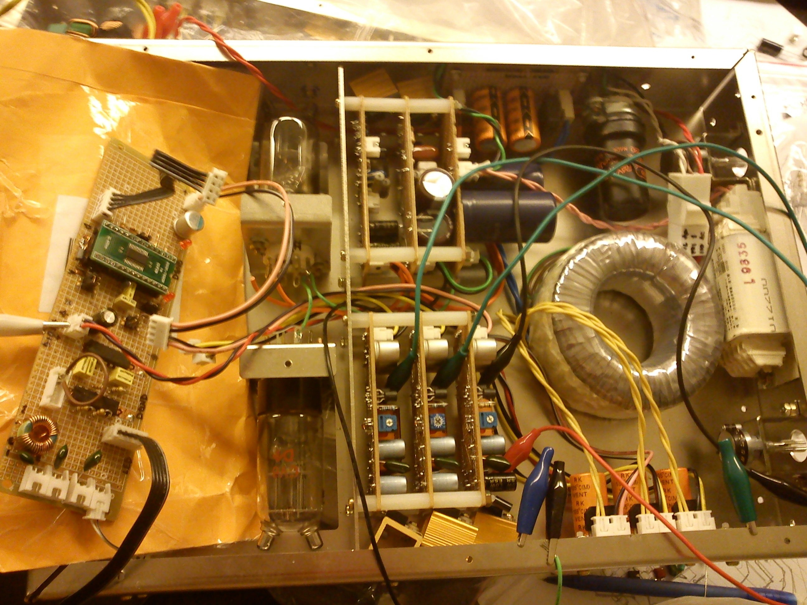

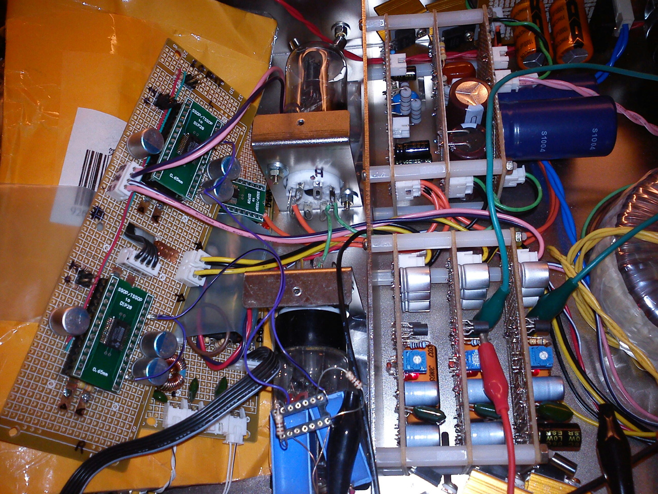

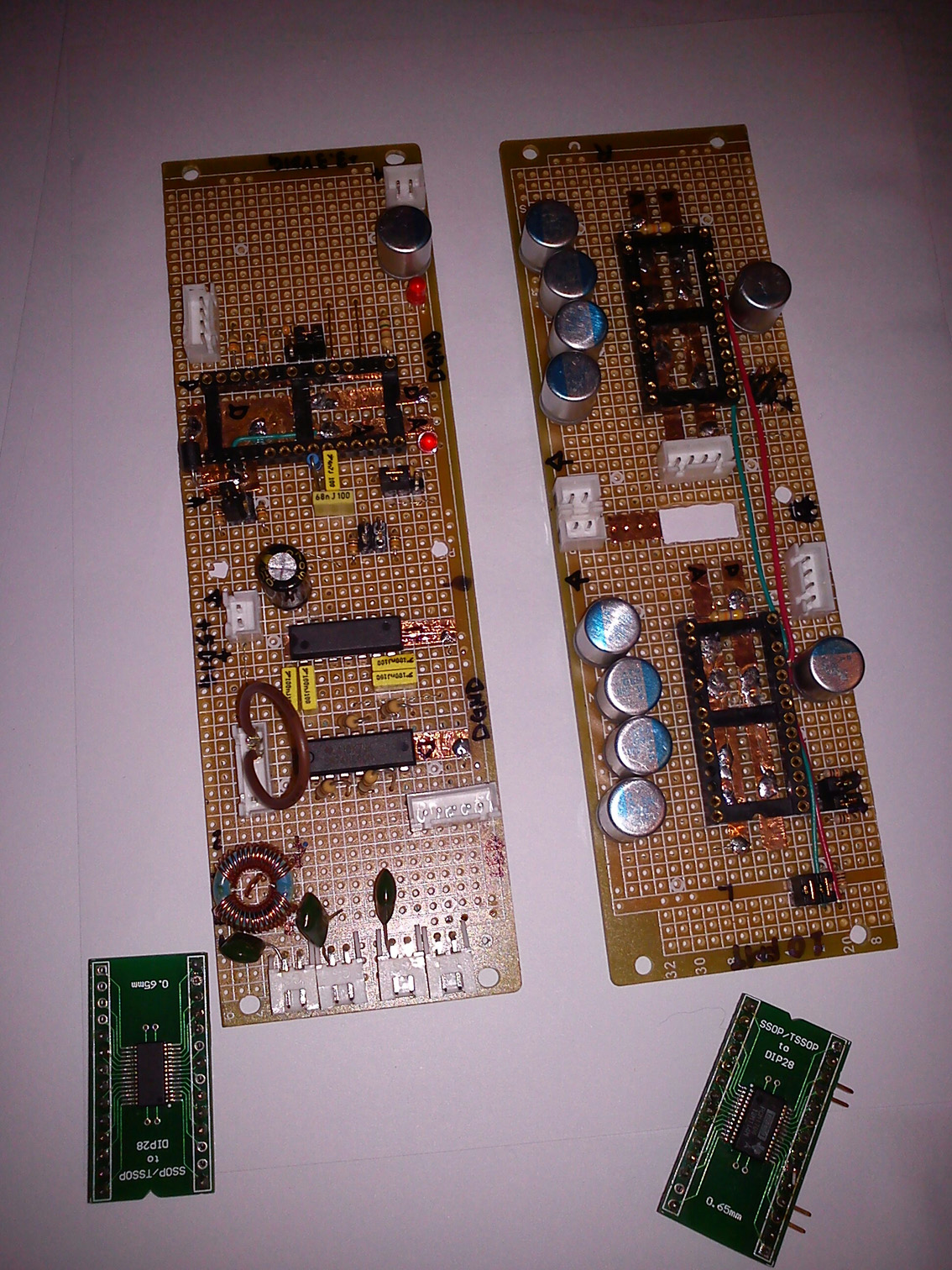

I took some photos showing the main DIR PCB and DAC PCB.
Just like I wrote in the title, unfortunately I burnt 4 of PCM1794 up till now. I can't believe that these chips are so fragile...
I checked the layout many times but can't spot the problem.

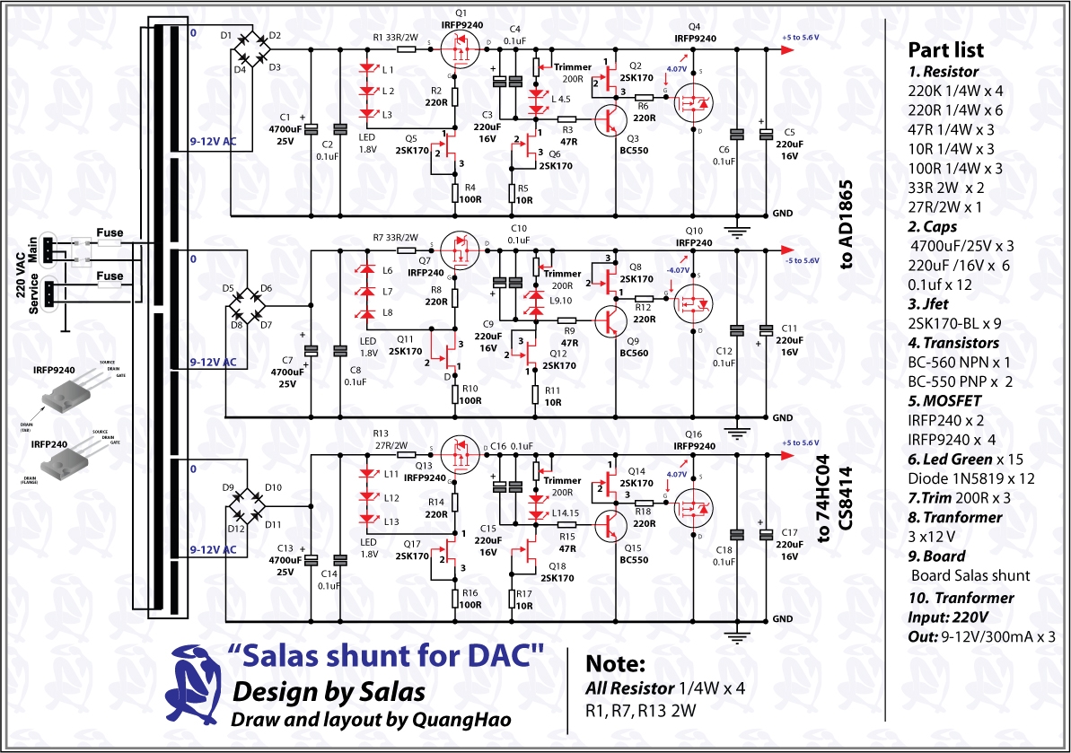

Power supplies are shunt regulators which worked flawless and considering the current limiter that prevent short-circuit at the output.
The situation is this, once the power is on the 3.3VDD of DAC starts to decrease and the DAC increases in temperature which seems like a shortage somewhere. First with the 3.3VDD power rail, and a few seconds later the 5V VCC starts decreasing too.
This problem is so weird... Is there anyone having the same problem with this DAC? Any suggestion will be welcome!! Thanks.

FWIW I do not like those like those not so little dac boards as there should be decoupling of the reference and supply pins within mm of the device package for best performance. I'm wondering what sort of decoupling you have..
What are you doing for I/V conversion?
Can you post a schematic of what you are attempting to do? And unfortunately I have a lot of concern about your build technique which is not appropriate for high speed, high performance digital/mixed signal devices. I don't see any evidence of good low impedance digital grounds, power or decoupling and rather a lot of very small wire tack soldered here and there. I also see what appears to be a highly capacitive implementation of I2S..

My first suspect would be the power supply. I never trust a shunt-type power supply. Not without crowbar protection, but sometimes even that is slow to react to voltage spikes (depends of the capacitor on output of regulator).

I revised the layout once again and did try point-to-point check: SSOP adaptor pin to IC pin -> socket pin to IC pin. There was no open circuit.
The same 3.3VDD provide both DIR9001 and PCM1794, however DIR9001 was still alive.
May be I didn't care too much about the ESD, but DIR9001 was soldered the same way PCM1794 was, so I'm quite confusing about this...

I'm not that hostile against the shunt regulator, after all it provides a very stable voltage that satisfied my need. Please check out the attachment.

This is unlikely to solve your problem. Looking at the schematic for you I/V converters I can't help but notice that your circuit is quite different from what TI recommend you do on the outputs.
First of all the outputs of the DAC chip are designed to work into a virtual ground, ie zero ohm source resistance. From your circuit diagram is looks like your I/V stage isn't doing this. The second thing that jumps out at me is the 2n2 cap that you've got soldered across the outputs of the DAC. This is the one thing the TI engineer advised against me doing as the chip would be unlikely to enjoy the capacitive load.
As before I recommended disconnecting the DAC chip from the I/V stage and see what happens. From my experience chip wont burn if the I/V stage is disconnected, but the chip can burn if something goes wrong in the I/V stage.
Okay, I may have spotted an anomaly. Your photo of the PCM1794A mounted on the green DIP-28 adapter board appears to show pin-19 (AGND1) wire shorted directly to pin-20 (IREF). Pin-20 should be connected to analog ground via a 10k resistor.
I believe that's a 10k surface mount resistor that wmincy has between pins 19 and 20.
Yes, I can see that now. My eyesight isn't what it once was. Looks like an SMD resistor, as seen edge on. I thought maybe I was seeing a piece of wire. It's very unfortunate, that he is having such catastrophic failures of multiple DAC chips without ready determination of the cause.

Today I gave another try: I checked the layout again, point to point test. And I also change the socket. Then with a new PCM1794 soldered, I crossed my fingers and... I heard sound coming from the earphone!! Hurrah!!
I left it played for a while but I was too early to cheer. I switched off and switched on to make sure things are going right, but bad things happened... once again, the chip was fried. Then I checked for pin shortage and the resistance value between VCC1 and AGND was low enough to behave like a short circuit... so frustrated I'm...
But I'm now sure that the layout was ok, otherwise the would be no sound at all.
I think tomorrow I'm going to switch to voltage regulator, I just want to make sure whether the shunt regulators were defected or not.
This DAC is making me crazy!!!!
Yesterday 4/18 I did try switching to voltage regulator, and removed 2x low ESR capacitors from the +5VCC power rail (which turns out that the problem had nothing to do with the capacitors), however I still stick to the same PCB, same layout... sorry qusp, i'm quite insist about the correctness of the layout (I made it with the use of EWB). Besides these minor changes, I soldered the chip with less, almost zero, soldering flux and after soldering I cleaned the adopter with alcohol. And this time, guess what, it worked, and it worked so well that I left it running for nearly 1 hour!!!
Yes, finally it worked!! I might guess that before I put too much flux without cleaning it, may be some of the residual tin was causing short circuit. I went to bed and left this hypothesis to be verified the next day.

As to the power regulators, I wouldn't expect these to be the cause. Except for the 5volt line, you have been powering other chips from the 3.3v line and they have survived.
Do bare in mind that some regulators do not like having large amounts of capacitance or ultra low ESR capacitors placed on their outputs as it can cause instability. The PCM1794s will function just fine with the 10u per pin as described in the datasheet. There is no reason to use a larger value capacitor here. If you really want to get a lower ESR part near the chip pins then go for a higher voltage version of the same value and series.
after weeks of work since i burnt the last PCM1794, I found out that the chips were burnt was due to bad grounding and the problem was solved with a star grounding method.
Now the DAC works happily.

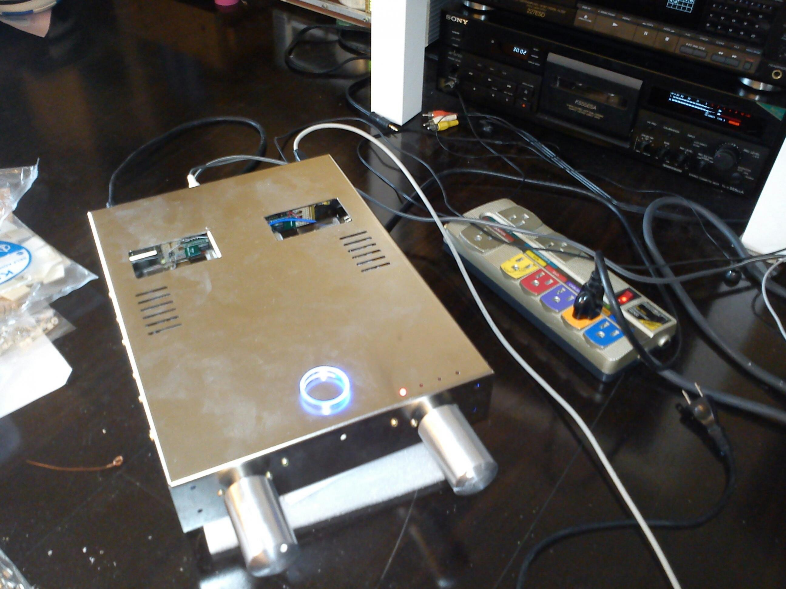

I noticed that the output level after tube stage was quite high so I reduced the I/V resistor so the level is contained.
At the first listening impression, I should say the details are amazing. The tube output, single triode CV6 "rabbit head" in anode follower biased at 10mA, gives a full body, transparent sound which is very very pleasant.
However, comparing to TDA1541, the sound was slightly brighter and a little bit invasive.
Overall, I'm quite satisfy with this new toy.
Here are some photos:

yes qusp,
After the first DAC i managed to build other 3 units of the same configuration.
I noticed that if i didn't clean the PCB and the SSOP adaptor properly, once power on, i would see some sparks between the pins, mostly occured on the adaptor.
So after these instructive experiences, i finally learn to clean every time i finished soldering. And I didn't burn a PCM1794 anymore (finger crossed)
Many sites also remarked that the cleaning of the residual flux and stray micro solder balls (squirt over the pcb during soldering, not so visible to the naked eyes) is necessary.
Well, i learned a lesson... in the hard way...
