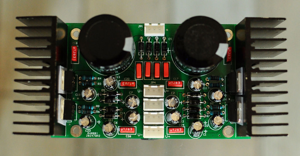

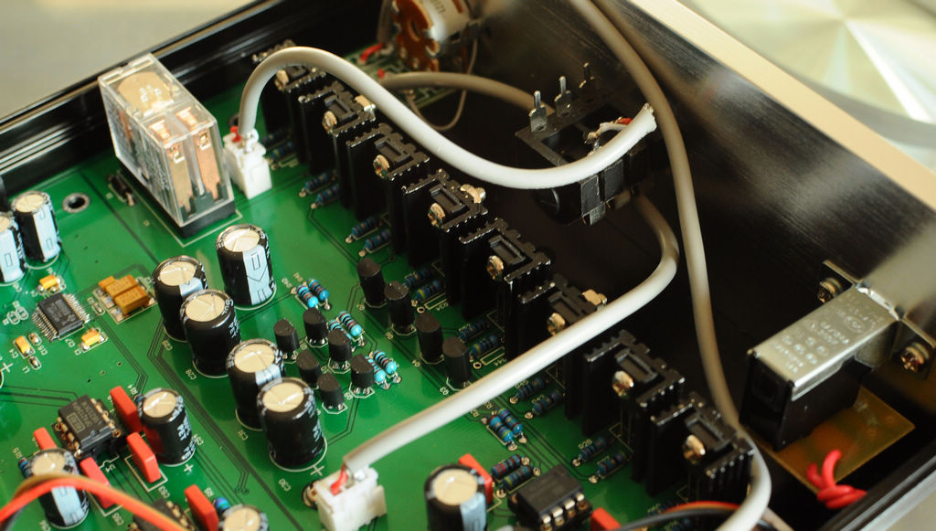

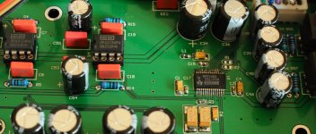

After several weeks I get this done. Sounds very nice but I'm still thinking about anything more we can do to improve it.
It's DIR9001 + PCM 1794 + several OPA2134 and Toshiba Transistors for head AMP. Oh a PCM2706 is also there for USB.

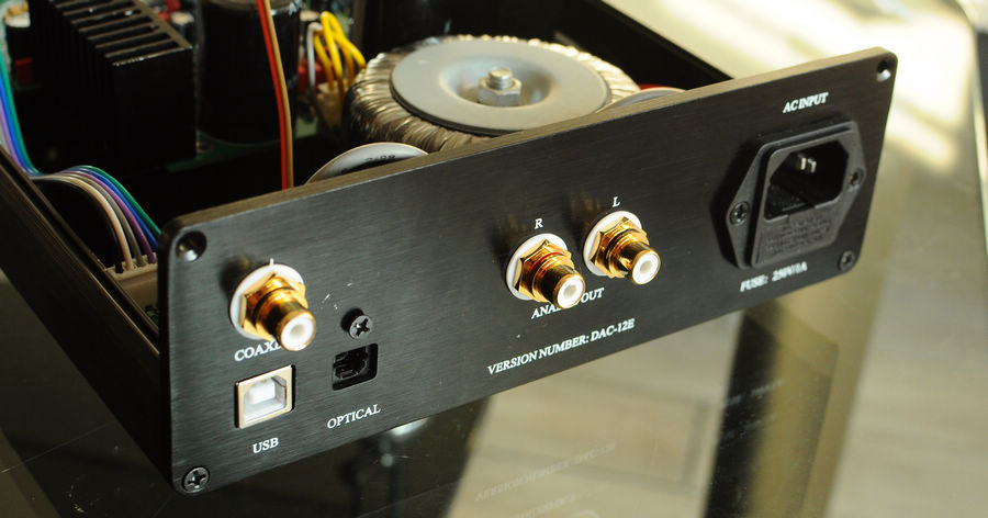

Re-think the grounding. Looks like you've got SPDIF input going in to a daughter board on the rear panel. Do you have a dedicated ground wire for that input or is it isolated via transformer?
I'm playing with a DAC design at the moment and have obtained what seemed to me to be surprising improvements in clarity from re-jigging the grounding of the digital parts even though they're fed from a separate winding of the mains trafo.
I am trying to isolate this digital part from the system by connecting it the the common ground by a single point, to be specific, via one of the PINs in the 6PINs I2S connector cable to the DAC board. Doing this to avoid cross talk over the digital and analog modules. However, redundant design to allow the GND plane of the daughter card to connect to the enclouser, test show there is not much diffrence...

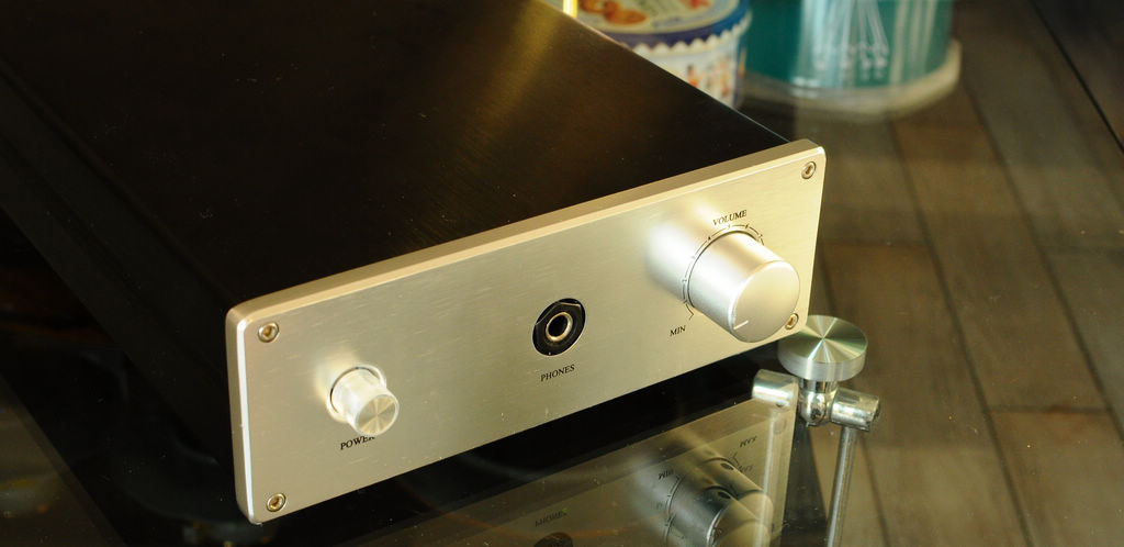

Photos included:
1)front_s, a front view of it.
2)rare1, rare view, three digital inputs, USB Fiber and COAX for SPDIF
3)power, power supply of the suite. Seperated power supplies for Large current amplifier and low noise signal processing
4)output, 8 transistors there for output, plus a relay for protection.
The digital and analog ground of each module is isolated by inductor or bead, seperated groud plane is there for them. This time some optimization is done over the power supply and it sounds great, better than my Marants Pure CD player.

3) It's the power supply of the whole machine, two seperated channels of LM317/337, with fully protection diode and sufficient WIMA Rubicon capacitor for filter, 4700uF/63V*2 for main filter. It sounds dead quiet, leave the input or press the pause of your CD player, turn the volume to max you hear nothing as if it's not powered on.
