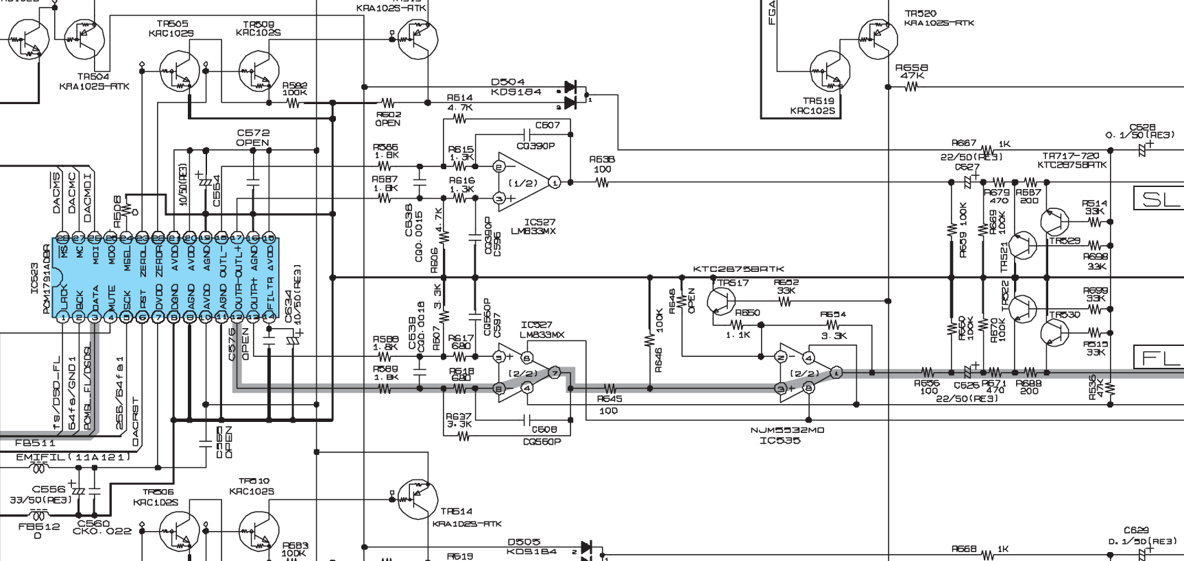

I have those DAC's in my receiver and in my DVD-player (Denon both).
Those are followed by some LM833 (in the receiver) or BA15218(5.1)/NJM2068(stereo) in the DVD-player...
So I want to swap them with something else.
Starting point: LM833 has 4 nV/sqrt Hz, 7V/uS.
My pick:
1. LT1028 (0.85 nV/sqrt Hz, 11V/uS)
2. LM 4562 (2.7 nV/sqrt Hz, 20V/uS)
Now, I know that the I/V stage is located inside the 1791 DAC, and it might not matter too much but I have the itch to do it.
TI recomens for this DAC the OpAmps: OPA2134 (8 nV/sqrt Hz, 20V/uS) or 5532 (5 nV/sqrt Hz, 9V/uS).
Any toughts about this? Did anybody experiment with changing OpAmps on voltage-output DAC's? It is worth the trouble (chips are SMD)?

The OpAmps that I have there are used for the third-order filter and conversion from balanced to single-end, so I think that some improvement can be made there.
Also in the receiver I have oane more OpAmp for front channels (NJM5532) that is used for the +6dB boost needed for HDCD decoding. I think that can make a difference too.

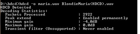

It is not for the extension. The HDCD normally has to be 6dB amplified after decoding to sound at the same audio level as when you play on the CD undecoded. It is switched "ON" all the time while HDCD signal is on.
I did the swap. Tryed both of the above. SOIC8 cips.
LT1028 runs HOT. I don't think it oscillate since the sound was ok, but, did't care to measure for real. Running to hot for my taste - and for the analog power supply I guess. And the pain with the single-dual converter... Too much!
LM4562 was warmer to touch than the original but in an OK range. Sounds great - I did swap the filter (and the +6dB) on the front and surround and compare with the back channels via stereo mode (as much as I can). Tested with SACD and HDCD - To my disbelief, I can hear a slight improvement on the high-end, clarity even. Nothing on the noise - it was "silent" from the start anyway and the difference between 2.7 and 4 nV/sqHz is anyway small. Maybe if I turn the volume to the max... but I can't do that easily with the Denon AVR 3805 in my livingroom.
All in all, three OpAmps swaped latter - I am happy. Thanks to National Semi, Linear and their free samples 🙂

Why would they throw a whole bit away ? 0.1dB is lost for the DF function. And 6dB is the transient boost that never happened, neither the slow roll-off filter-swap.
They don't throw away nothing. Listening to a HDCD via a regular CD player will produce a compressed analog audio that will be percieved as "louder" than the case that is run via a decoder - the decoder un-compresses (expands) the signal, so it will be perceived as not so loud.
To compensate that, HDCD license requires that the decoder has a mechanism to amplify the analog audio by 6dB so it will pe percieved as having the same loudness as previous case.
I think this was done initially so the people don't perceive HDCD decoders as weak and maybe associate them with low quality.
