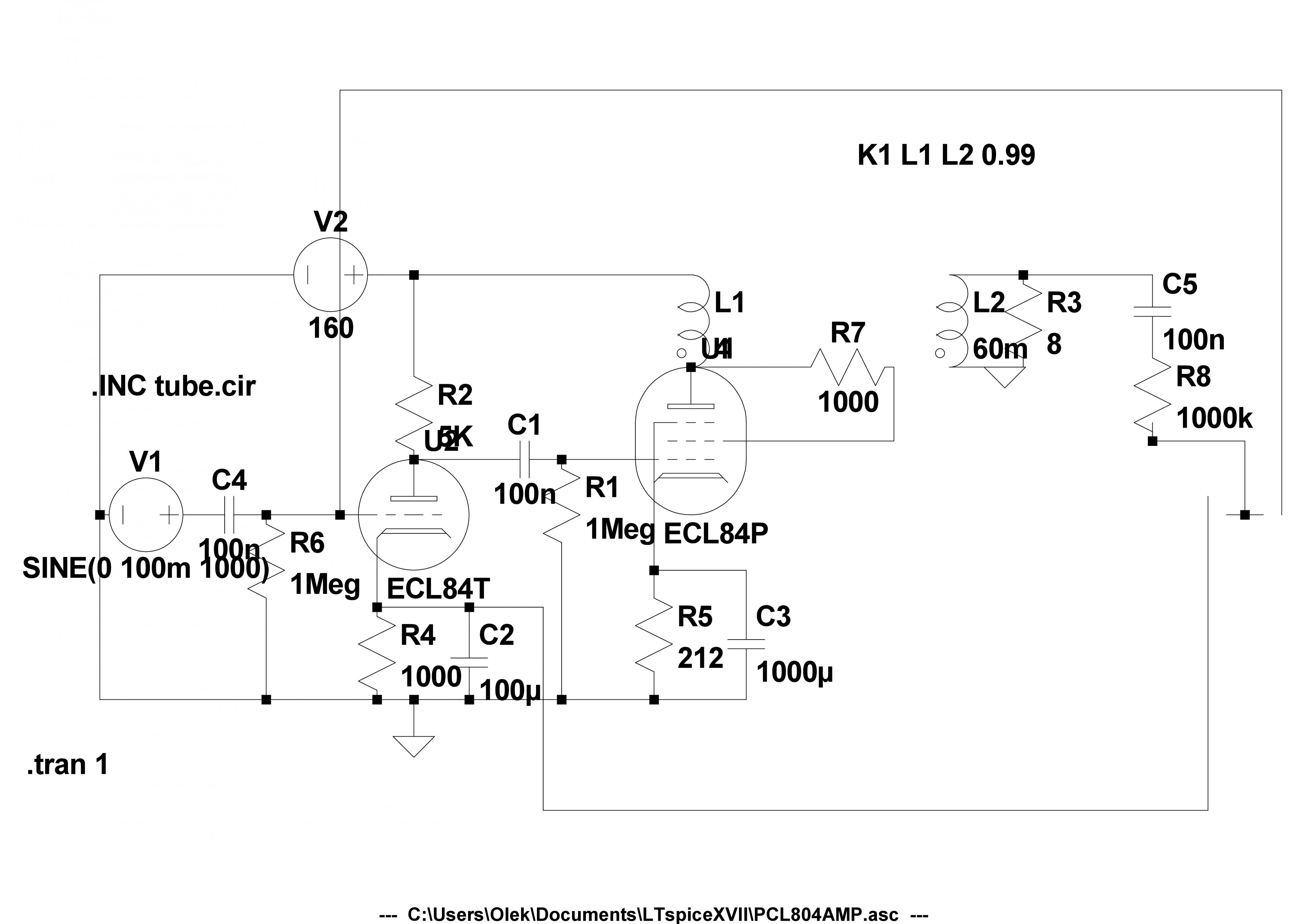

This is my first post here, I came asking to review the amp I'm designing:
I triode-strapped the tube so it would be easier to wind the transformer (lower primary impeadance=less turns). In the attavhments you can see diffrent feedback methods.

Okay, got it!
View attachment cathodefeedback.pdf
View attachment grid_feedback.pdf
View attachment no_feedback.pdf
View attachment schem.pdf

I shall leave it to the valve experts to comment on your cathode and grid feedback loops.

Hi Gamebuster!
I suggest you do a bit more research on how global negative feedback (GNFB) works.
Essentially, you have to feed a small fraction of the output voltage back to the input. This is done using a voltage divider consisting of two resistors. You have included one of these resistors in your circuit, but not the other one.
See Figure 31 in the link below where R1 and R2 form the voltage divider. (Note also that the capacitor Csn is in parallel with R1 and not in series as shown in your circuit.)
4.4 Global Negative Feedback in a vacuum tube amplifier - Vacuum Tube Amplifiers - DIY
Oh, now I see, you put a aditional resistor between the cathode bias and ground, you apply the feedback on that point by a parralel resistor-capacitor combo.
