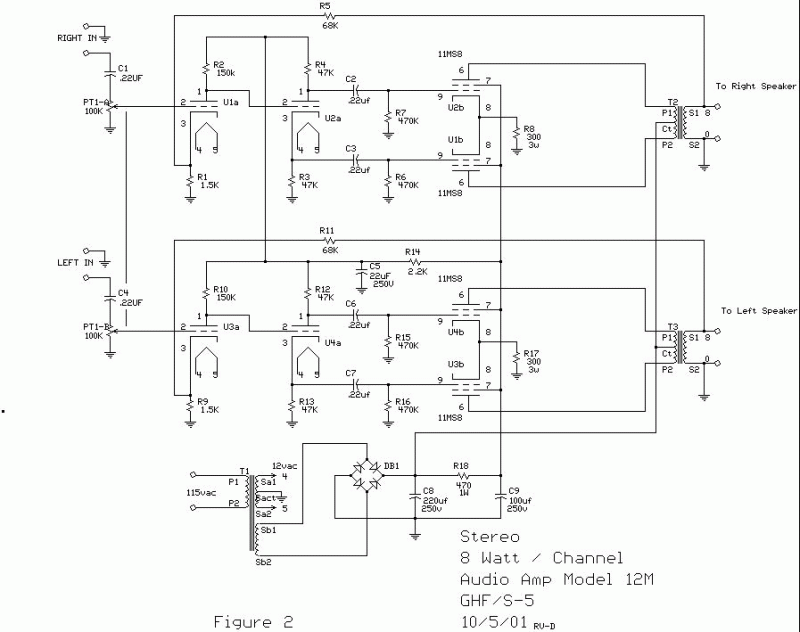

Actually, a pair would make a very nice line stage/buffer. Use the triode section as a cathode follower, and sit it on the pentode section used as a constant current sink. Use a 300mA DC constant current regulated heater supply, and you'd have something with performance completely out of proportion to price.
OK, I'll try to fight the regulations another way 🙂
here is a link:
http://www.tubehifi.com/amp/amp/circuit/mghead-c.jpg
here is a link:
