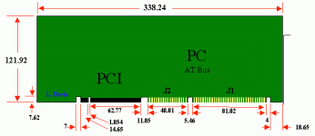

I want to introduce the idea of a PCI card power amplifier; possibly with onboard power supply. What are your thoughts on this? With the emergency of computer based audio I think it is time to start designing such a product.
You might have a problem with power supply current.
On board power supply ? You mean batteries ?
There will not be enough space on most boards. Parts cannot stand up too tall. Off board plug in power is a possibility. What about all the existing switching noise in the area ?
How much power are you looking at ? 10 to 20 watts classD ?
Remember as power goes up, at a point heatsinking will be required.

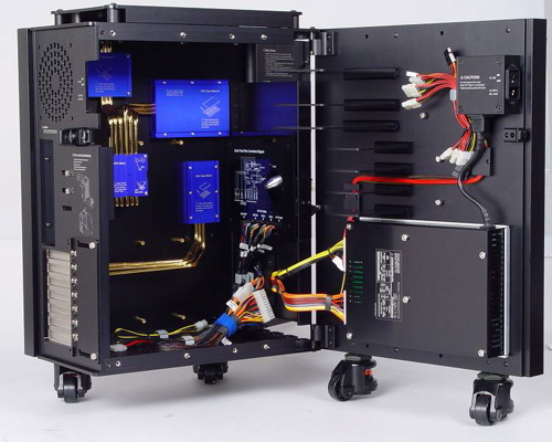

Yes, lots of problems need to be solved. Heat problem may be solved by heatpipes attached to computer case heatsink for silent cooling. See Zalman case. Power transformer can be located off board, in pc case. PCI card may be screened for noise. Would be nice to have a PCI card version of the UcD180...
