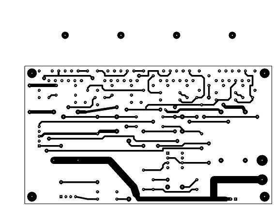

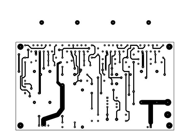

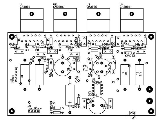

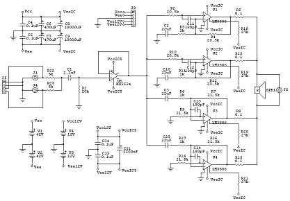

I designed a PCB for a bridged/paraelle amp but its mono. However, I only have one set of bypassing capacitors. They're located in the middle between the 4 chips. Does anyone know if this is good enough, or should each lm3886 have its own bypassing caps, and if so how big?

Sure no problem.
Included in the zip file are four files. One shows the entire board, all components and tracks. One shows the top layer tracks. One shows the bottom layer tracks. And then I've included the schematic as well.
Cautions.... This is untested. I do plan on building it, but not during exams! Ok, now it only has one set of bypassing capacitors for the four op amps. I have no idea whether this is a bad thing or not. Perhaps with a regulated supply it would be ok, or maybe it's fine anyway. I've tested the circuit in circuitmaker and it seems to work fine there. It's pretty well straight from the application note. If you build it please let me know how it goes so I can make any changes before I build it! hehe.
Ok the file is too big to attach, so I'll go image by image.
Enjoy.
Pete
Enjoy.
Pete
