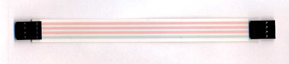

You can get these Molex to Molex connectors from Digikey.

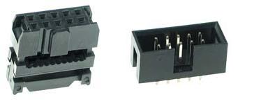

Thank you all for your replies!
I really like those IDC cable connectors - they splice the insulation for you! No crimp tool needed (well, maybe a small vice would be helpful, but I already have one of those!), and they can come keyed (with the male end shrouded) if needed so that you can't insert them the wrong way!

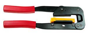

There is a proper tool, but a small vice or pliers usually works. I have to recommend that you test each IDC cable you make though, if you don't use the proper tool, some of the knives may not cut the insulation first time.
