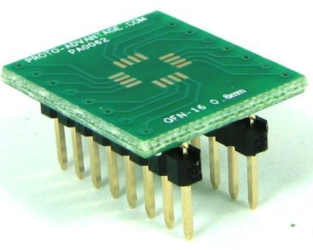

Are you thinking of SMT adapter boards, to which you solder an SMT component and the board "enlarges" the connections to mate with DIP or other through-hole patterns? There are several suppliers - seed a search engine with "smt adapter".

I have been in the process of making patterns of adapter boards for use in the TH board places using dip trace.
Then I just print off a whole sheet of one type of pattern, then I can just cut out a section to iron on as I need to the copper clad material.
