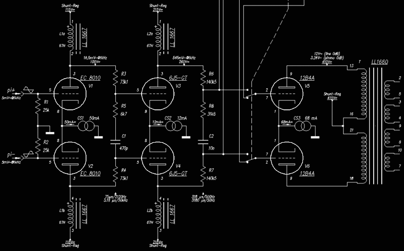

All,
i have such on my back burner but it is not yet ready. It is an AutoCAD plug-in, written in LISP and also supports p2p-wiring as the logic behind is not coupled to the graphics as is with usual ECADs. PCB components, p2p components, schematic symbols are completely equivalent and contain the same data. To enable bidirectional annotation. But one warning: fancy rubber bands and density histograms and autorouters will not be part of the show. It is not your task to check connection state but it is your task to draw routes on the PCB and wires and lines in schematics yourself. OTOH, if oyu know what you are doing, you can use teardrops and other fancy PCB stunts like provided only by $$$$ ECADS like PADDS.
It is part of my AutoCAD utilities which will be downloadable from my website soon.
Watch out for my announcement that NetCAD is ready if this part of the routines are the only part of interest to you.
Libraries: can be created from AutoCAD drawings; i will provide example drawings.
Consider this is real CAD and you can draw everything like you want it, not as withing the limited limits of ECAD.
The routines also contain a powerful automatic symbol/component creator and update routines for existing library drawings.
If i find there is sufficient interest, i will increase my priorities on that project; currently priorities are low.
Below i have a schematic drawn with it.It is an obsolete version of my phono preamp
