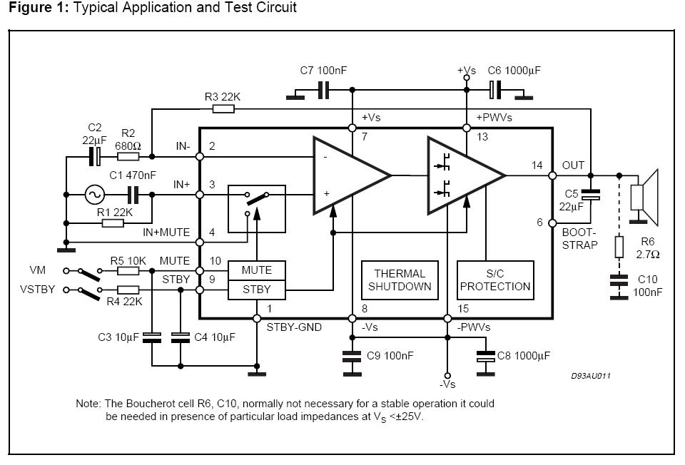

Linuxguru has made a wonderful suggestion of the TDA7294 chipamp. I too have been considering this chip for quite sometime.
A quick question: Would there be any difference in the quality/performance of amps made of monolithic chips, STK modules and discrete components?

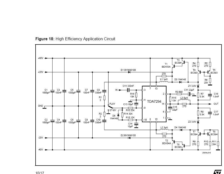

Am also attaching the circuit of TDA7294 that mentions a "high efficiency circuit". I could not attach the entire pdf as its too big.
Please suggest if this circuit is good enough.

you can make the high eff. circuit(TDA7294) but it is too complex. But you can make the circuit shown in Fig. 1 in the official datasheet. the PCB layout is also included in the datasheet

The TDA7294 high-efficiency circuit is actually a Class-G output stage with dual rail pairs, a low pair at +/- 20V and a high pair at +/- 40V. It is worth reading and understanding Class-G operation before attempting this circuit. Douglas Self's book has a chapter and example discrete bipolar circuit for Class-G operation, but the principles are the same here.
The basic TDA7294 circuit (non-bridged) is simple and reliable - there are numerous tweaks to it in various gainclone threads on this forum. I would strongly recommend it as an excellent first DIY amplifier project.
