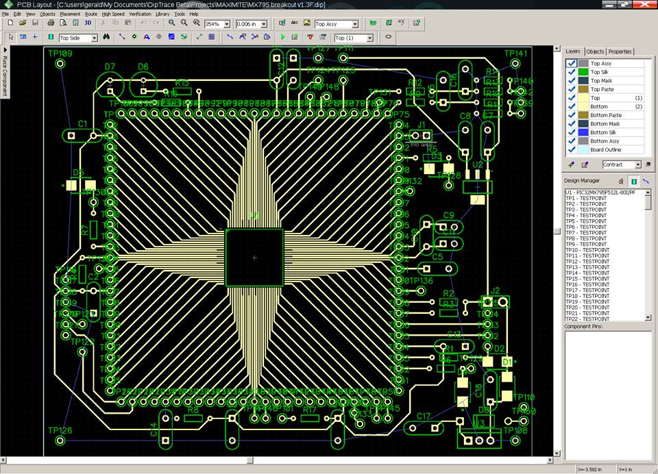

I am getting Great results using DipTrace 2.9.
However I did try to import an ASC that I did from LTspice and it did not work, This may be because of an issue with the components I used in it I don't know, I will have to investigate this further.
But, it is supposed Import from some of the more commonly known packages that are mentioned in the thread.
Once I had gotten used to working with it and know my way around, this package is the easiest thing I have ever used since my Circuitmake2000/Traxmaker days (that I do still use today).
Here is a sample of a Maximite Color Computer/PIC32MX795 Breakout Board that I am working on.
I threw this together in just a few evenings and I did this sample of the Layout from scratch in just last two nights from the schematic I drew in DipTrace as well.
It is free and it does work pretty good once you get used to it, if you contact them they will increase the pin count capability from 300 pins to 500 pins for free.
Eagle is great but this is a viable cheaper alternative to it.
It is supposed to be compatible with Eagle files as well, although I have not tried any yet as I am only interested in my own designs.
But, I do have Eagle to view other's projects should I need to as well.
