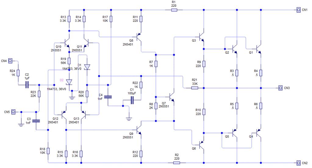

anybody want to create a pcb layout for this schematic pls...

Personally I think this is quite risky for you if you don't have additional info. Making an amp with +- 90 volts supply voltage requires good knowledge.

hi peranders, yes i didnt have a wide knowledge on this profession,
this schematic was tried and tested on +75 0 -75 volts with 3 pairs of output and it works well.
but i dont have a pcb layout for it and im not good on making it.

yes thats the design, could you make a pcb layout?
Q3=mje15032
Q6=mje15033
Outputs=c5200

Yes, I could, no matter what it is. Will I? No. If you're not willing to try, then I'm not willing to help. This IS DIY, after all.

I tend to agree with Bill, this is a DIY site where you will find loads of help, but NOT people willing to help those who don't or won't try.
I am still learning every day as this is not my profession either, the fun is in trying or trying to find out the answers, not to join and ask others to do the work for you 🙂
Try this site, I found it really easy to learn the software and now use it to design my own parts and PCB's every week.

i have created the board, can anybody check my work and put a ground on it.
ill gonna email it, so pls post your email.

There are numerous free pcb packages on the internet.
There are also paid for packages which usually have better functionality than the free ones but do tend to be harder to use.
A pcb package with plenty of error checking is best as one fault and the pcb needs hacking to get it going.
Keep your pcb as tight as possible with thick tracks for power and you shouldnt go too far wrong.

Why do you need software? For decades people used pencil and paper. For one very simple board an easy way to make a one-off PCB is to first drill the holes, make sure the components fit. then connect the holes with 1/4 or 1/8 inch wide black vinyl tape. Stick it down good then etch the board.
You really can't do complex digital projects this way but audio amps tend not to use those tiny parts. You can sketch the PCB layout right on the copper board with pencil then when you like cover the pencil lines with tape.
I'd split a complex project up and use several of these PCBs. One for the power supply, one for left and right power section and so one. Easier to debug.
If you are new to PCB designing then build a working power supply first. Use the vinyl tape method. maybe make a few of those, then a simple power section for an amp. Only then try something complex and maybe get into software.
You dont for simple layouts.
Once there is more than say a dozen components then errors can creep in and cause all sorts of problems.
There are plenty of free cad packages around now which will allow the iron on method before developing.
A major advantage of pcb cad software is the error checking between sch and pcb and also for clearances etc.
