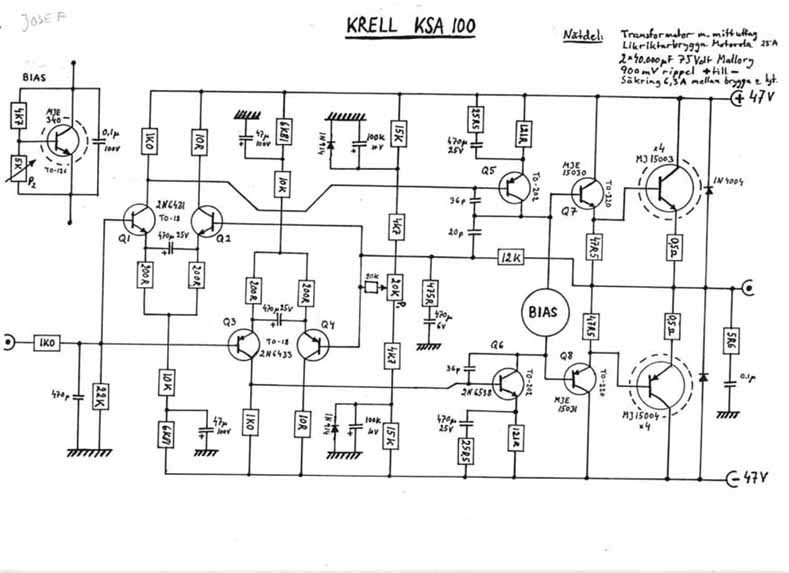

This is the KRELL KSA 100 SHEMATICS ! ! !

Your link gives a 404 error (page not found). Besides that the schematic of the Krell KSA100 has been posted before on this forum.

I am still surprised somebody can get to world fame with a schematic right from a textbook (not the best!) and (by today's standards, mediocre component selection)!

Look what i said when i see the schematic about a year ago:
"my mouth is still open with the scmatic of KSA 100.
First of all a run of the mill project that not even use corrent sourses in the LTPs but even worse use a electrolitic capacitor with no dc voltage across the emiters of the LTPs.
Amazing world!!!"
So now we are two!!!😉
