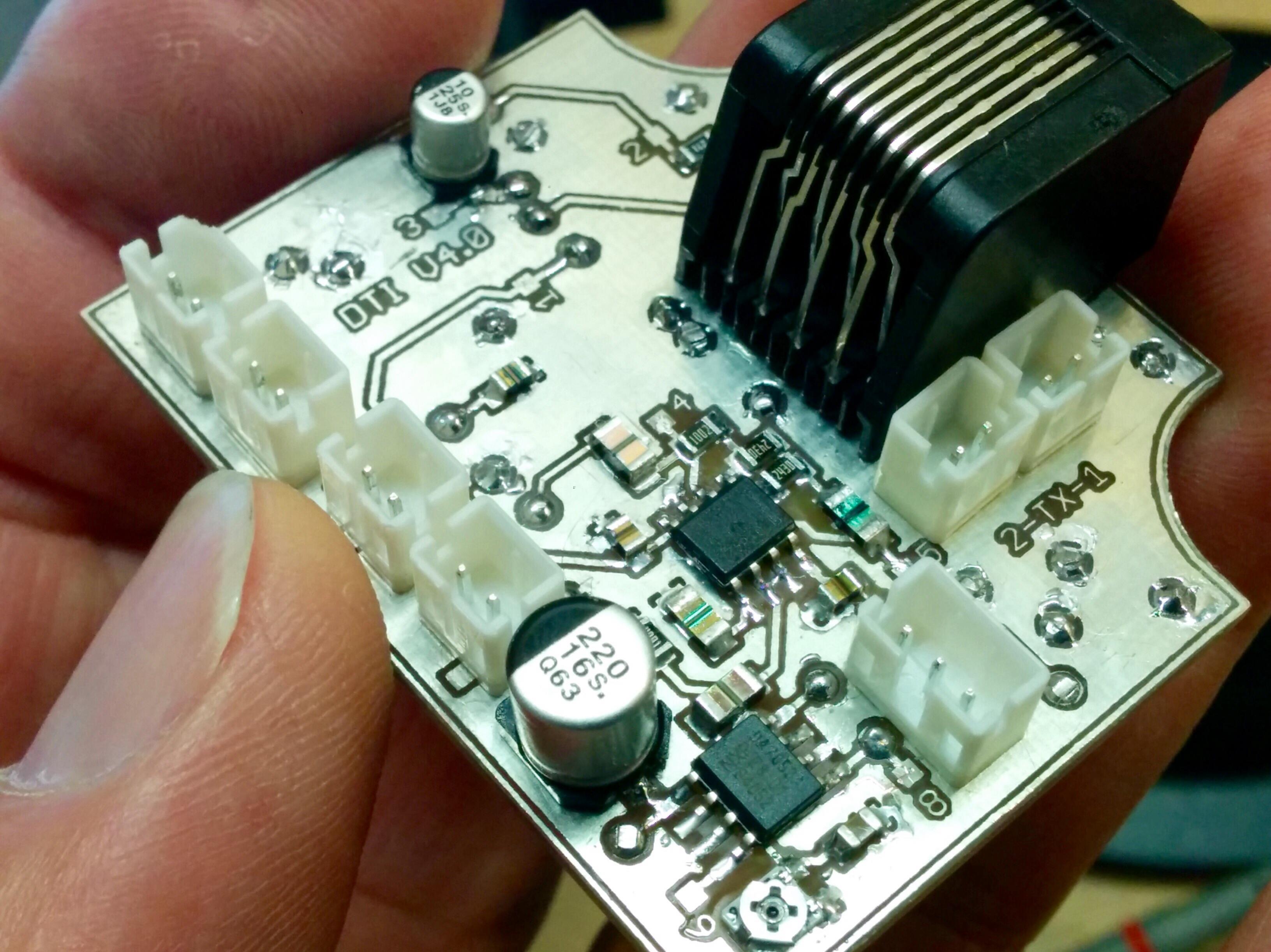

or you can build your own. Undercutting and loss of detail occurs in cold etching because of the time it takes. Large areas of copper take so much time that the really fine stuff gets compromised. Ferrric chloride works best at 50C and it etches fast with no undercutting. A typical board takes just a few minutes. This is a double sided board that etched in under 4 minutes. I often etch test point numbers and other important details right into the board.

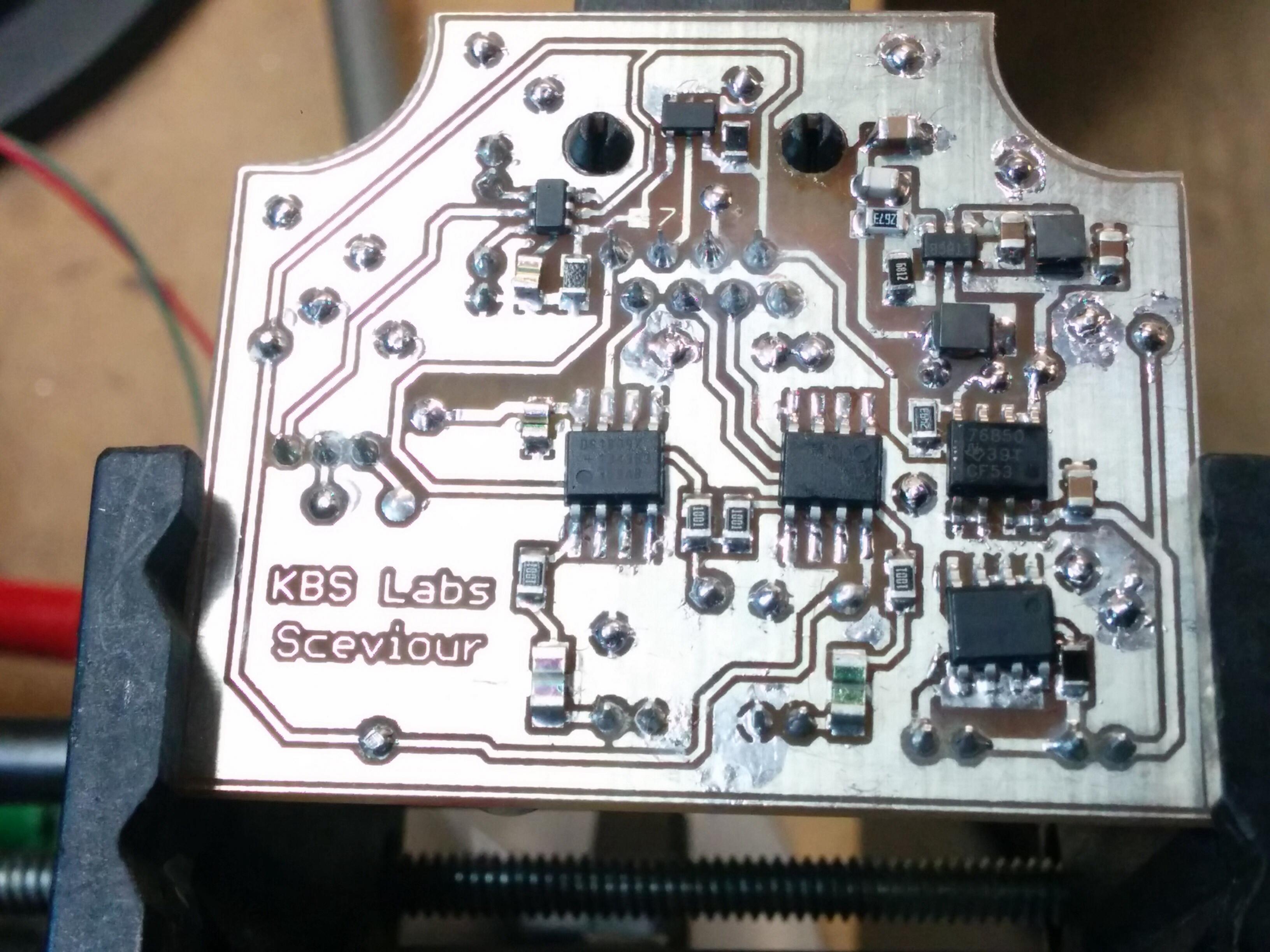

This is the other side of the same board. Please ignore the poorly placed Mosfet in the corner. I was trying out my new reflow system and that chip didn't center up very well with the large common pad under the drain pins.
