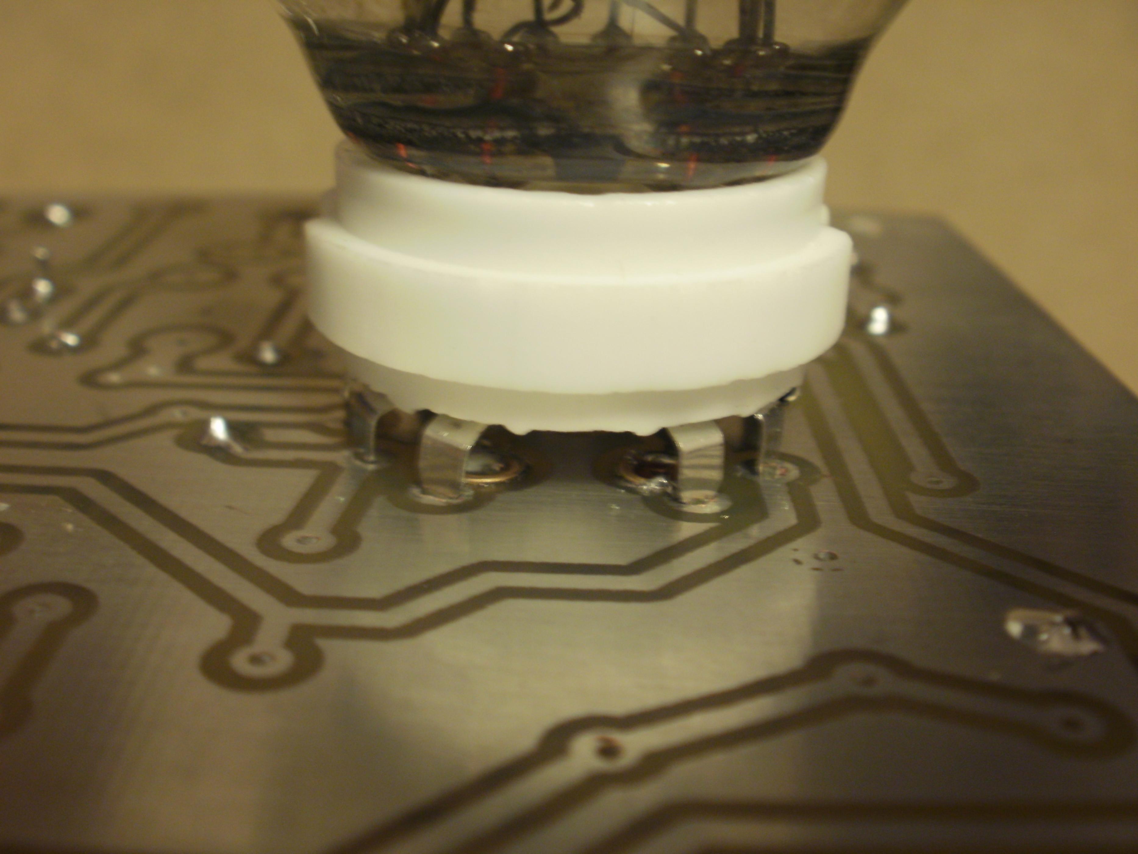

Worth a mention. I knew someone who built a tube amp with alot of SMD stuff in it, and soon after I was the one who repaired it. Tempting it is to use Melf resistors and caps, (if one can get 'em cheap enough) make sure the PCB is mechanically evenly fixed, i.e can screw down with distorting it and components.
The damage is obvious and can easily happen when a tube is withdrawn from socket and stresses the PCB.

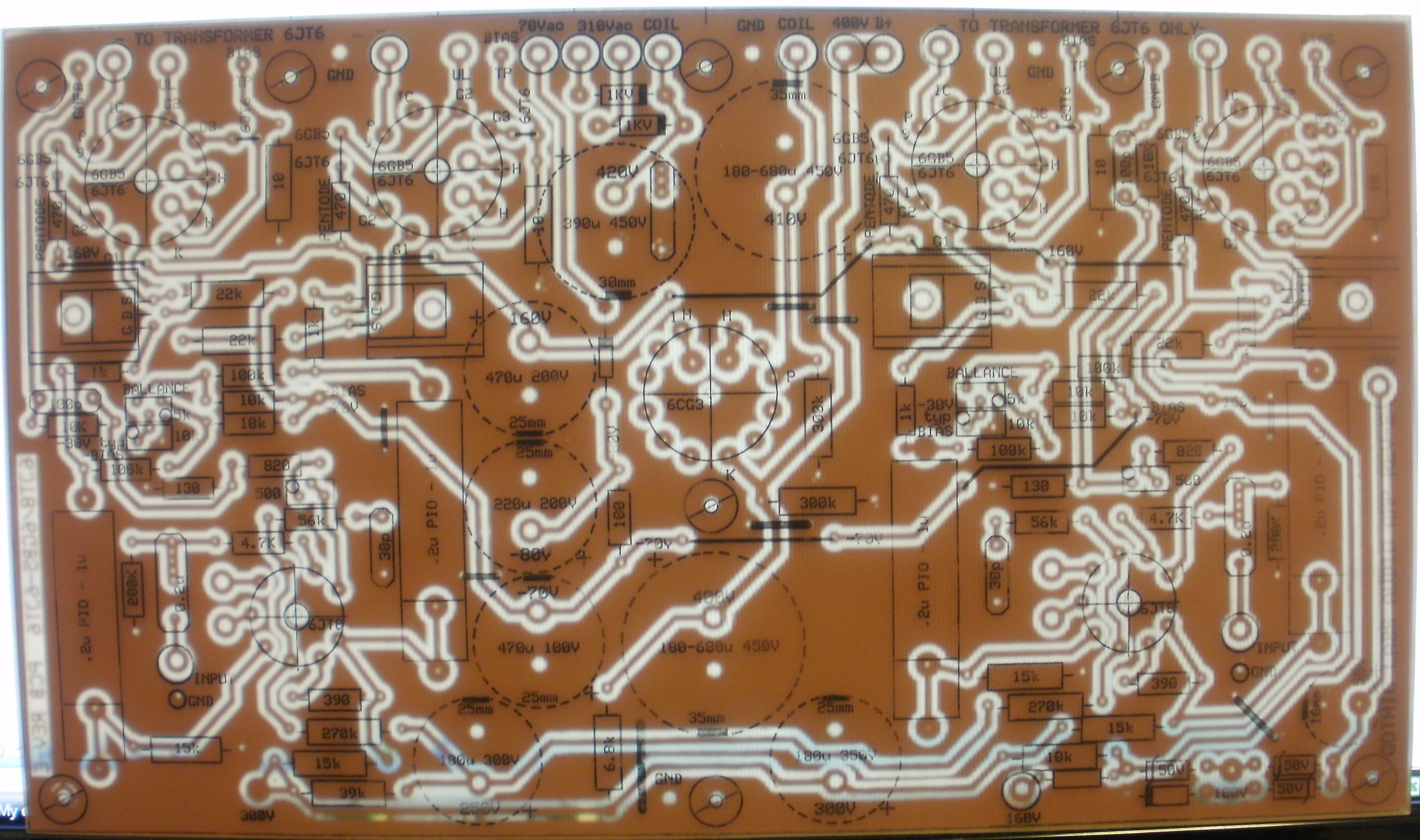

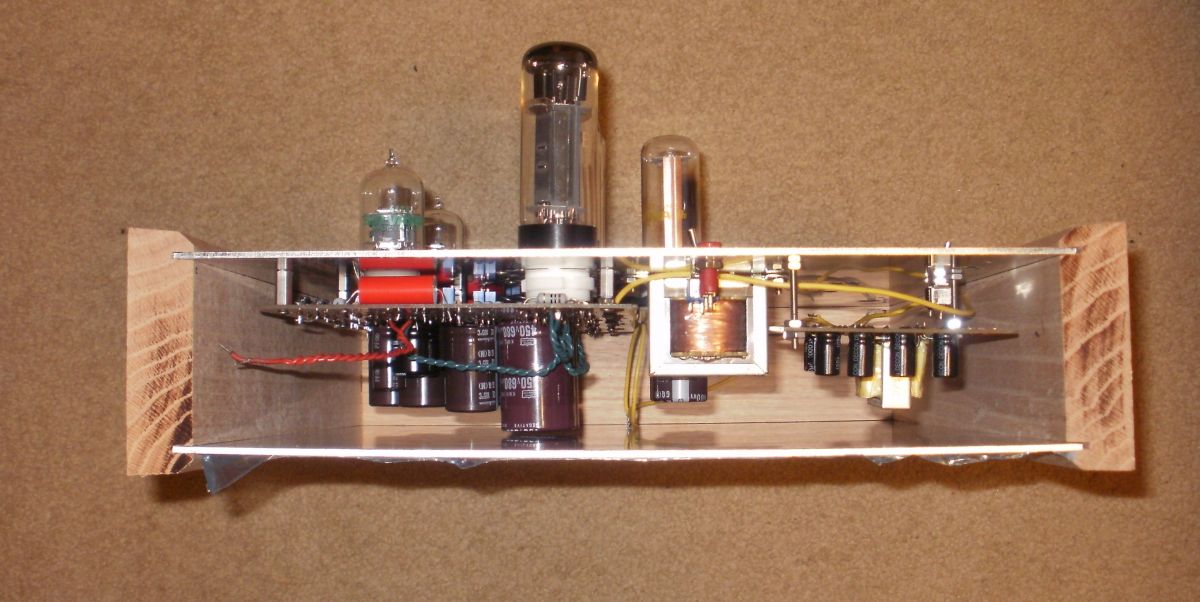

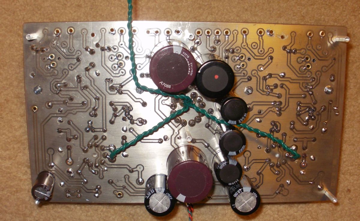

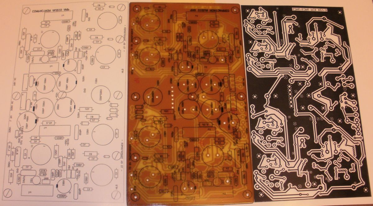

I do single side toner transfer, etched in ziploc bag, eyelets for wire connections and feedthroughts to mount caps to the copper side.
I jump to top side for all; B+, signal and ground. The back side is mostly ground plane. If going 2 layer the top would also be ground plane.
I always run the heaters as a twisted pair 3/4" from the back side. and on some, dual heater or triple heaters wire sets are used for 17V, 5V and 6.3V.
It will take me around 4 to 6hrs to get a PCB ready to drill and assemble/install the eyelets. I would like to have a real PCB double sided with heavy plated feedthroughs instead, but that takes longer and co$ts much more.

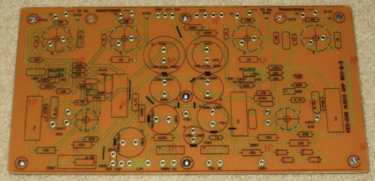

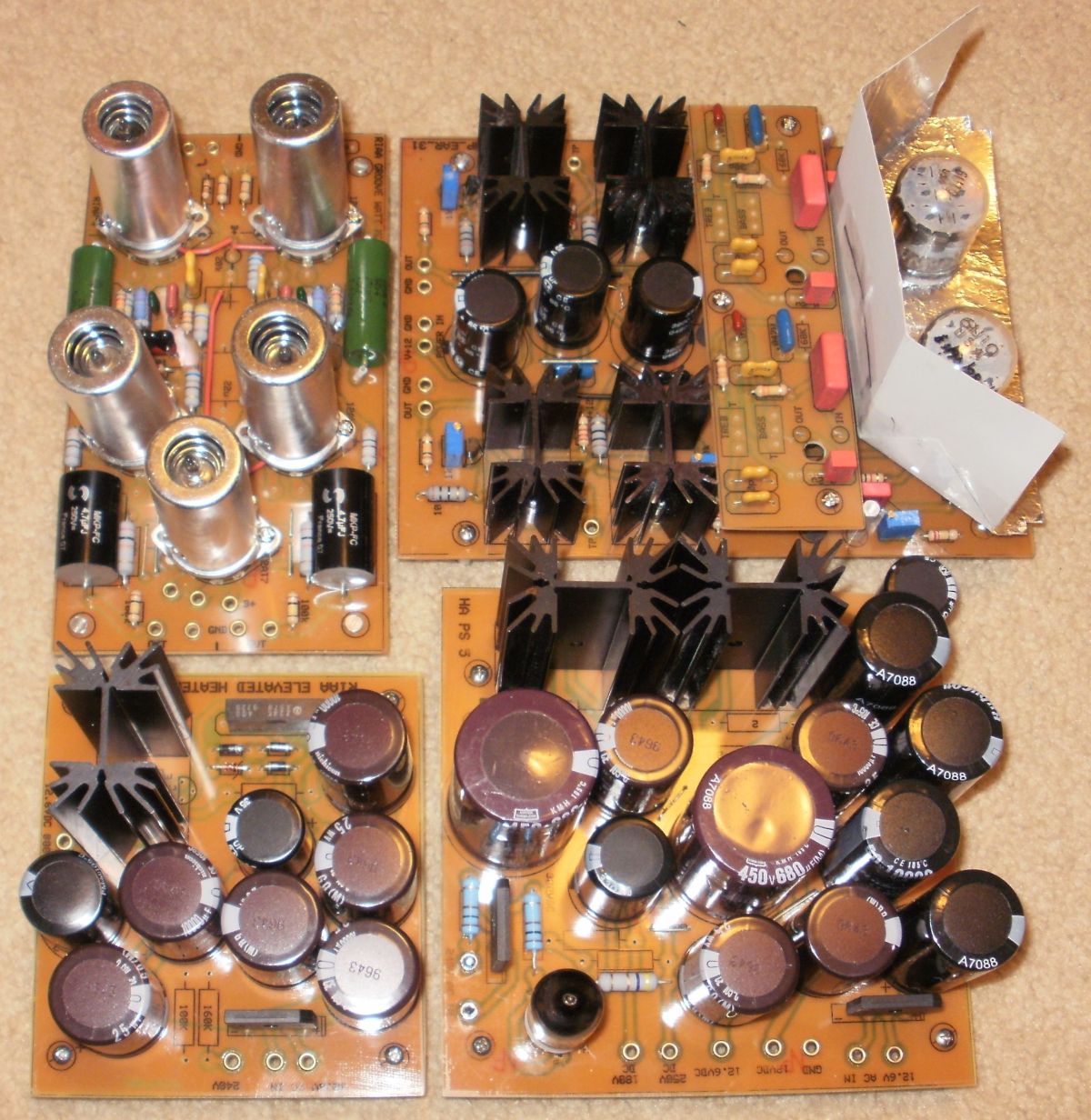

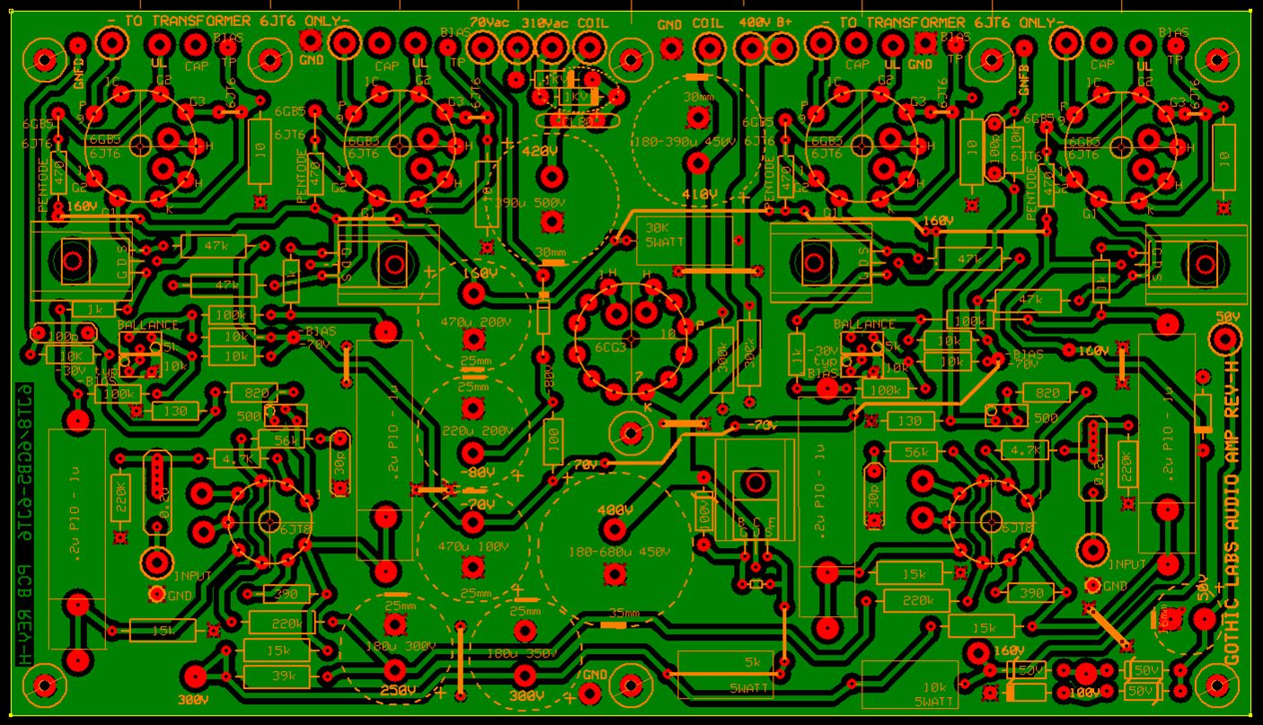

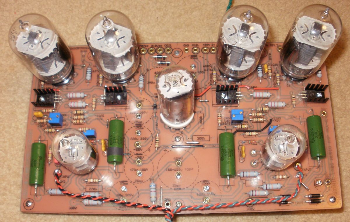

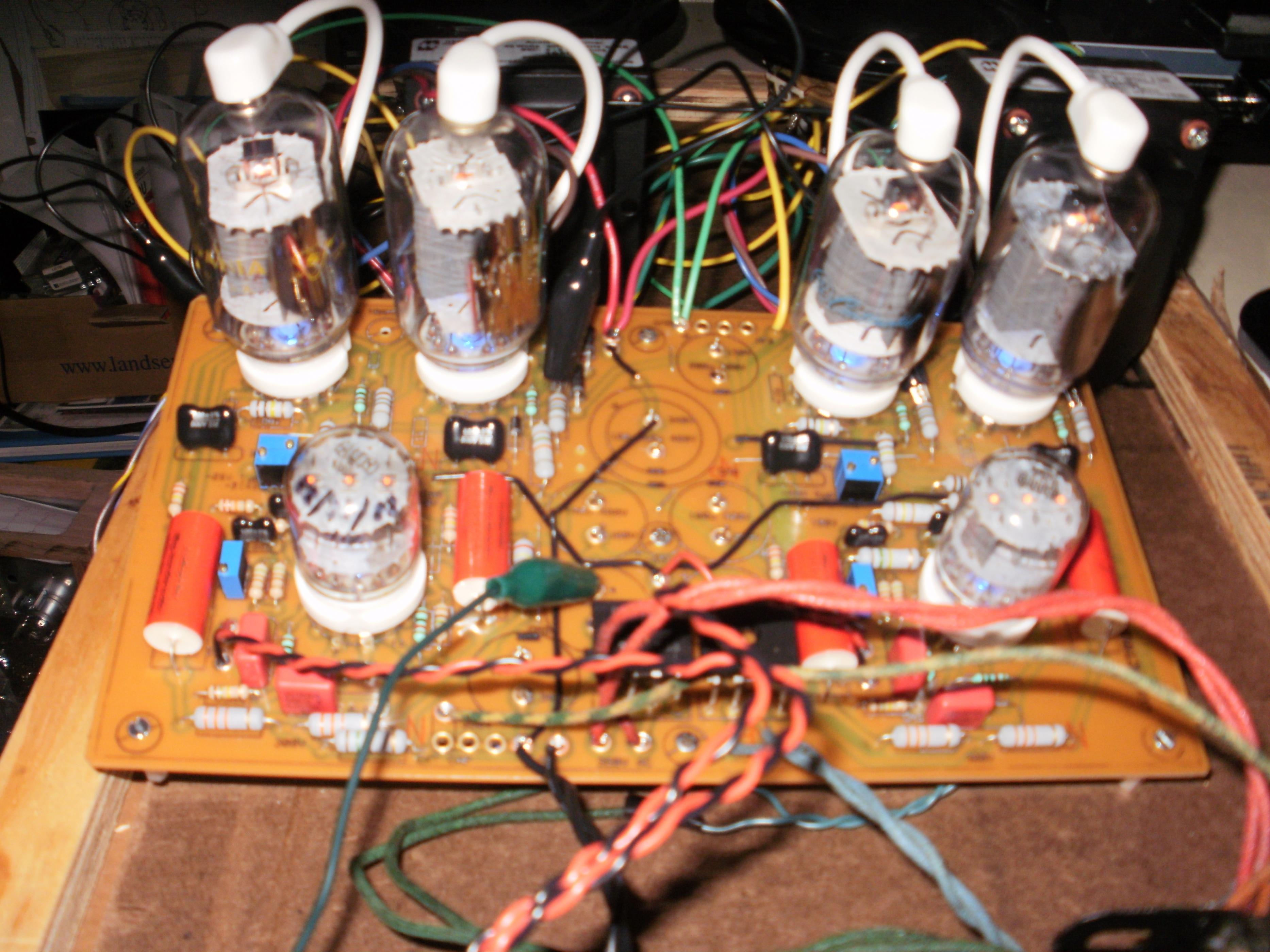

some more examples... the PCB on the left was stuffed and is the last couple of pics above.
The design was altered to add a power Zener-mosfet in place of a resistor and some of the traces were increased in width. When I use PCB express software I can design for toner transfer or real PCB design which are not the same artwork. For toner transfer I print a combo of top and back for the single back side. I use yellow silkscreen to show where the jumpers go on the top side.

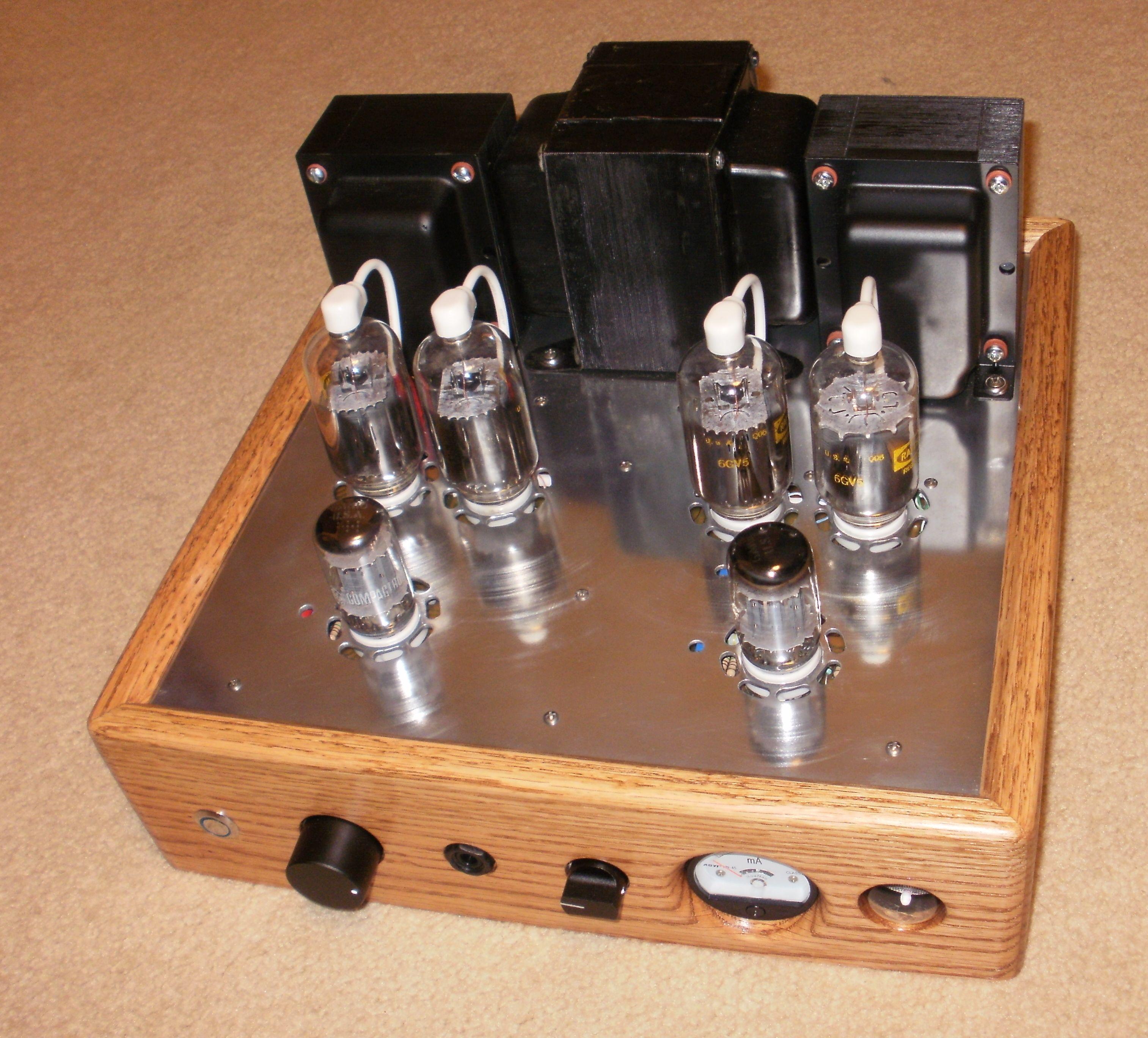

A side shot of the Keg-ear amp, the Keg-ear PCB and finished amp. ( 6L6-Kt88 family) The last pic is one of the earlier 6GV5 sweep tubes from the first couple of pics above.
and what they can turn into at the end......

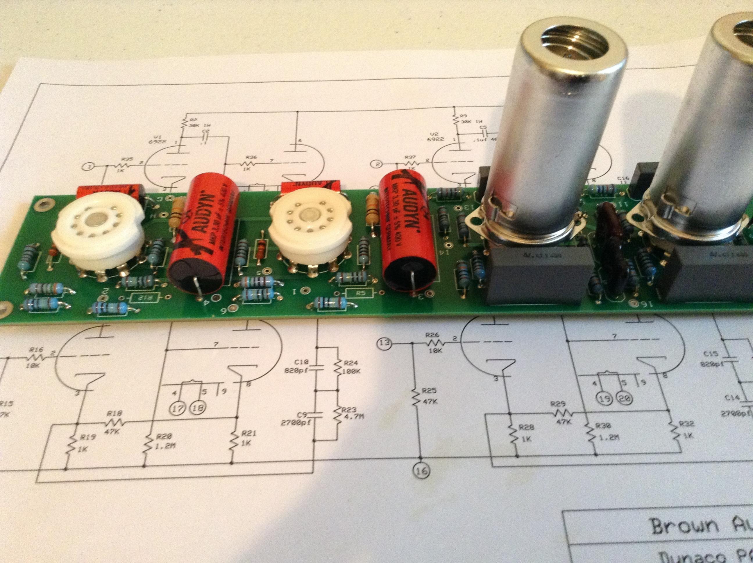

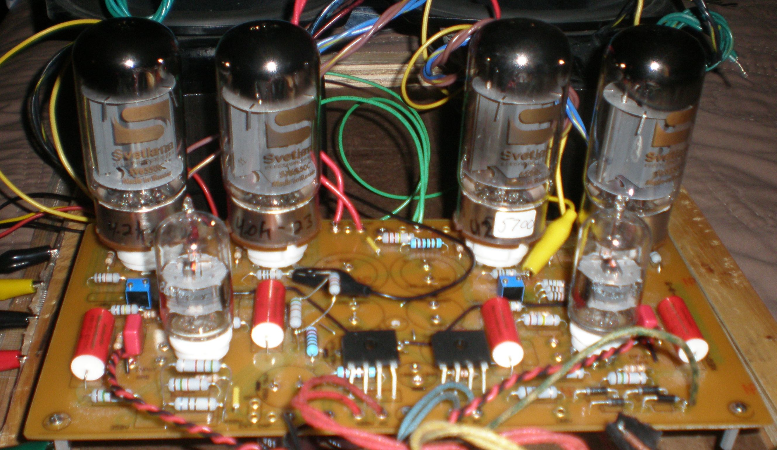

Really good recommendations so far. I have an example of a current project consisting of a phono stage and line stage preamp. You will notice the narrow layout, to accommodate a low profile enclosure. I'm using DC on the heaters,and for that I'm able to run the traces on board to minimize noise,and wiring. I've been using ExpressPCB for 2 or 3 years, they are a little pricy, but they are consistent on quality and turn around.

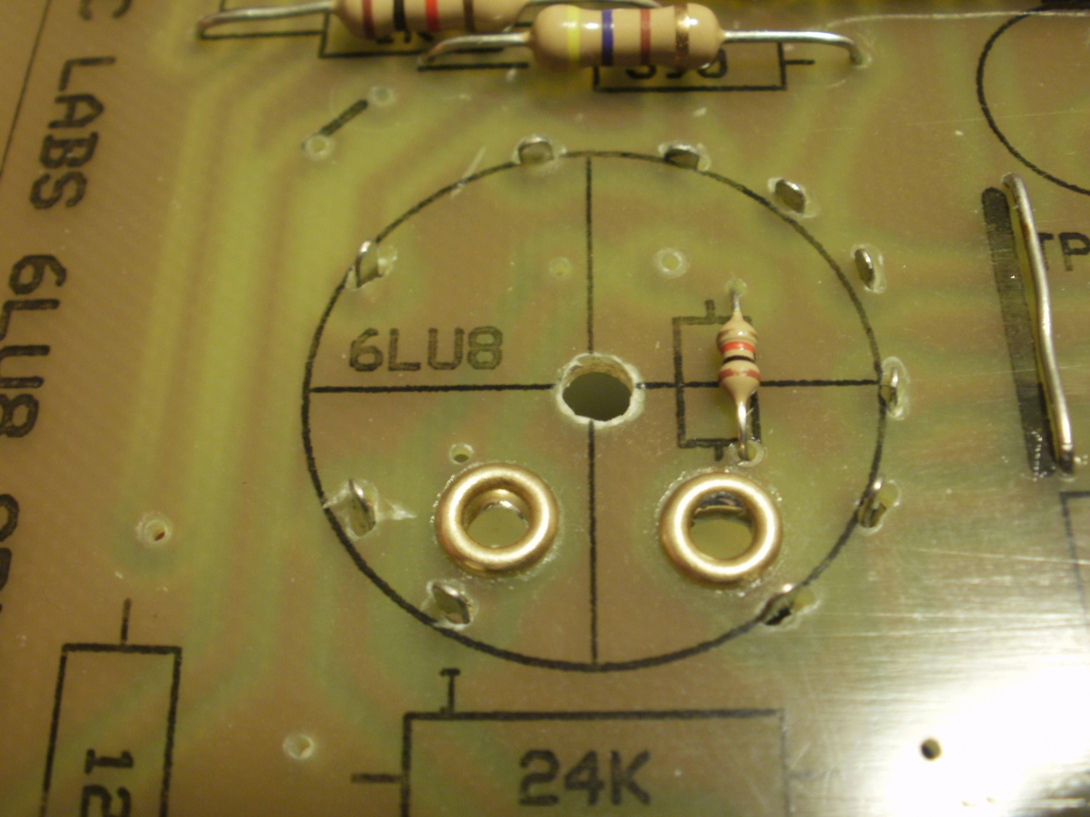

I noticed the use of eyelets. (Great photos, and some really good boards too.)
Have you seen any problems caused by differential thermal expansion between the eyelet and the rest of the PCB? I remember seeing boards using this technique back in the 70's and after a few years they would start yo get a few hairline fractures at some of the though PCB connections. They eyelets used then were probably different and the solder would have been regular tin-lead of course.
When I was involved with aerospace electronics at TRW ( TDRSS, IUS, Shuttle), the main problem that we experienced was the thermal fatigue caused by not having the proper lead form on components to allow for thermal expansion. We also had a few failures on 8 layer PCBs with the plated through holes developing cracks in the barrels causing disconnects between the layers. This was improved by allowing the through holes to be a little larger in size and thus allowing the solder to wick from bottom to top during wave soldering. The only issue with the eyelets has been not soldering them to the traces, mechanical flaring only and developing intermittent connections... I solder all eyelets to the traces and no problems.
The 6LU8 amp was done with the PCB designed upside down, traces to the top and components on the bottom. After the tube sockets were installed the leads were bent over for mechanical security and then the leads were soldered to the traces. The leads must be firmly bent over to prevent from pulling the traces off the PCB. Double sided PCB's solve this issue.
