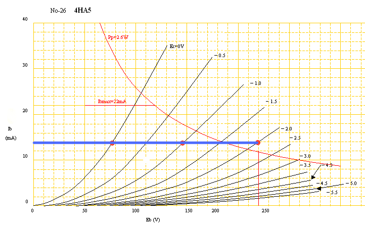

anyone got a set of anode voltage/current curves for this little beastie? Yes, I have checked what Frank has available.... Yves, I recall you have worked with this one?
Hi !
I've used that.
said to be equivalent.
Yves.
I've used that.
Yves.
exactly!
And so I figured you would have some idea of a useful operating point... or even may have developed some anode V/I curves!
ok Yves, just one more
It looks to be more linear CCS loaded at 10ma and gives plenty of swing too. What was the reason you chose the 14ma point on your RIAA pre?
Hey Down under !
Good question . . . I dunno !
Perhaps to extract the last half dB gain
Anyway, looking at the voltage level delivered by the cartridge, linearity is not the essential issue . . . I think 😎
If you plan to build this preamp, keep in mind it must dissipate a lot of calories.
Make it larger than mine
Yves.
Yves.
Is it not a 'Variable-Mu' tube...?
Looking at the datasheet it quotes a Mu of 78 at -1V g1 but much lower at higher G1 volts....
It was intended as an RF Amp for UHF Tuners, a successor of the EC97, which had similar charateristics....
RF Amp in tuners were very often Vari Mu tubes to have good AGC functions with fluctuating signals...
Yes, it is !Is it not a 'Variable-Mu' tube...?
Anyway, this is not a problem for the CCS loaded first stage at such low level.
It's a bit more objectionable for the second stage indeed . . . but not so much . . . just lightly colored 🙄
