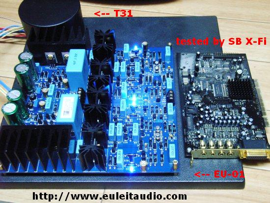

I use Creative X-Fi card and RMAA 5.5 as my-pre-amp test tools.
you can download the RMAA 5.5 software from RMAA's web
Creative Audigy 2 Z5 can run with RMAA5.3 , but I'm not sure
if it can work with V5.5 and where or how to download V5.3.

I used the PCI version of that for a couple of years. It works reasonably well, but you'll find that the drivers are awful and that the card is really good only to 16 bits. Tired of wrestling with the poor way the drivers and my test software played together, I gave up and bought an M-Audio 192. I've had better results with it.
