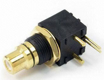

I have a few samples of a very nice phono connector that has the same footprint as a typical pc mount BNC.
I got a few samples originally from A/D Electronics (before they went out of business) and the package called them Tiffany RCA.
I also had a datasheet with detailed dimensions. It had a part number that I was able to google to find the actual manufacturer in the far east. Unfortunately, I can't find this datasheet. I did find a very similar part from First Tech Electronics P/N CN-RJ-012G. The sample I saw is mechanically equivalent but not quite as nice.
I am looking for a low cost Asian supplier since my requirements are in the 100-1000s.
Can anyone point me to a source?

I really like Ling Sing # PMP201 (rt angle) & PMP202 (straight). They are excellent quality.
http://www.lingsing.com.tw/s-1.htm
- Richard

These are exactly lke the type I was referring to. Did you buy these direct from this supplier. What were their minimums?
Thx
Al

It was a bad idea then and it's still a bad idea. RCA's should be mounted on the chassis/enclosure.

You can find the jacks of #5 at AEC Connectors Co.LTD Taiwan.
Item RJ-255PLG-TEF-M
Similar, but with metal body: RJ-203GG-TEF
