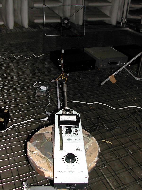

Low noise FAN and PSU for Audio PC
Hello, I'm Japanese Audio PC "WOTAKU".

And I measured these FAN noise 96kHz24bit wave file.
You can see ultrasonic FAN noise.
