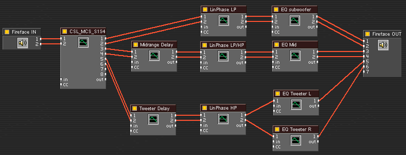

I really think im missing something. When I visualize using a FIR VST formy XO I think of inserting a module, have 2 in then from 1 to 6-10 out. Specify my XO frequencies and db filter rate etc then have it output each of those bands to the output channels.
How does this convolution stuff work compared to that? Does it use a module per driver/output? Can someone give me some sort of friendly screenshot walkthrough. I've wiki'd convolution and see how it integrates into creating an XO but it's really throwing me off as i just expect to move around different bands for a XO. I did try LinEQ but dont see how that can be a XO, does it take a module per driver??
Does this mean LinEQ would be my XO AND EQ?
If you want to do an XO and EQ solution with EQ plugins alone, you can do that. Use one stereo EQ per driver pair (one for woofer, one for midrange, one for tweeter....). You can also use one EQ per driver if you want to EQ left and right channels separately.
I would stay away from Waves LinEQ. I've used it myself, but it sound harsh. Its also troubled with severe impulse response ringing.
In CONSOLE it may look like this:
