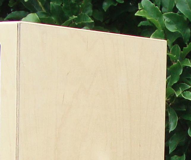

Hi Paul,
To get a nice finish it help to glue a thin MDF-plate(3mm) on the top and back to disguise the joints.
Because when it is sanded down to flat and than painted it will later show due the movement in wood. With a thin layer on top this problem can be solved. Success with your build looks nice.
Hi Paul,

I did plan on doing a 15degree chanfer that will actually hide the butt to butt joints because of that particular swelling problem but it will help if i only have to do the chamfer only for the front baffle 🙂
It easy to sand MDF only it shows later though the paint, when covert with a thin plate the problem disappears. I would sand it to have a good and easy fit.Helmuth,

I did a speaker set speakers in 2010 using baltic Brich and glued on a layer of triplex Birch as a kind of veneer. Work very good and it let sand it down fine to get a smooth fit.
In the picture the top layer and the back side are a triplex layer.

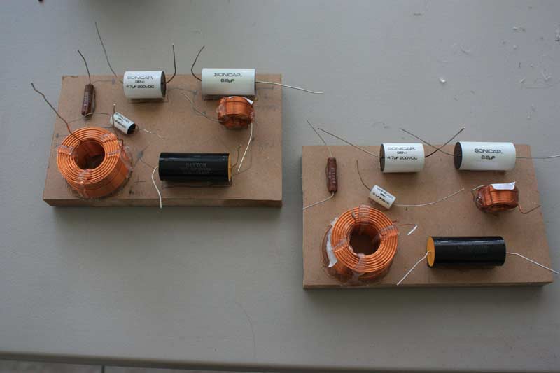

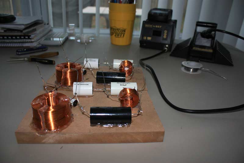

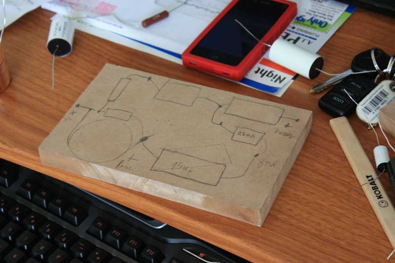

crossover update
I haven't had much time to work on the speakers around the holidays and because of another project but i got around this weekend to making the crossovers.

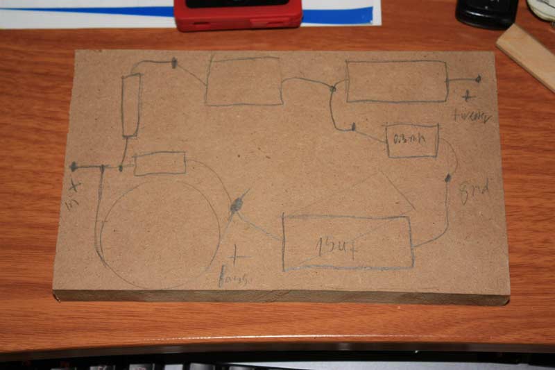

I used a piece of 3/4" MDF Woof leftovers and laid out the components in the best fashion that i can without using extra pieces of wire. I want to go directly from the binding posts to the crossovers and from the crossovers to the drivers.
O5LVt.
Here are the components glued on with a hot glue gun 🙂

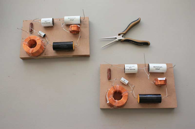

I decided to use SoniCaps for the signal path, Jentzen Inductors, Mills Reistor for the singal path and a Dayton Audio Cap for a parallel cap.

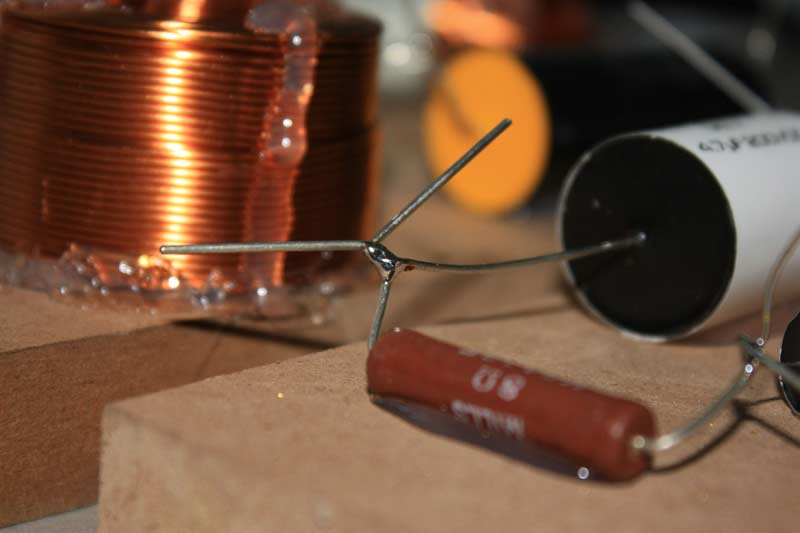

here I tied the leads by making small hooks with the pliers.
Here I soldered everything using the Aoyue 937+ Digital Soldering Station using Cardas Quad Eucetic solder set to 410deg C.
Got some nice solder Joints. The Cardas takes a bit of heating to flow real nicely but I have also used Wonder Solder and I think it took more heating but it flowed nicer.

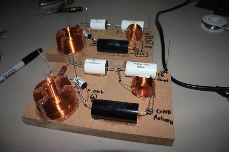

here are the complete crossovers with all of the excess wire clipped and the terminals labeled. The wire connections wont necessarily follow an order but i wont be using any additional pieces or wire and using only the leads from the components.

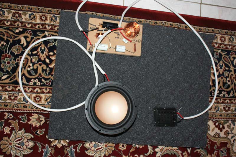

here is the dry run (no soldering) of the speakers and crossovers!!!! 😀
Both crossovers and all the speakers worked fine!!! 😀
They sounded pretty good, even though i only used low volume and one speaker hehe

Just a couple FYI...
It's 'Paul Carmody'.
Something to consider if your amp does not like the load;
The 0.1uF cap across the woofer coil can have a 4 ohm resistor added to it in series so both units are across the coil. This will minimally affect the summation, and keep your amp happier.
I think you chose the right caps for the BG. The BG can sound kinda dark, and unlively. The sonicaps are a bit forward or bright to some people, and may help balance out this issue.
Good luck!
Wolf
Good luck!
Wolf
The 0.1uF cap across.......
Wolf
