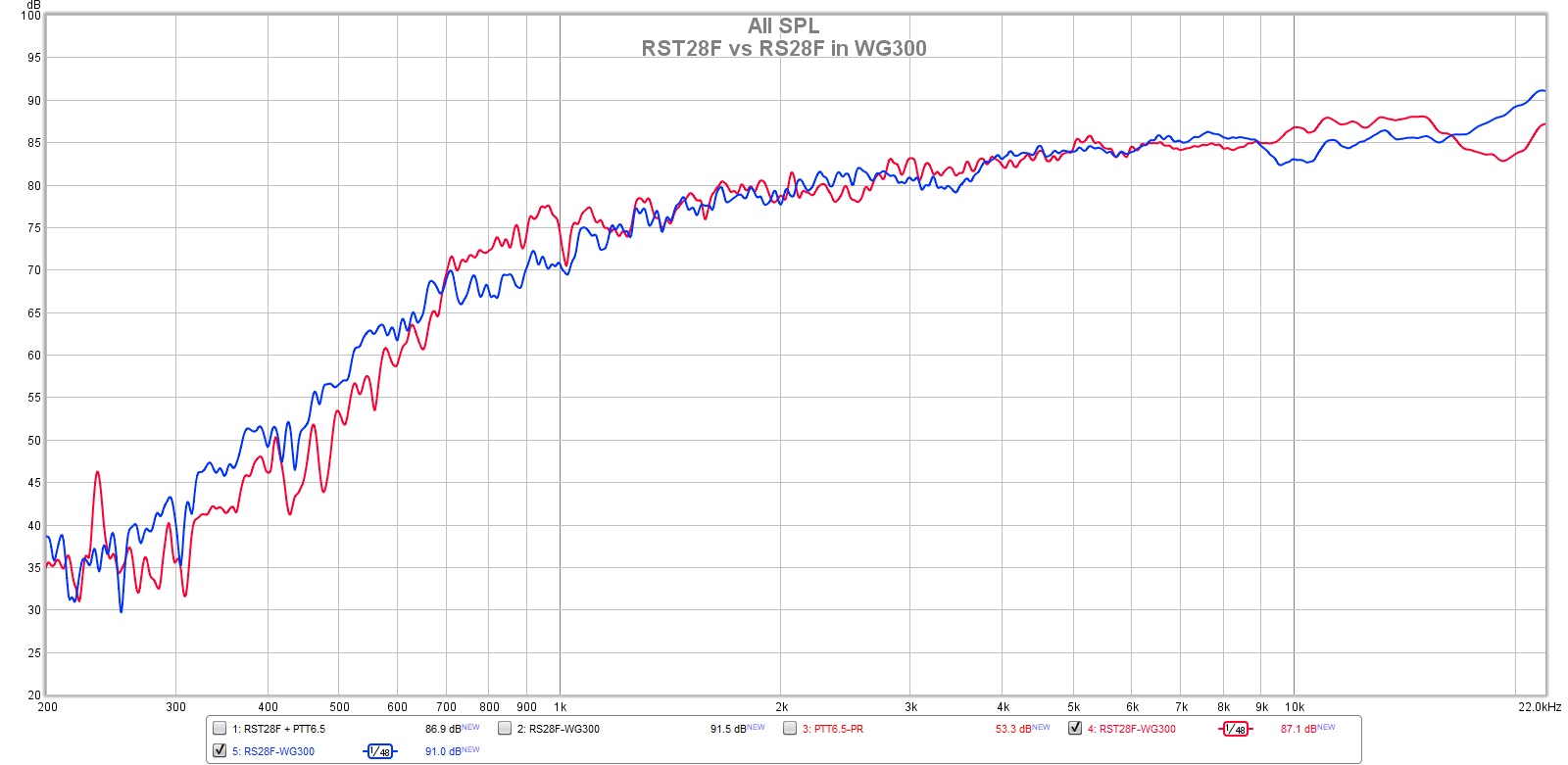

I have been using the RS225-8 for years in a 2-way FAST with a full range for a tweeter. Recently, I have been using an RS28F in a Monacor WG300 waveguide with a Purifi PTT6.5 TL speaker with great success. Since I already have FRD and ZMA files handy for these drivers I wondered how well the combo of the RS225-8 and the RS28F in a WG300 would work out together. A very quick simulation in Xsim seemed to yield pretty good results. Although the RS28F is no longer available, I have tested the RST28F in the same waveguide and it measures very close - allowing for similar performance. The crossover is based on the assumption of a certain acoustical delay which I have not been able to measure yet, but estimated based on the positions of the voice coils on a baffle and the depth of the waveguide. The crossover I came up with is strange in that it has a deep notch if invert the polarity of the tweeter and sums up fine if left normal. Not sure why this is.

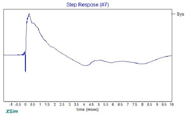

Predicted step response showing great time alignment:
877087d1600538772-10f-8424-rs225-8-fast-waw-ref-monitor-rs28f-wg300-rs225-xo-1-5khz-step-jpg

Why do you think that the notch on polarity flip is strange? The better aligned the waves, the deeper the notch(more perfectly out of phase) on reversal of one of the drivers.
An old check on phase in the xo region.
It means you guessed the offset well.
With that and similar areas coupling to the room with 8" & 7" your only concern might be running out of tweeter excursion at higher volume.
Should be fine with the TL version where the RS runs out of xmax a few db earlier, 'cause going lower.

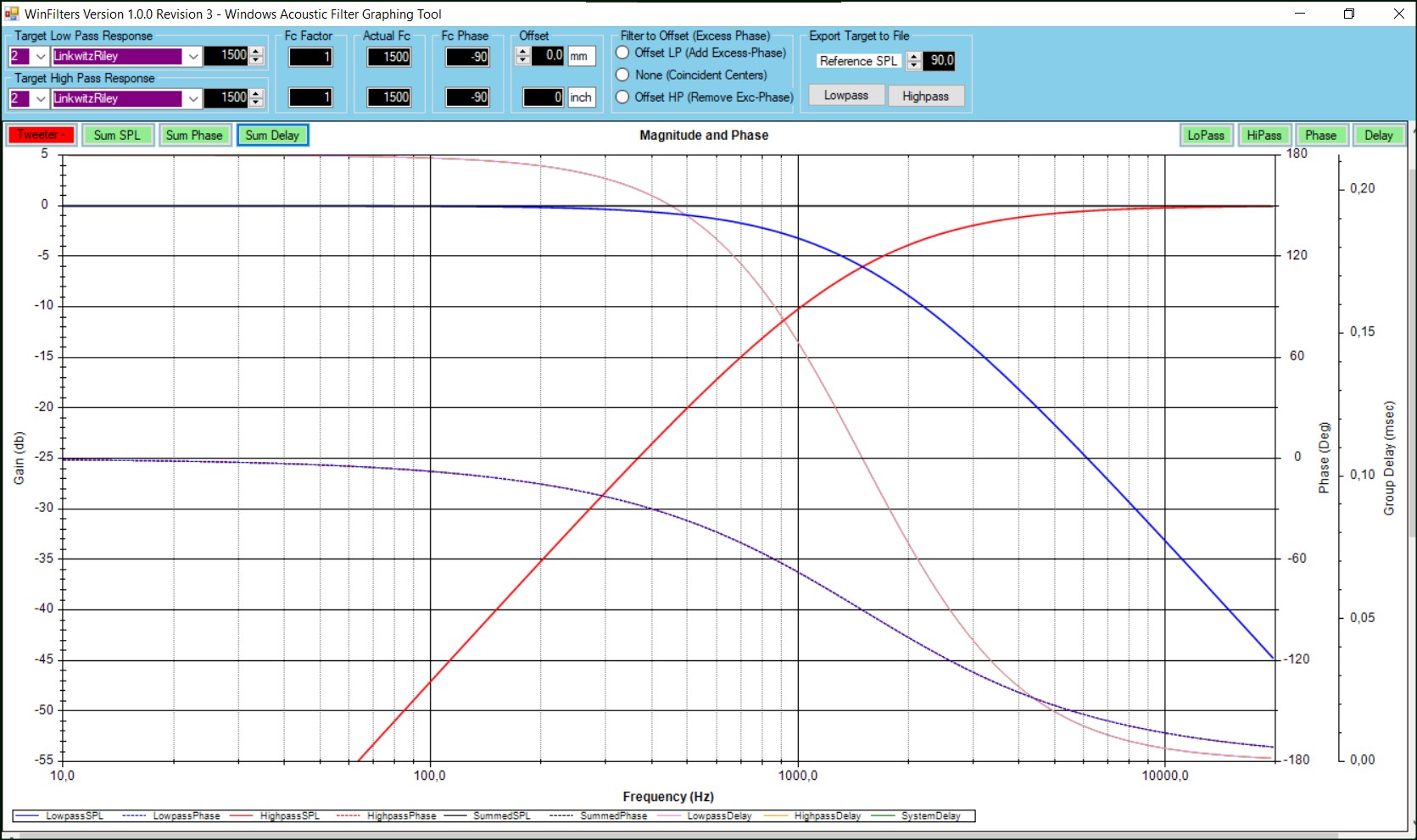

1) straight crossover electrical filter
2) crossover electrical filter + drivers actual impedance = total system electrical response
3) crossover electrical filter + drivers actual impedance + driver acoustical response + time alignment relationship of drivers = total acoustical response at microphone
A crossover filter shifts 45 degrees per order at the crossover frequency. A crossover filter has separate high pass and a low pass filters.
For a 2nd order hi/low pass crossover, that's 2 x 45 degrees for the tweeter crossover in one phase direction, and 2 x 45 degrees for the woofer in the other phase direction, for a total of 180 degrees between the two outputs.
The difference in travel time from each driver to the measuring microphone need to be addressed.
An estimate is from the front of the drivers voice coil to the microphone, but acoustical measurements are best.
At a temperature of 72F degrees, the speed of sound is 13560 in/sec (1130 ft/sec).
At a crossover frequency of 1.5 kHz, some phase and distance relationships are listed:
1 wave length Phase 360 degrees = 9.04 inches
1/2 wave length Phase 180 degrees = 4.52 inches
1/4 wave length Phase 90 degrees = 2.26 inches
1/8 wave length Phase 45 degrees = 1.13 inches
Or every 1/4" = 10 degrees phase at 1.5 kHz

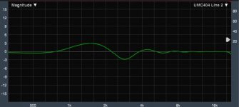

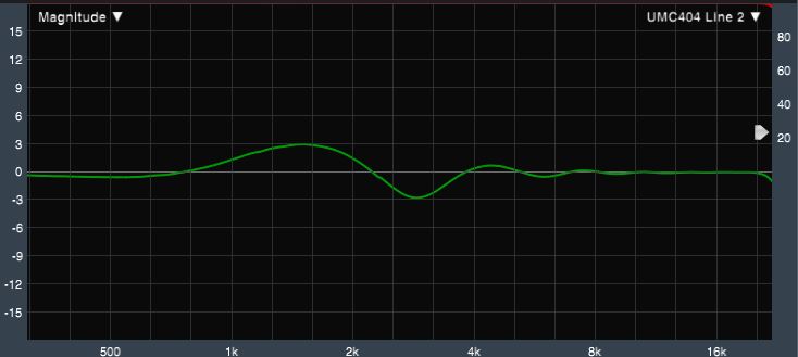

Below is the electrical summation from 2nd order, 1500Hz 1/2 period off.
As you can see, entirely possible it might get lost in acoustical measurements.
But 1/2 period is 0.33ms, or about 4.5"...which is alot of distance .....
So I dunno, but something does seem off.....

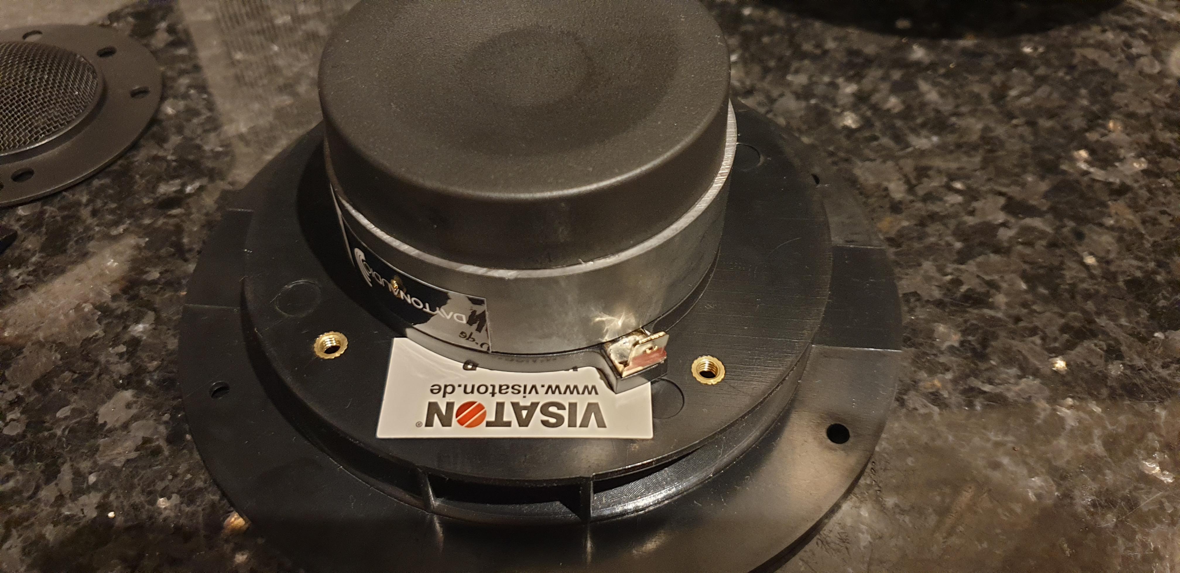

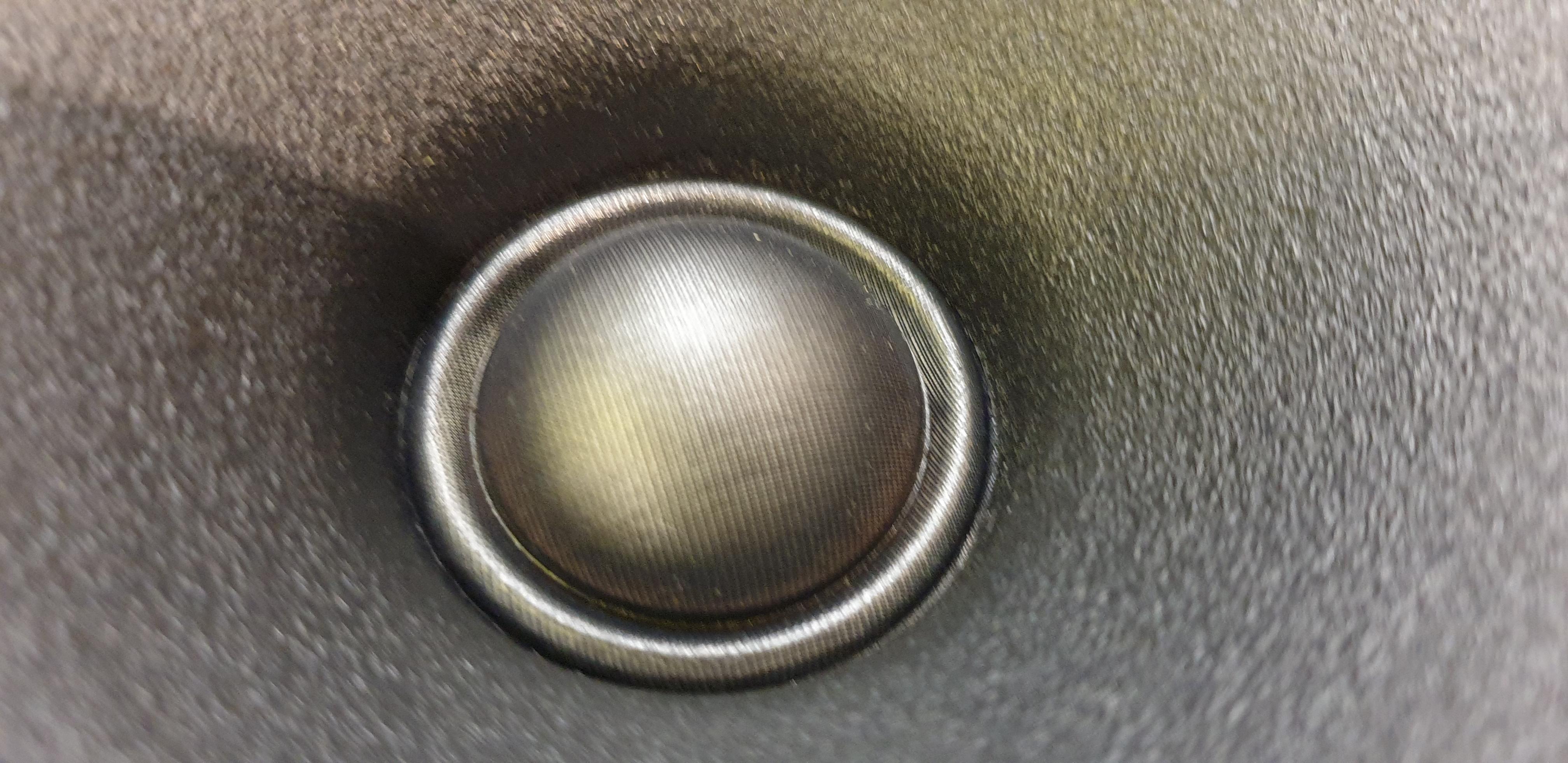

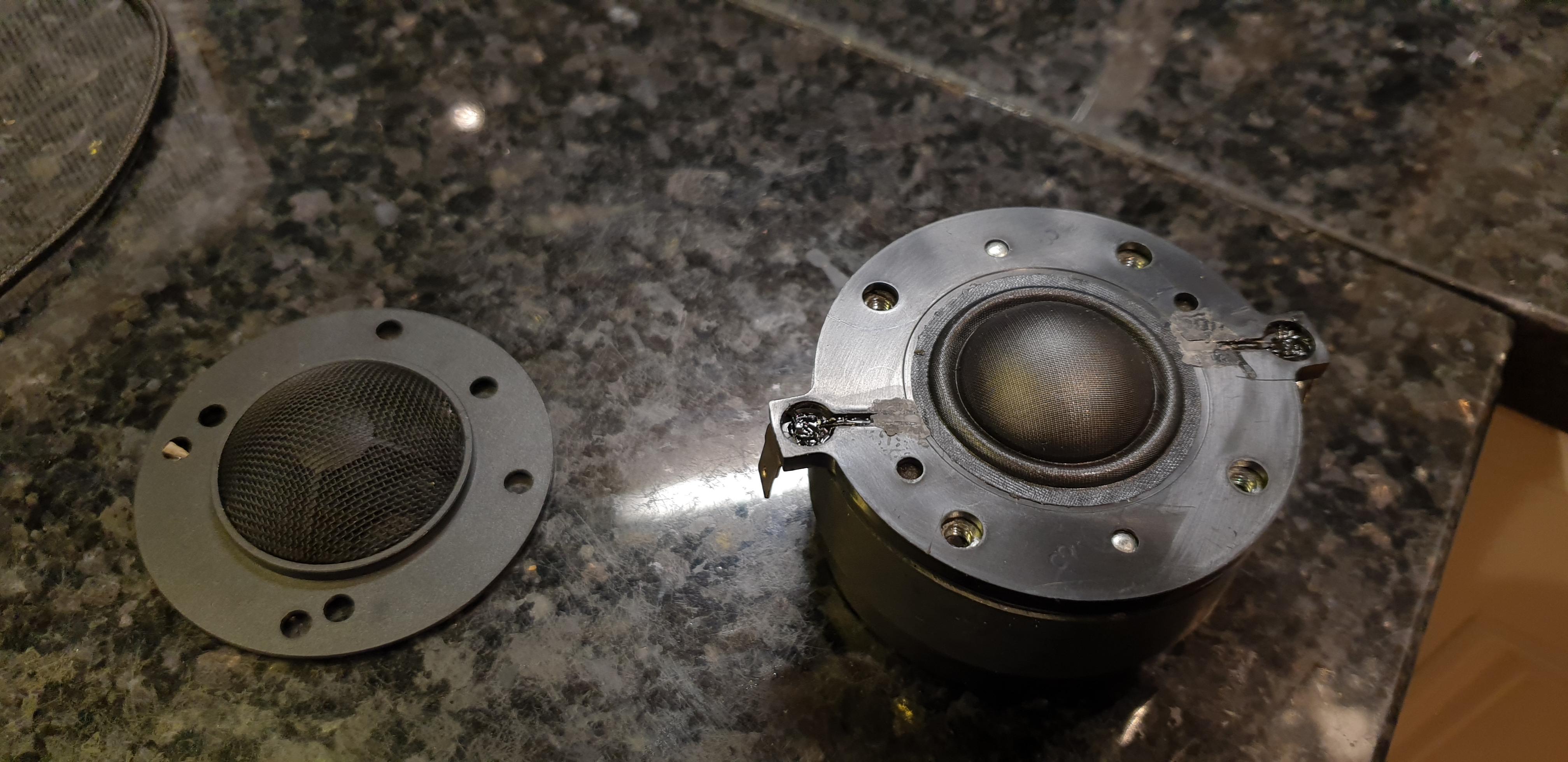

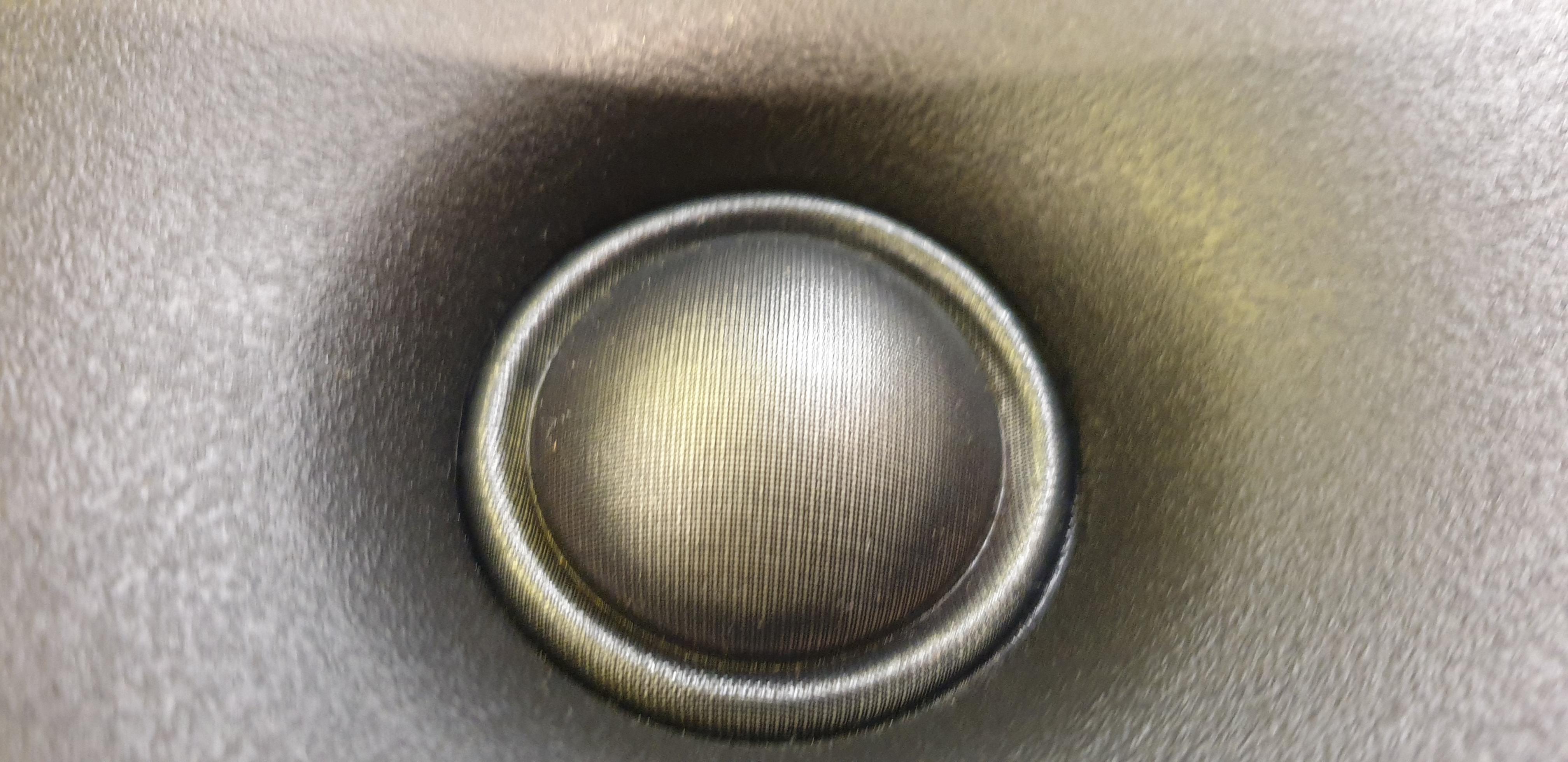

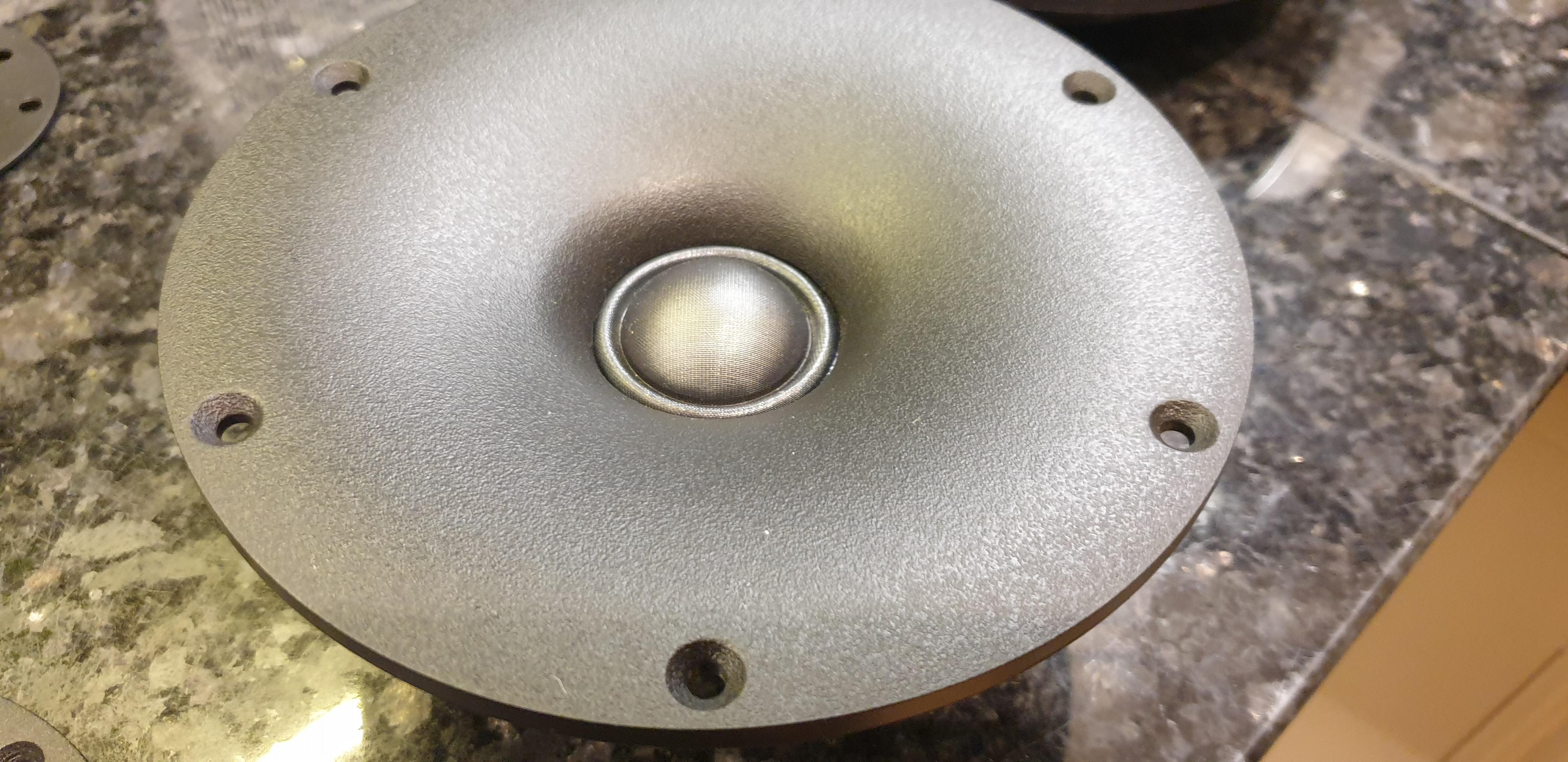

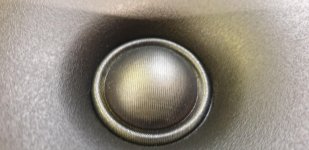

A few photos to share. I saw pictures here mourning the RST28F to the WG along with the tweeters face plate
. Having read a thread on the PE forum I learned that thr grille will come off too. Once you realise it has a plastic surround it makes sense how to remove it. Then it offers up to both WG300 and WG148r very nicely. It would pretty much just mount to the 148 with double sided foam tape alone.
1st 2 photos are the WG300
Last 3 are the 148r
Sorry for the lack of clarity in the pics

Hi Jim,
Neat work! I missed this, so how does it sound simply double sided tape on? One possible issue is that it needs to be a pressure tight seal to keep the rear chamber of the main woofer box from leaking past the waveguide to tweeter interface. Also, don’t you need the faceplate to keep the dome and voice coil from coming out?
Hi X. No listening or measuring yet I'm afraid. I seem to be going round in circles trying to decide on a what direction to take with my speaker projects! I do feel for me a tweeter will be better for me and my room than a small FR driver. I think the dispersion helps the imaging and soundstage. I may be completely wrong though! Will the WG help the dispersion. ? I get confused whether it is focusing the sound to a point more , or spreading it.
And sorry I didn't answer your questions. The face plate carrying the terminals would remain. The dome is glued down though IIRC. Fair comment on leakage. Yes that would need to be certainly air tight. Thanks for the heads up on that.
Saw this and had to comment, be it too late. You removed the protection grille of the tweeter. Did you notice the phase correcting shield underneath the grid? That was there for a good reason: flattening the top end response. Removing it results likely in a rough ride above 10kHz. Luckily most of us are quite deaf in that range, but I guessed you better should know...
