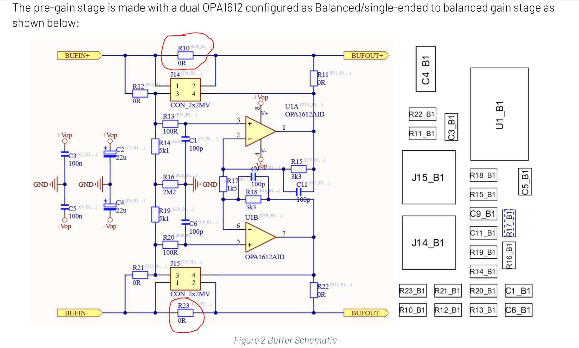

Just as an option... You could replace the 0-ohm resistors (0dB gain setting) with something like 500-1000 ohm resistors (tune the values to ensure there's no danger to your speakers in the event of an accidental "full blast" scenario). Just keep J14 and J15 "open", i.e. remove all shunts.
