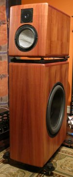

I am building a 3-way. The midrange will be the Accuton C158-8-085.
I notice that the frequency response is a little down below 500Hz.
Would a passive radiator help?.

Vas is pretty big for a 5" midrange, with 35liter
how did you calculate it ?
crossover ?

its calculated like vented BR port
you are not using vented BR midrange, are you ?

but that impressive looking speaker you have there is not a 3way
or at least not in common sense
it is '3way', sure ... but basicly more like a 2way with sub woofer

Tinitus and AllenB, thank you for your response'.
I will be building a second pair for the cottage.
The woofer is DSP controlled, with a 1500 watt plate amp. The midrange uses a notch to lower the bottom octave's. I found this to sound better than to put a cap in the signal path.
If I build a pair for the cottage, I can always face the woofer forward, and cross higher.
Any thoughts on the sound quality of a passive radiator system for the mids vs. my sealed version?.

I can't see it sounding better than a closed box, or necessarily easier to work with, to design or to implement. Just my opinion. Anyway, since this low end is being discarded by the crossover it won't be the dominant effect, the filter will.
By the way, how do you notch the low end without source impedance or a capacitor in the signal path, do you use a current amplifier?

AllenB, yes I use a current amplifier. It is the Atma-Sphere MA-1. It has an output impedance of 2.3 Ohms.
When I was designing the speakers, I worked on the mid to tweeter filter first. Once this was finished, we listened for a few weeks. It was amazing, though I have always preferred a 2-way over a 3-way. When I started adding caps to cross to the woofer, every variation, be it in value or manufacturer, caused a loss of midrange clarity. It was at that point I thought, try a notch. I had a 12mH inductor on hand, did some calculation, and voila, it worked.
The natural roll-off of the midrange (9 liter volume), the notch, and the fact that the slope of the woofer was tweaked with the DSP (digital sound processor), made the cross from woofer to mids quite easy.
I just had a thought. Most of my store bought speakers have been ported. Maybe I only perceive there is a lightness below 500Hz. When I measure, it's about 1dB down. Would I be able to hear this slight drop?, or do I just remember the ported sound?.

1dB may not seem to do much on some systems but when a system is good, it can make a fair difference. The octave below 500Hz is quite important for feeling the weight of certain sources such as voices.
It looks as if this region may be crossing the 'baffle step' though and this can complicate matters as you'd need to go through it in the time domain and at various angles to make sure what you see is what you hear.
As you get it balanced above and below 500Hz the speakers may sound a little more dull, but press on and get it right and you'll probably want to keep it that way.
By the way, have you thought about a first order shunt highpass filter?

since you know how to handle a DSP ...
why not ad another woofer, and try real 3way
with the sub crossed lower
or do real 3way, and use EQ to get the woofer down
it might not be so good for loud SPL, and strugle with the EQ
but that's just a choice

Passive radiators work at low frequencies. As a speaker engineer, to be honest I cannot directly say why it wouldn't work, but a lot of intuition alarm bells ring in my mind. I have only ever seen Electro-Voice implement a vented mid-range...a passive radiator would be a whole other layer of difficulties. Plus your rolloff will be so much faster, and excursion at low frequencies uncontrolled...you'd have to totally rework your crossover. My educated guess is you will do a lot of work and suffer for not great results.
I might suggest instead a small passive shelf filter for the upper section? Like a 1-2 dB step just with a couple of resistors and a capacitor.

Thanks guys.
Looks like a shelf for the 500 Hz + region is going to work. First few listens aren't bad.

PR's don't do midrange. Baffle step can be addressed by
a passive filter pre power amp and is a lot more than 1dB.
In a 3 way the slope of the bass can be manipulated to
provide the BSC for the mid unit. Seems to me there
is a fair amount of waffle and no hard details here.
rgds, sreten.

no, it won't
but if the problem is too early rolloff in closed box, 'porting' might help
could be like rolling off closer to 100hz, instead of 200hz

The natural roll-off of the midrange (9 liter volume)...
with closed 9liter calculation does in fact show a very nice smooth rolloff at 100hz
not something I would consider for a final design
but you could still try in the one you have playing
stuffing with closed cell foam might do it
I still suspect your worst problem right now might come from a phase problem

Please help. Where would my phase problem come from?.
I am using a first order crossover, with a notch to help the low end roll-off.
