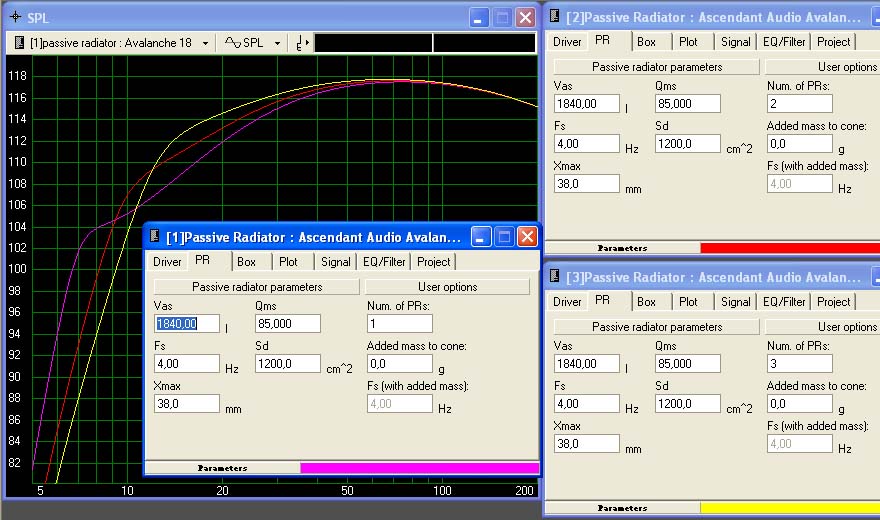

I tested it in WinISD, and for an unknown reason, John is right.
I guess there's something behind that, probably not totally connected to displacement, but when you give more displacement, the frequency response curve looks much much better.
I used an Ascendant Audio Avalanche 18", to get a good FR curve I used three 18" PRs with 38 mm Xmax.

If you look at the excursion curves, it is quite obvious that you need more displacement for a PR than for the driver. 2X is usually fairly safe, but it really depends on the alignment.
In terms of FR shape, if you add more PR's, you need to add a lot more mass (typically) and this drives the PR Null (at the PR free air resonance) down in frequency - which will change the shape of the stop band. If WinISD predicts response shape changes other than the shift in the null, you may have found a bug. 😉 If so, it won't be the last in that program 😉

Can you tell me if the FR showed by WinISD seems to be right?
Ascendant Audio Avalanche 18" in a 500 liters box
Stryke Audio 18" PR
FS 4hz
Mms 1600 grams
Qms 85
SD 1200cm^2
Vd 9L
Vas 1840L
Xmax 76mm p-p

I can't run the numbers right now, but it looks as if I don't have to. It appears the PR is too heavy unless you have multiples. You could use oneor two PR's, but you would need to subtract weight to get the yellow curve.
The tuning frequency of the box is Fb=Fp*sqrt((N*Vap)/Vb-1), where N is the number of passive radiators, Fp is the PR free-air resonance and Vap is the individual PR "Vas".
You can see that the tuning frequency rises as more PR's are added . In your case you needed multiples to get the proper tuning.
