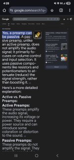

" By what authority?" Physics.
Reactions: ejp
Not gonna argue with you. Everything is against you, even 'physics'.
